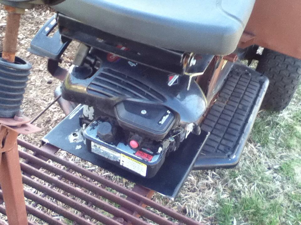

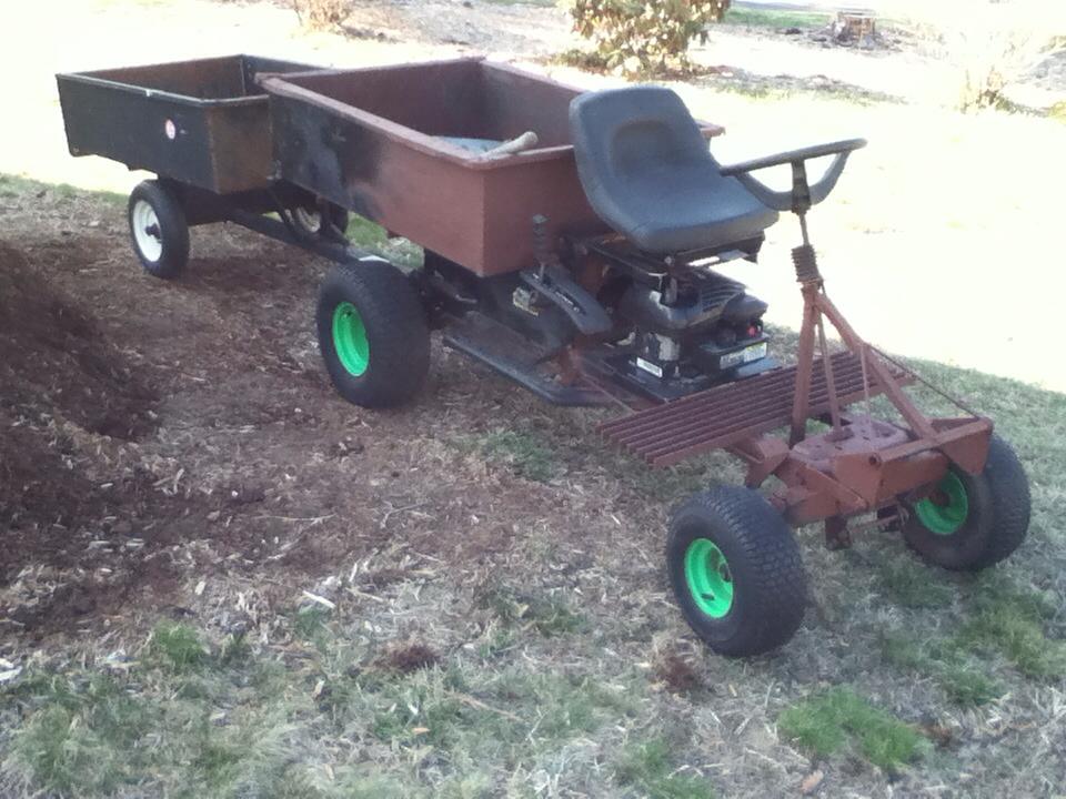

My little buggy above was made for carting mulch around, which it does OK. I think that's a 6hp, I'd have to go look to be sure, and it runs a gear transaxle. Because the rider's weight is no longer over the front wheels, the chassis is also full of bricks (really only needed when empty).
It's gutless with dirt in it, so if you are looking to move more weight around or support the power losses of hydrostatic you'd want to upsize to the next size block, the 8hp or so from a rear engine rider. I was looking for fuel economy and something that would run on a pull start with no battery to maintain for as little as it gets used. For my needs, the little 6 does OK. Some of those 8-10hp rear engine mowers came with a pull start too, if that idea appeals to you...and the bolt pattern and output shaft will usually match what you already have.
