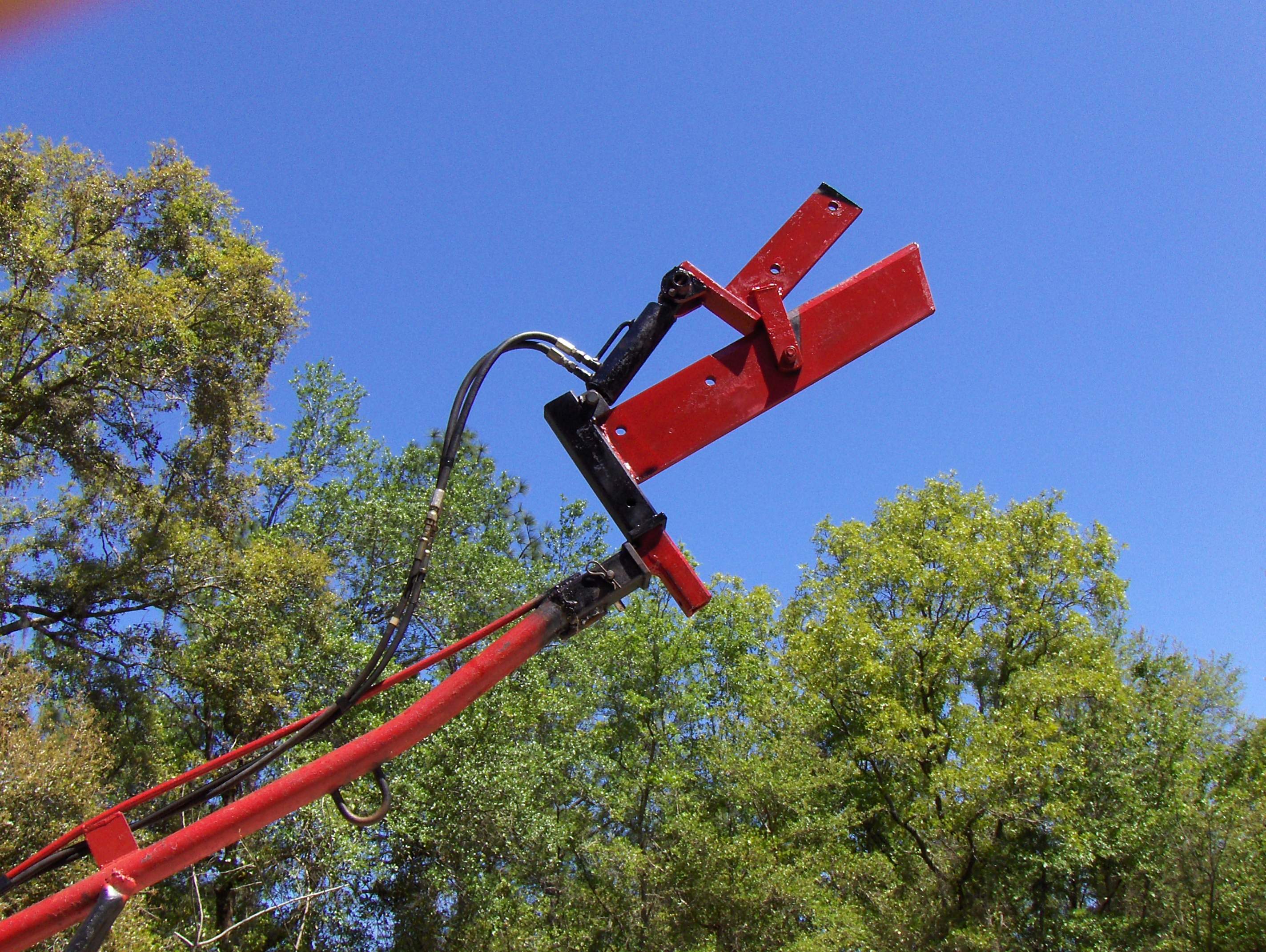

A long time ago, I fantasized about building a boom-mounted chainsaw to connect
to my loader. This would allow me to trim branches off trees from the seat of
my tractor. The loader can already reach more than 8 feet high, and the
boom I pictured would add maybe another 8-10 feet.
Kinda like this:
LIMBHOG Details
or this:
LimbSaws by Priefert | Home

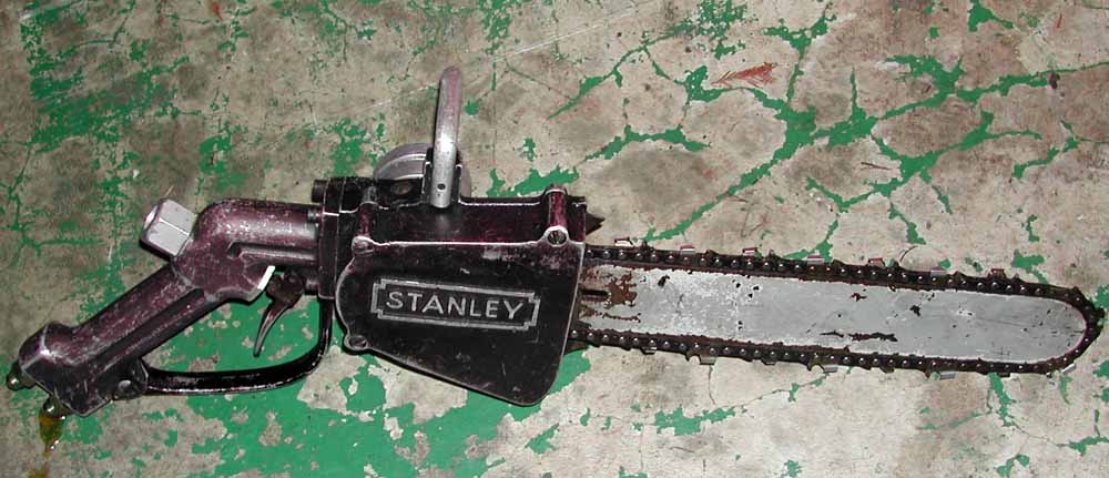

I was suggesting using a modified older cheaper unit like this:
   / powering a hydraulic chainsaw off your tractor's hydraulic system
#2
dfkrug;3337579 I was suggesting using a modified older cheaper unit like this:[/QUOTE said:
Well, "this" is a Stanley saw, built shortly after they acquired Ackley Hydraulics, a
pioneer in hyd saws. Purchased on eBay for under $200, I quickly discovered
that it used closed center hydraulics, and specs limited it to 2000 psi. 5GPM flow
was just about right.
Apparently early hydraulic power supplies for hyd saws were closed center, while
later ones were open center. Newer saws came with a control valve that let you
opt for either one. I suspect that newer bucket trucks owned by utilty companies
use OC, and manufacturers want to stay compatible with older CC power supplies.
After cleaning it up and adapting to JIC fittings, I tested the saw using my tractor's
AUX circuit. It worked fine, but releasing the trigger control forces the implement
pump to send all flow thru the tractor relief valve. These saws do not have their own
RV, so I was very careful not to bog the saw down. My tractor puts out 2500psi.
You can perform this kind of wet test (briefly!) on CC hyd devices if you are careful.

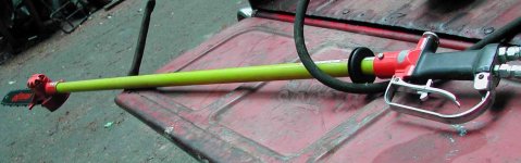

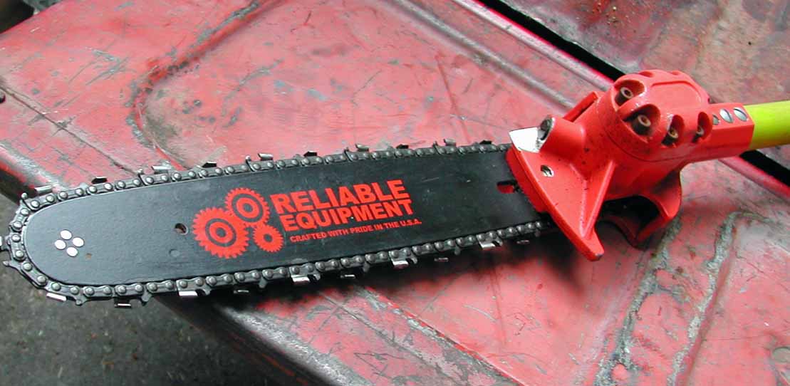

Next up were these two modern saws, both unused, and also purchased off of eBay:
First is a Reliable polesaw, commonly used by utility companies everywhere.
Both of these saws run way north of $1000 new, but you can get them for $500-600
in this condition, if you are patient. Our utility prob pays over $2000 for the Reliable;
they can just pass the cost on to ratepayers.

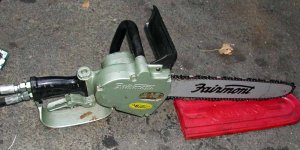

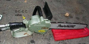

Next up is probably the most common hydraulic saw out there, a Fairmont, which is now
part of Greenlee. Similar cost to the Reliable, new or used. Acquired on eBay.
This saw, like the Reliable above, is limited by the manufacturer to 2000psi, but has no
relief valve. All 3 saws run at an optimum flow of 5GPM.
I should also mention that both of the newer saws have a small valve to allow a certain
amount of hyd oil leakage to lubricate the bar/chain. It works quite well.

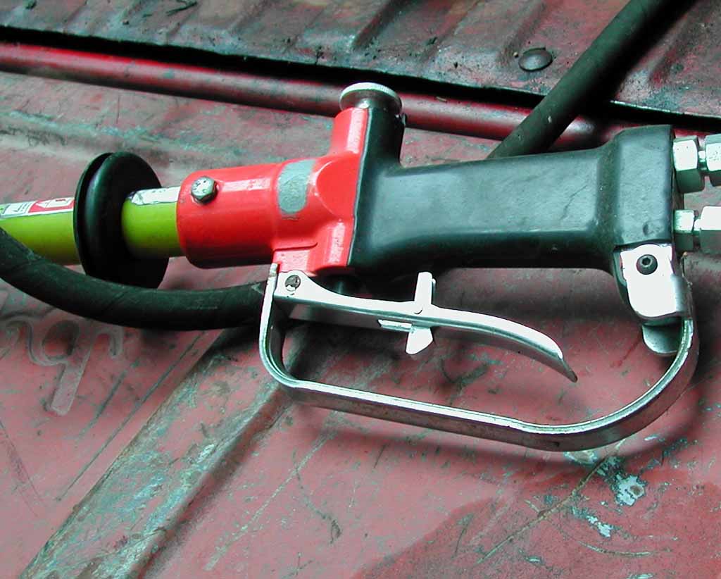

Here is the valve you turn to go from OC to CC. OC is the factory setting, implying most
power sources are open center.
Note that the trigger valves on all 3 saws are not "motor-spool" valves; flow to both sides
of the motor is shut off when the valves are released. Since there is no significant momentum
in the chain moving at full speed, a motor-spool is not necessary (OC). Top speed for the chains,
BTW, is considerably slower than on a gas chainsaw. You can also start the cut with the chain
stopped, but already pushed into the wood. Enormous torque is available as soon as you
pull the trigger.
This also means that there is no need for a chain brake. The chain stops very quickly.

It looks like the limbsaw/limbhog has built in break-away in case the saw hangs up as the branch falls? they sure are $$$$
the branch falls?
They must have some sort of hinge on the boom so that they do not put too much weight
on the chain and bar. I would make a pivot as close to the end as possible.
