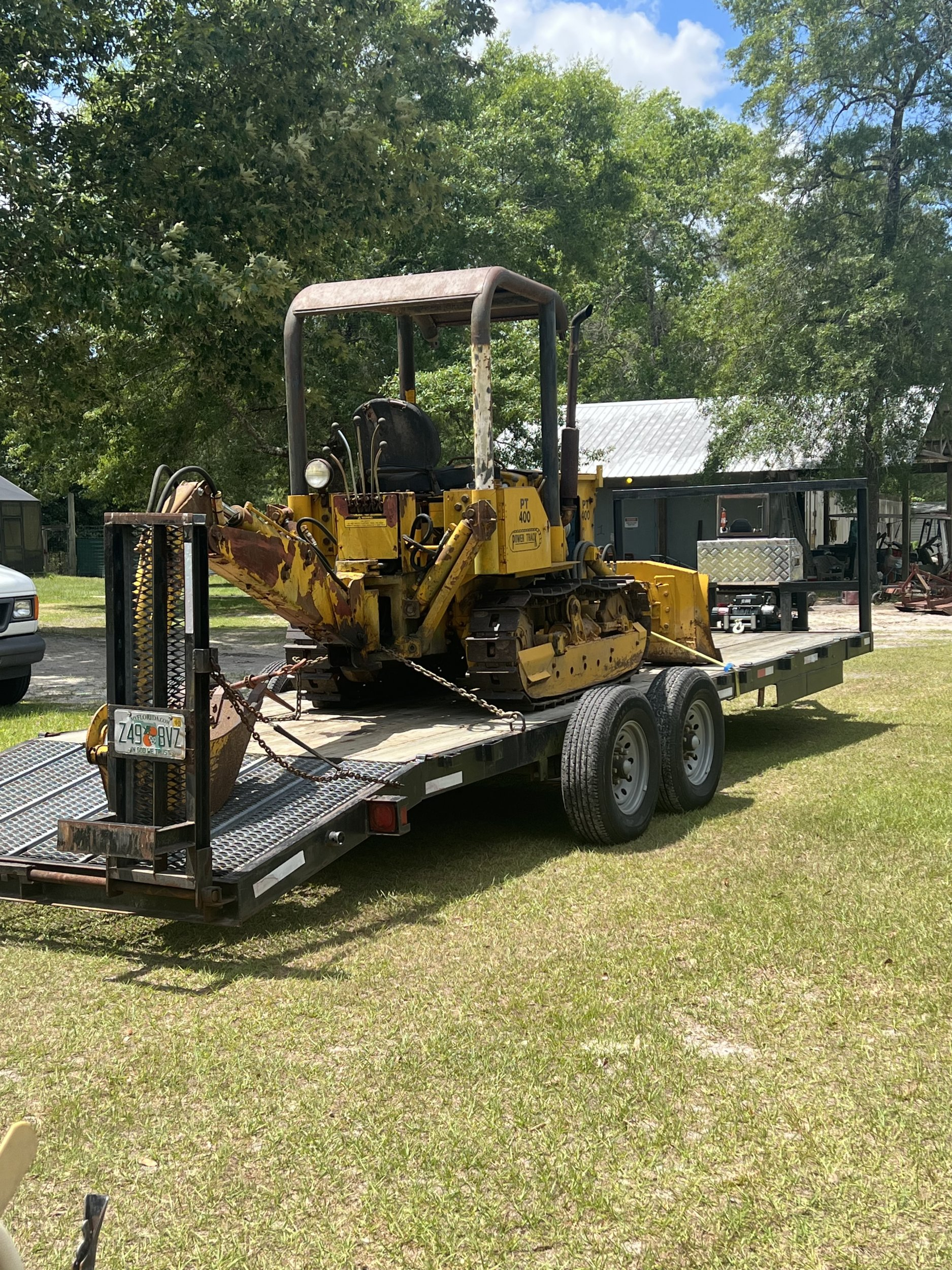

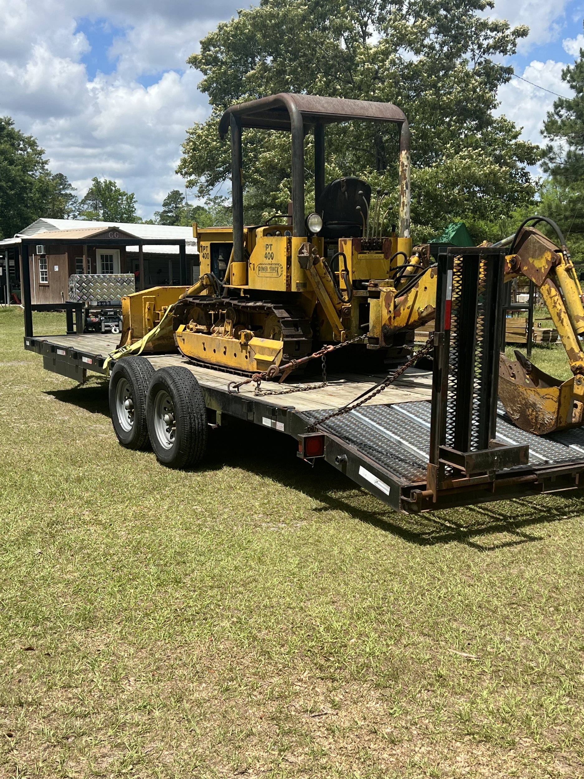

New to the forum. Just picked up this unit. Shuttle shift left side. Has backhoe attachment. Both left and right brakes hold. Left track will spin machine when pulling right lever. Pull left lever machine stops. Right sprocket appears to have no drive. Could it be in the linkage? Sat a couple years then previous owner got it said no power to right track since he started to use it. All other hydraulic functions sppear strong. Also has 2cyl engine. No tag I can locate. Is it a ty290? See attachment for serial number on machine. #90039. Any information, manuals, parts sourceswould be greatly appreciated. Also water pump is leaking so need one of those.

Your engine is a Jaing Dong TY295. On the left side of the block there should be a diamond with the letters JD in it. This is the same engine used in the Jinma 284 wheeled tractor. Parts are plentiful. The PT 400 serial number plate means nothing, anyone can have nameplates made. It is, in fact, a "Guilin" regardless of what is painted on the side
/ Power track PT400 #5
Does your machine have brake pedals and steering levers, or are the operations simultaneously synchronized with just pedals?
Also, does your shuttle clutch consist of two hydraulic cylinders, or is it manually operated by a Johnson bar?

Thanks for the info!! It has both levers and pedals. Not sure on the cylinders. I did figure out the right track. All the years they have been using it and nobody adjusted the linkage. I now have power to both tracks and brakes on both. Power seems down. Assuming there is a screen or filter somewhere and there is some moisture in the shuttle oil. I am assuming the shuttle is the unit in front of the gear box, the gearbox has no oil showing on dipstick.
