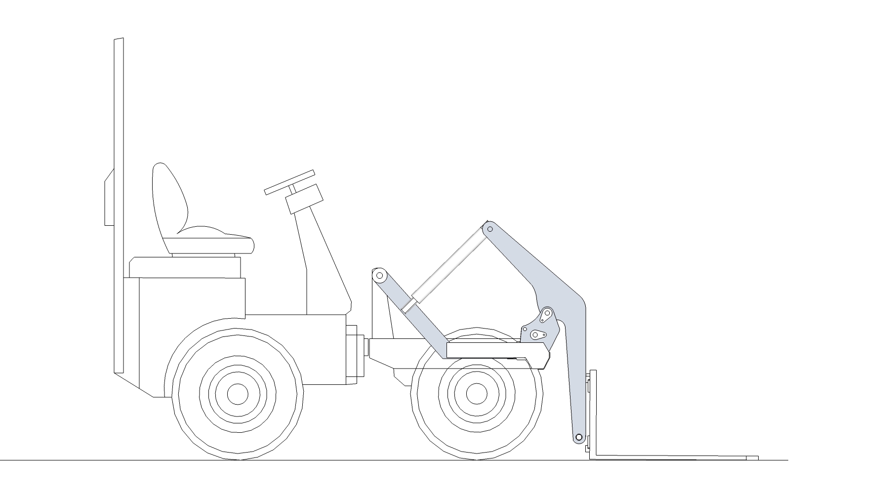

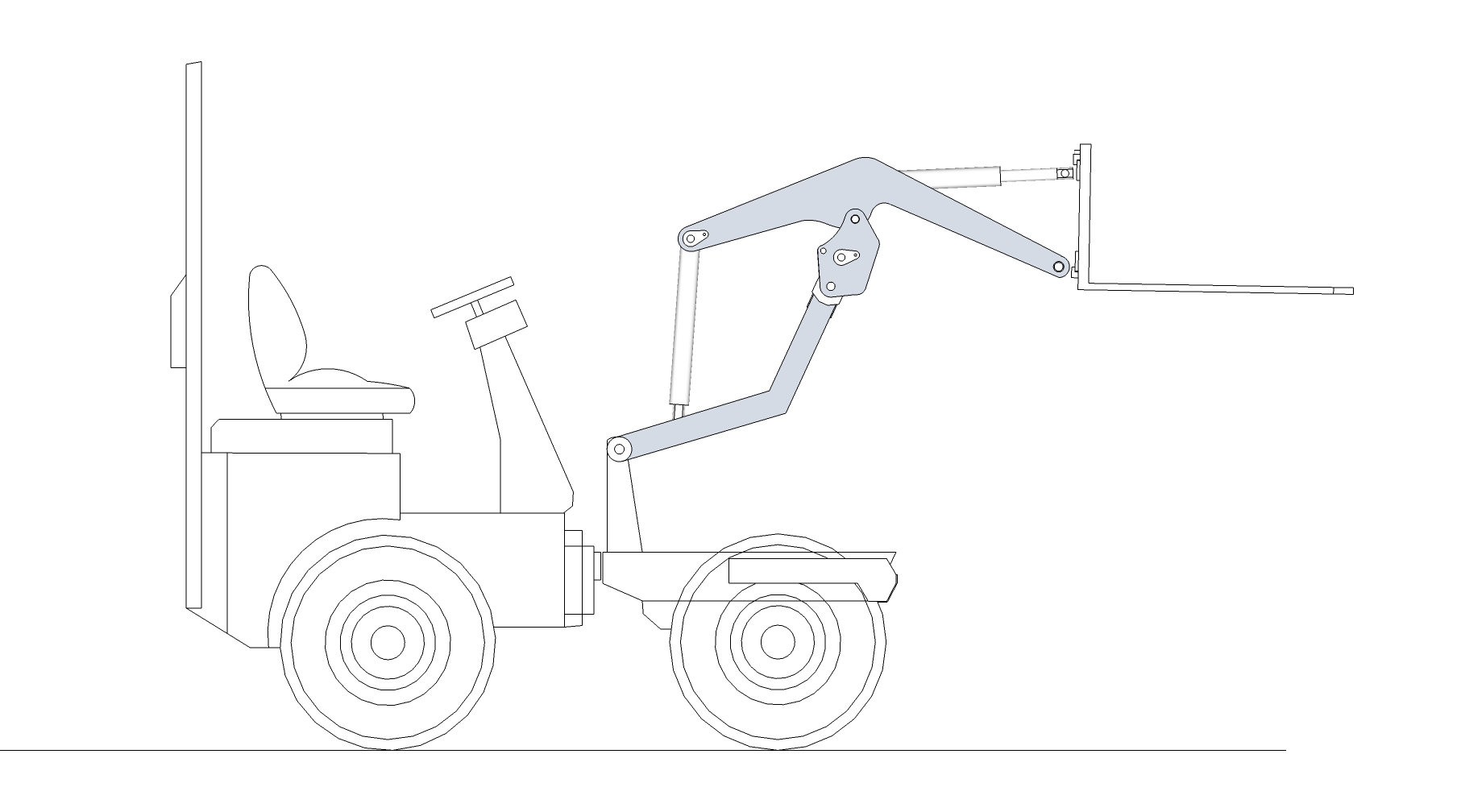

Working again at this into the wee late hours. I almost gave up last night as being too much trouble.
Sitting looking at it this lunchtime, I had a Eureka moment and suddenly, anything is possible again !!
The existing front tree, is on a parallel linkage and therefore any arms rigidly fixed to this will stay at the same angle regardless of the upward rotation of the main loader arms.
This gave the effect of an inverted "V" to the arms when elevated which was most unusual looking and gave a very poor lift height.
The Eureka moment was to introduce a second linkage to the front drop arms. The pivot point is already there at the fixing of the loader lift rams. Effectively as the loader rises, the front drop arms will now rotate upwards and outwards.
It will mean loosing parallel lifting of the attachment, but I think I can live with that.
See what you guys think.

   / Power Trac wannabe #13
Looks like you're modifying a compact wheel loader thats been modified into a skip dumper, into a forklift.
i'd just weld a real loader boom to it, as the basic frame is probably designed to accept both.
#14
Renze,
The dumper has been designed to be only that. It is a Terex, but the design was from Benford that they bought up a number of years ago. I've attached the brochure. Neither manufacturer has ever made a compact wheel loader from this design.
My target in all this is that the original dumper can be reinstated, should I wish to sell it on in the future. It's too good to chop as a "project"
I'm therefore trying to make a design that will work with the basics of what's there already.
Unfortunately I'm beginning to think that I'm over designing this and it will become too much of a chore to lift off the skip to attach some form of boom loader arrangement. I'm starting to lean back towards just attaching the forks with the skip in place and perhaps using the tilt motion of the skip to tip the forks.
Am at a bit of a crossroads at the moment.
