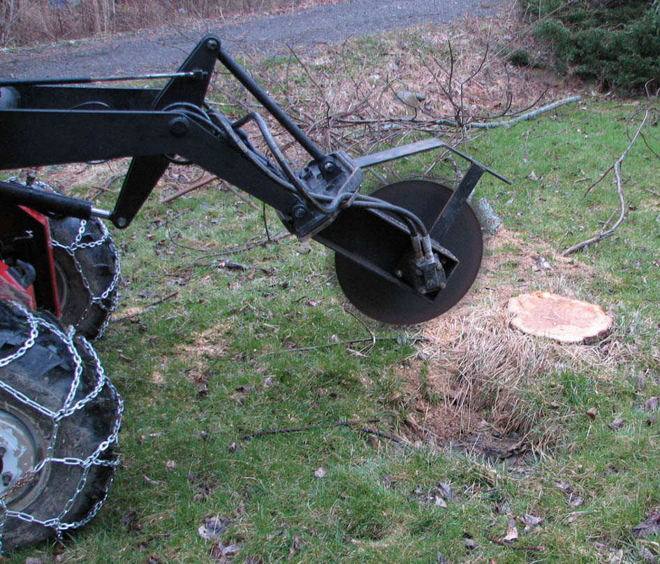

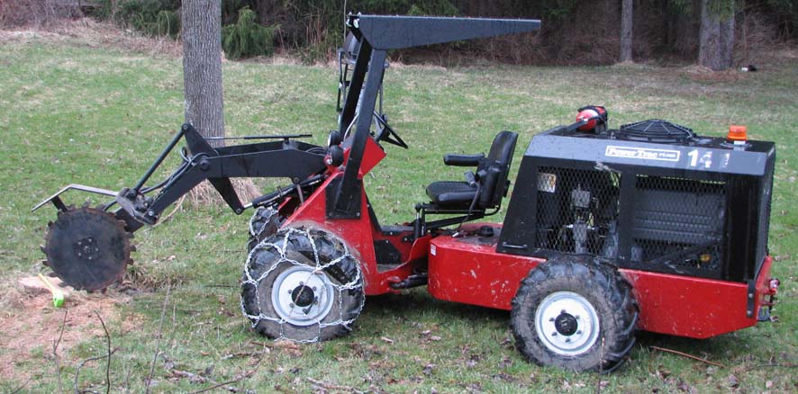

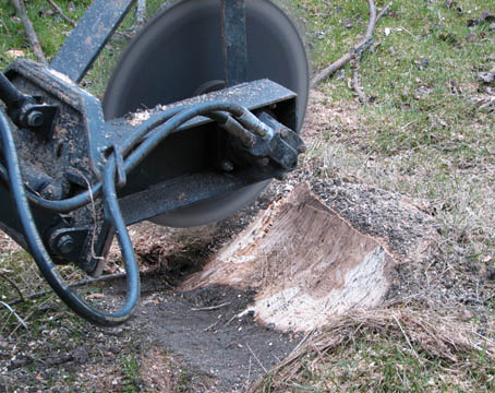

I have the older stump grinder on my 1850. Usually, I take the duals off to limit the amount of lawn damage. I have a few movies but all you can see are the chips flying away since it was taken from the operator's seat.

It works quite well especially after reversing the blade so that the chips are thrown away from the tractor. The newer ones are nicer because they have replaceable teeth.

I was looking at the teeth and spin direction and wondering how the tractor behaved if the blade grabbed! Does that happen?

The most that could happen is that the hydraulic motor stalls. The biggest negative of this setup is the wheels dragging sideways on the grass as you swing the blade back and forth. If I used it a lot, i would modify it to use hydraulic cylinders to swing it. I really prefer my swinging mini-hoe to the fixed one.
