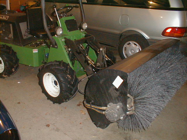

Hi Duane,
Here's photo #1 - The Power Sweeper on the PT425 in the garage, arms in float, in 'rest position', fully tilted-up to put the weight on the gauge wheels only.
-Rob /forums/images/graemlins/grin.gif

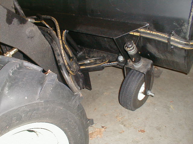

/ Power Sweeper in Snow!
#16
The other side...

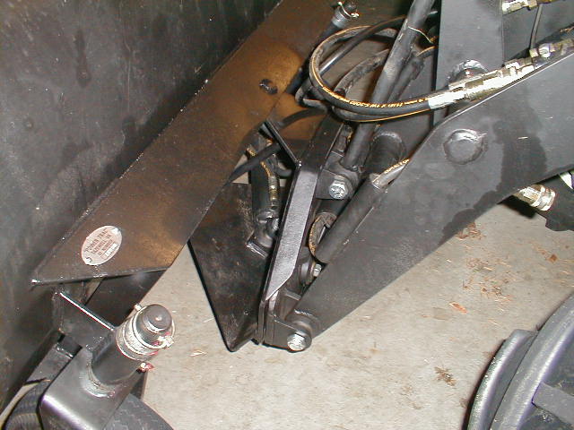

#17
Closeup of the attach plate (sorry, it's like 15 degrees out, and I didn't want to 'untilt' it and lift it - which would give a better shot - we're expecting freezing snow and rain tonight!) /forums/images/graemlins/frown.gif

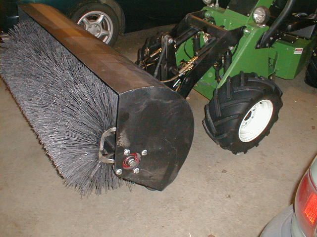

#18
Final shot - other side of the quick mount plate, shows the angle cylinder...
