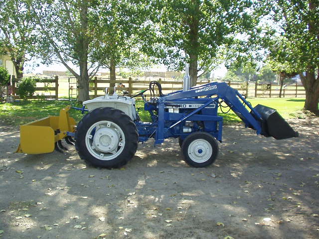

I had a Ford 1600, see attached pic, that I used primarily as a mowing tractor, so I can appreciate one wanting to add power steering. It was a great little machine and would run all day on a sip of diesel, but man you had to really muscle it in tight corners. If such a conversion is available it sure would be good to know, with used tractor prices going up it might be worth doing.

Your this Ford 1600 isn't a Japan tractor with 2-cyl. engine made by Shibaura? I have never seen a power steering kit for them. If available anywhere, it will be very expensive because of numbers of these tractors were not many and no power steering kit Mfg will want to manufacture such kits for few tractors. Your only chance is to find a dealer or two who had sold these tractors late 1970s. They may provide the info.
