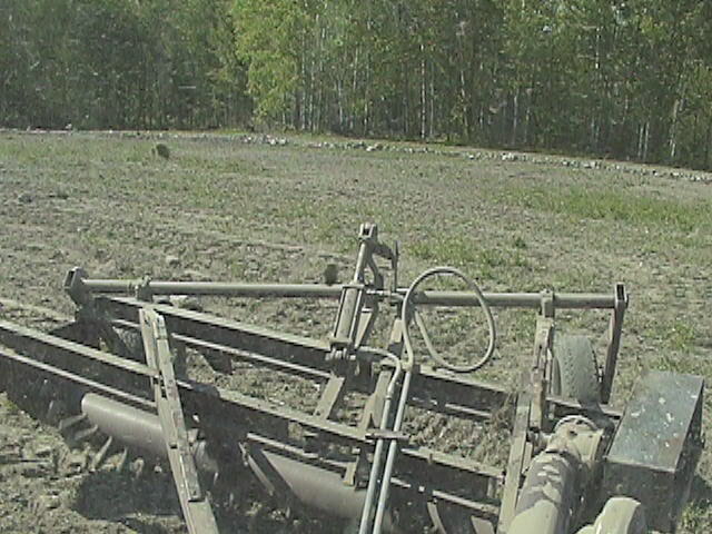

Here is my home made PTO powered, hyd lift, pull behind, rock windrower.
Clears a 9' swath knocks down high spots fills in low spots with fine dirt and kicks the rocks to the side. Have about $450 in it.
Running right after a good rain eliminates the dust clouds.

If it were me , i'd run around and scoop up the piles you have and pick up any big bits with the bucket and top dress with some good top soil . 3 or 4 inches of top soil covers a multitude of sins .
Barry , that's a nice rotary rake you have built , good job .
