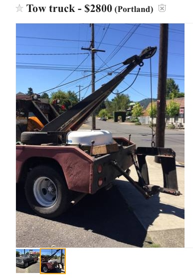

I've often though that small time logging would find lots of use for an old tow truck.
