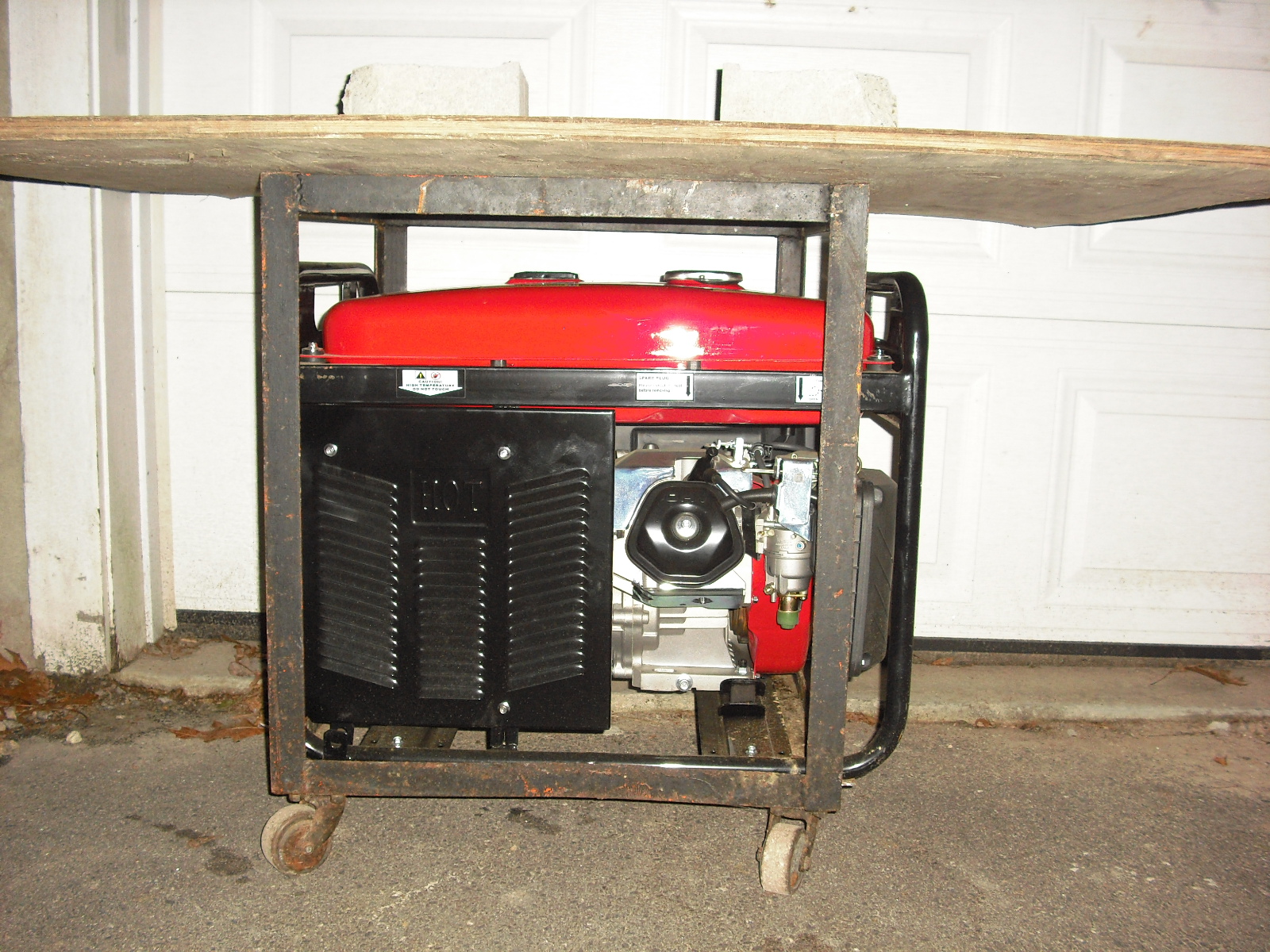

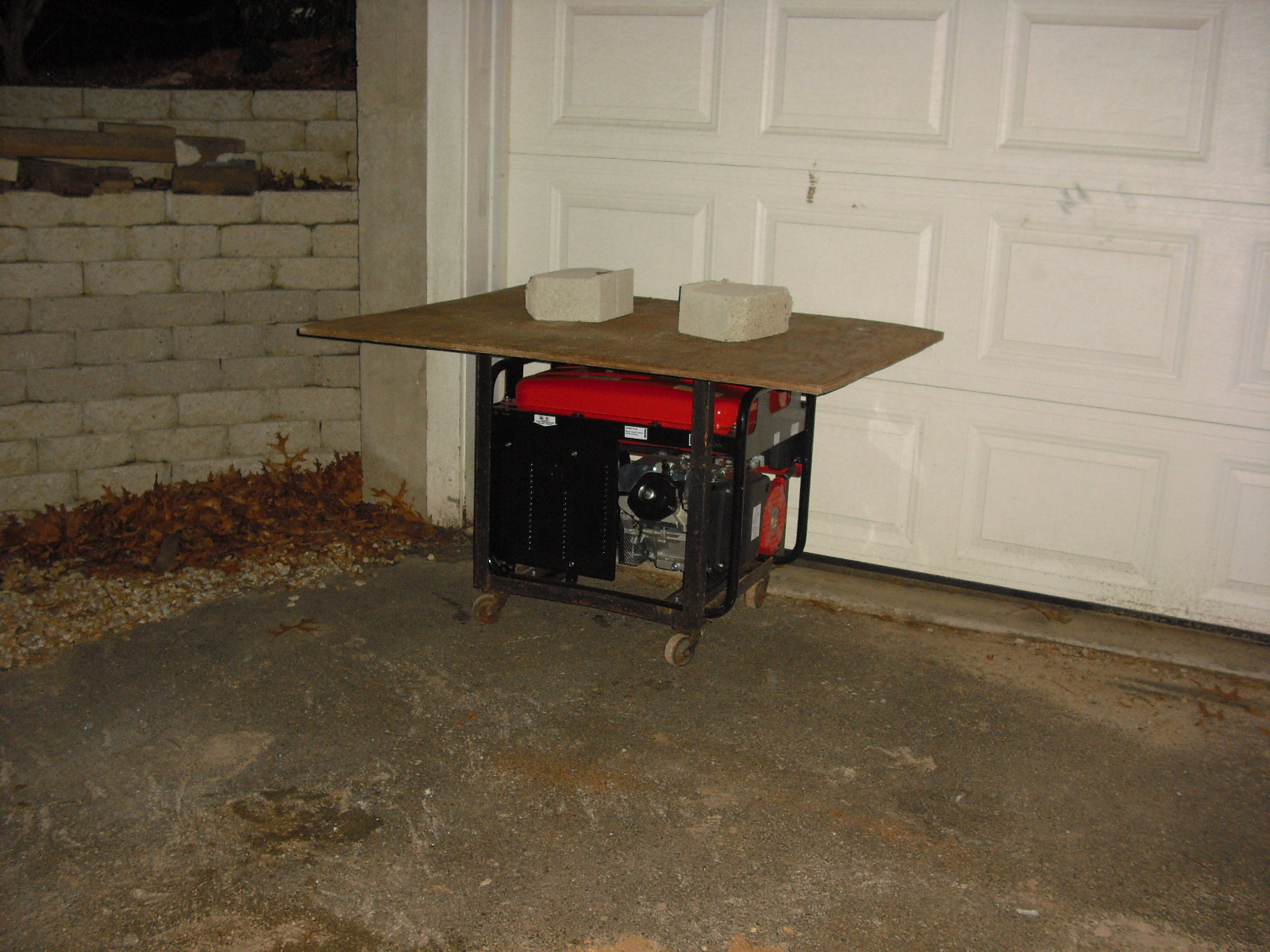

Not much of a Kioti topic but thought I'd share. We had a big ice storm night before last. We lost power at about 11:30pm after a couple of loud transformer explosions. Many Many Many trees are down and power is out in the entire town. Some are saying we'll not have power back for at least a few more days. Tonight's forcast is for single digits. I've been running on generator since the power went out. The generator is a 5500 wat PowerPro generator I bought at PepBoys last year during their black friday day after thanksgiving sales event. I paid $329 (hard to believe). The machine has a 13 HP overhead valve motor and a 6.5 gallon fuel tank, she'll run at least 10 hours straight. I hook into the panel via a 240V receptical and a dedicated 30 amp breaker. She runs the entire house with ease. I have forced hot water heat. The big draw is the well pump. I am affraid a lot of people are going to run into trouble tonight. One guy has already killed himself with CO2.
I've got my miller welder which is also a 5500 wat generator, was thinking about maybe trying to hit the road and help out some folks but man the liability is huge I would think.
Thought you guys might find this stuff interesting.
Joel

Sounds like you are prepared for the long haul.:D
Like your weather shield!:D

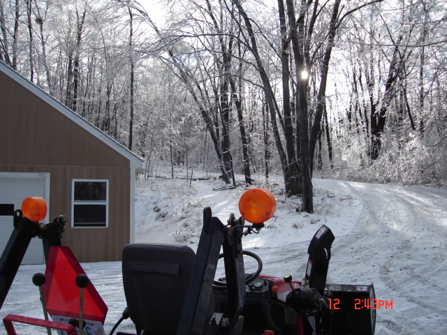

Guess we were lucky-- only lost power yesterday for 8 hours, starting at 3AM. We got some ice, maybe 3/8" coating on branches, but lots of limbs & trees down. This was preceded by 4" of snow; sounds like you guys "down south" must have had ALL rain/ice. National Grid (sometimes pronounced "Greed" :D) is generally pretty good up here about getting things back on line quickly. Hope you folks get your power back soon. Pretty darned chilly this AM up here, about 8.
