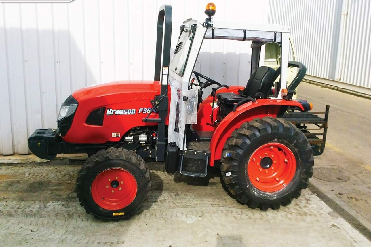

Here we mainly have tractors with mid mounted ROPS. So the ROPS is mounted in the middle of the tractor, and a big arch is folded over the hood. The ones made by Korean and Japanese manufactures are made out of really heavy rectangular tube while the Italian manufacturers use a much smaller round tube.
Trust me, lifting that rectangular tube is an absolute pain. I don't think old people will be able to lift it by themselves without having something or someone to help.
So since we have so many deaths caused by people using the tractors with the ROPS folded down, the manufacturers are now using gas springs to help fold the ROPS up, in hope people will actually put the ROPS up.
I've never tried one but I can see how this will help significantly on lifting the ROPS. This might the a solution for the OP.
Note the gas spring, there one on the other side also:
