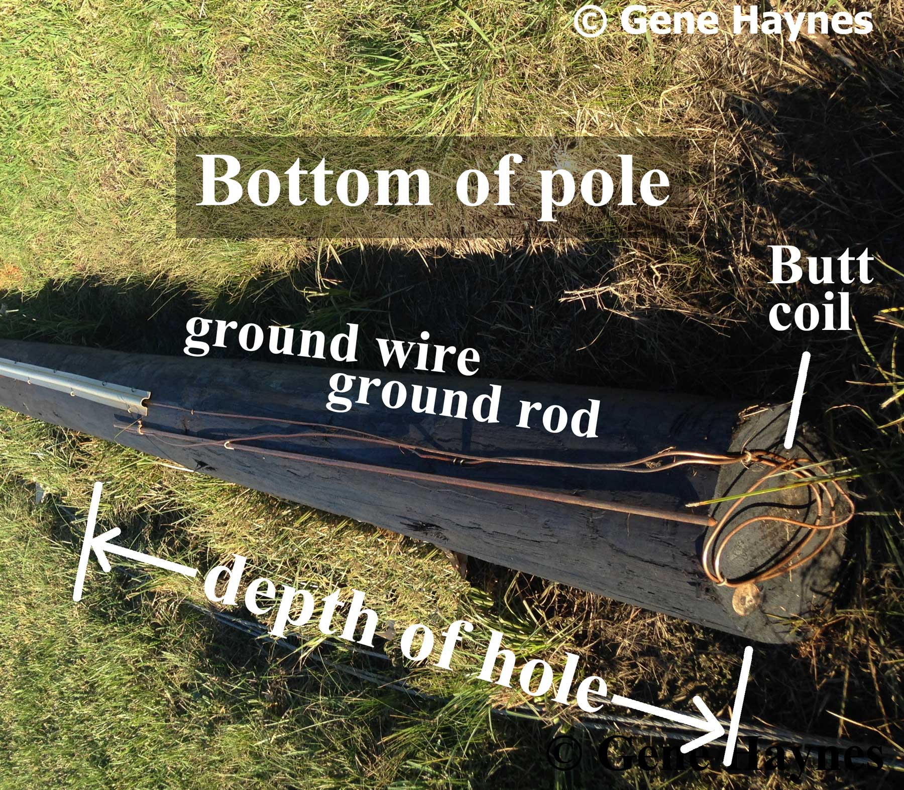

Googled (actually used Bing) "telephone pole butt ground" and went to images.....
   / Power Line to my house was broken #232
it is a common practice here Coobie. Every pole, before it is set has a spiral wrap on the bottom of the pole with the #6 wire. Of course it is stapled all the way down the pole and then the spiral wrap on the bottom of the pole.
I thought I had mentioned this up thread but maybe I only thunk it. :unsure: :D
Years ago they were replace power poles in town, and before they put the poles in the ground, the poles were just laid out along the side of the road. I noticed that all of the poles had a copper wire running down the pole and at the bottom of the pole the wire was in a nice, neat coil. The coil and wire were stabled to the pole.
This was when copper theft was a big problem and I thought they were taking a chance leaving the poles out with that tempting copper just sitting there. Best I could tell, none was stolen. (y)
We have had so much growth, the "new" poles are being now replaced with bigger and taller poles. :eek:

Me, either, but I wonder if it has a lot to do with the soil depth that you can expect a reasonable ground at. Soil that is too dry / too sandy / too rocky isn't going to function well.
Or do you think it has to do with grounding lightning strikes better?

I've been wracking my brain to try and remember how they did the ground wire on the poles when they installed them. I remember seeing a guy unroll the copper and staple it to the pole when it was still laying on the ground, but I don't remember what he did with it at the bottom of the pole.

Not too surprisingly, the crew comes out the next morning, and proceed to drive two large bucket trucks up and across slopes that my slope tractor has challenges with. Thirty degree slopes. They can't get their biggest truck up there, so they have to rig a pulley and winch to lower the old transformers off, and the new ones up. After a couple of hours and quite a bit of work for everyone on the six man crew, it is done. They mention in passing that they had to replace the ground wire for the pole. I am not surprised.(More on that in a moment.) Two years ago, the power company contractors worked on the pole adding rot preventative, and checking the ground, which I happened to see. So I know it was good then.

Here is why I wasn't surprised to have a melted ground wire on our transformers: We had a doozy of a lightning storm a year ago, the one that started last summer's fires here in California. Eleven thousand lightning strikes or so. Since then, the power company has been replacing transformers along miles of power lines toward our place. They were due to replace ours the day before this happened, but they canceled at the last minute, so I suspect that they knew the transformers were dying.
