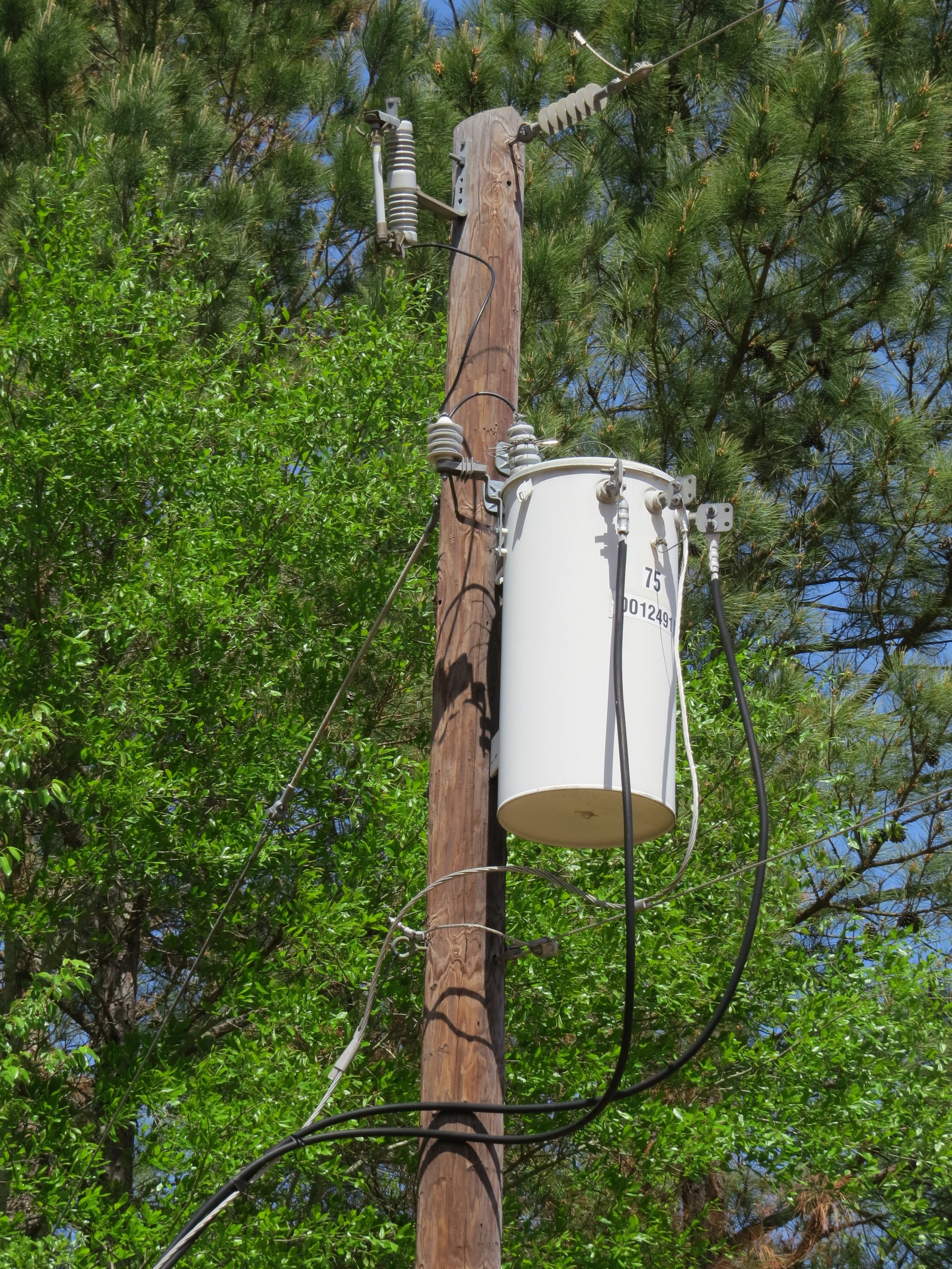

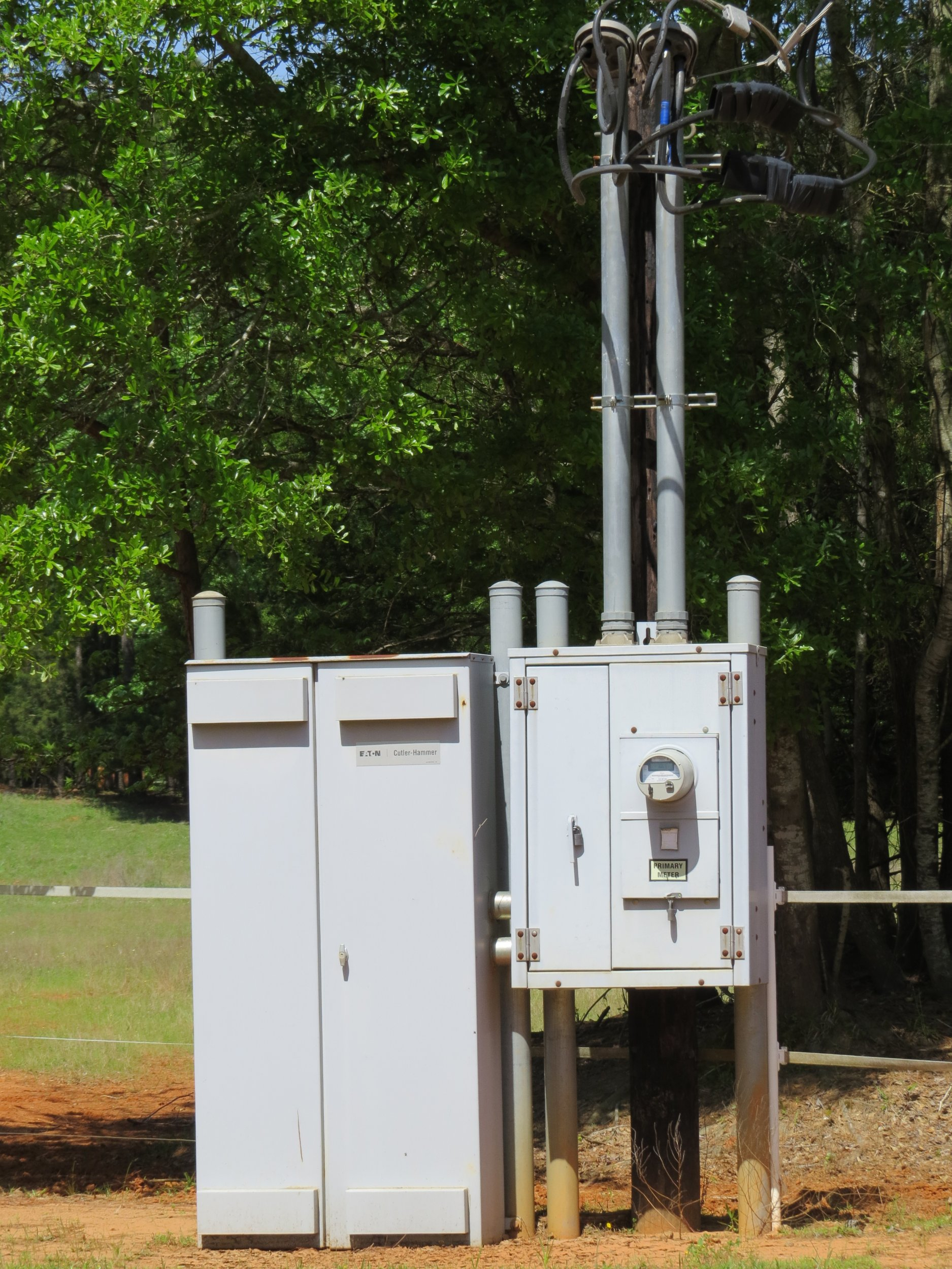

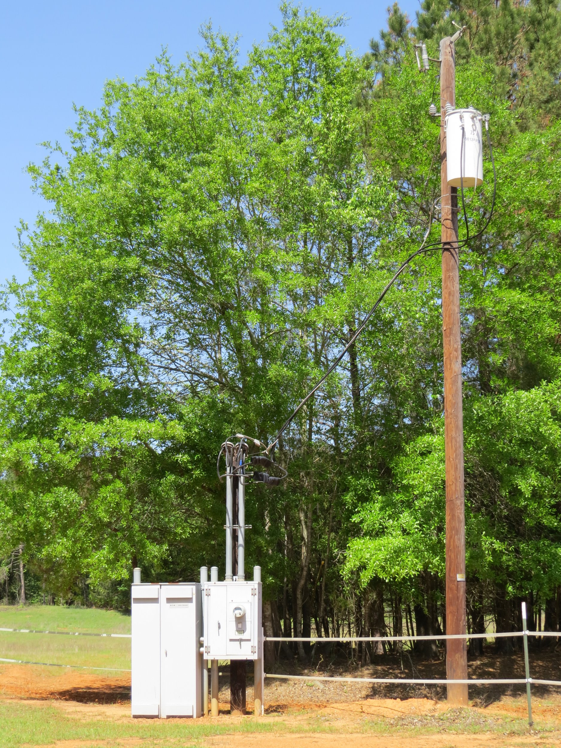

I'm late on these pictures, but this is what my meter and the transformer look like.
View attachment 694648View attachment 694650View attachment 694652
SHHHH!
Great picture.
It shows the top wire feeding the top of your transformer.
Your two 120v feeds coming out of the side with the neutral bare wire
in the middle. Notice that bare neutral wire is clamped/crimped to the
bottom wire on the poles AND goes to your house. Makes sense now.
