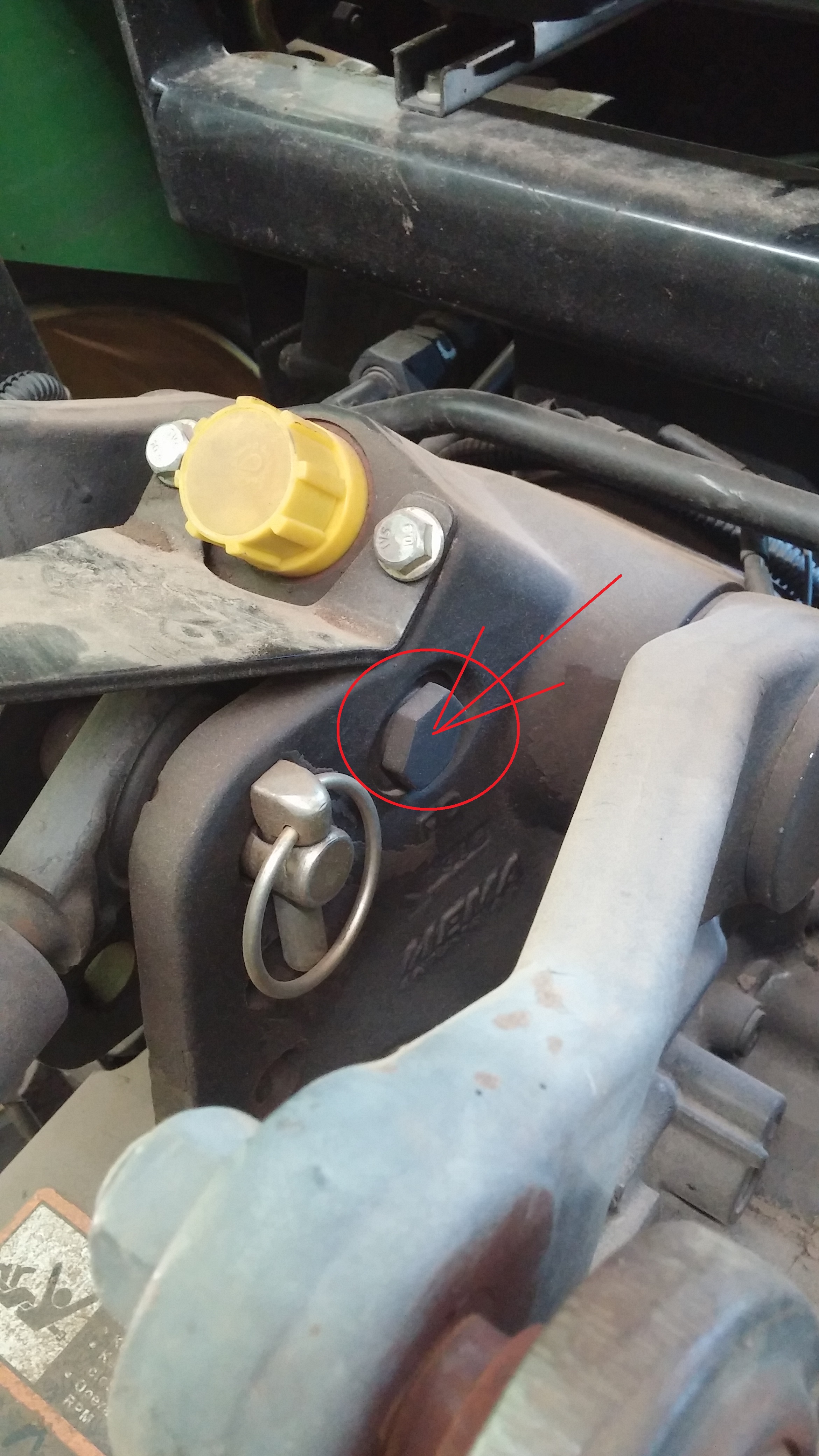

Jut wanted to share that I took KennyD suggestion and got very familiar with the JDParts schematics. (thanks Kenny) And....I also decided to post over the JD owning forum asking the guys who own 3320 and 3120 where their oil return lines on their PB goes and low and behold, the oil return on their Transmissions/transaxle housing is right below the transmission filler cap and fortunately, my 3203 has the same plug. So I am good-to-go now.
Ill attach a pic of it just in case someone else may read this to save them some time.
My plan is to get a 2spool prince valve and tap in to the rock shaft pressure line and then of course route the return line to the plug in the pic. I will just put out some QD couplings out back for now and expand it out as needed. Probably a simple hydraulic top link to start.
Thanks everyone.
Charlie.

Charlie, just to be clear - you did NOT mean TEE into the pressure line, right? Because that would give your fluid TWO paths back to tank, and you wouldn't have pressure to EITHER path since one would ALWAYS be open to tank... Steve

Yes, but I am not going to tap in to that line after all. I have found a access to plug up on the transmission just below the filler cap that is a much better choice.

OK, just so you know you can NOT TEE a PRESSURE line on open center hydraulics, that's why PB valves exist - so if you "tap into" the line going to your rockshaft, the only way it would work is to cut that line, connect the cut end coming FROM the pump into your new PB capable valve - then connect the OTHER half of the cut line to the PB out of your new valve, and wherever you find a Tank return, the Tank port of your NEW valve CAN be tee'd into that.
Another way to put this - pressure lines in SERIES, Tank lines in PARALLEL...
Also be aware that, usually, if you connect as above your 3PH won't work while you're using your new remotes - that's just a momentary thing, meaning you can normally only use ONE function at a time - but as long as you're not moving a remote (new valve) lever away from center, the 3PH will work as it always did.
HTH, if I'm covering things you already know then just don't read this :D

Yes, that has been my plan on the pressure side all along, thanks to several others who have also helped me understand the importance of pressure lines being in series. Fortunately, this is the easy part of my PB plan, as I can fairly easily divert the pressure line from the pump to the new dual spool valve and connect that PB line over to the loader spool input (where the original pressure line was going) and then connect the drain (tank) line over to the transmission drain port. For the sake of the discussion the line out on the loader spool then connects to the rockshaft valve.
