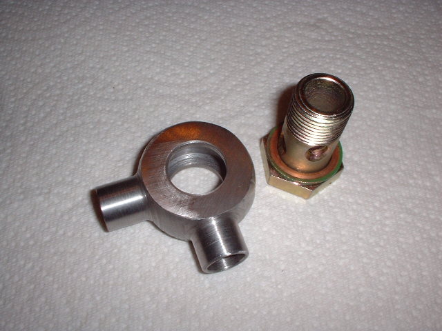

Last call for anyone with any left-over banjo fittings they don't need, before I spend a few hours at the lathe to fabricate the last one.
MANY THANKS to Brian M. Lekki and James Woods for the care packages they sent; some left-over hollow bolts from Brian and a line with one banjo and one bolt from Jim. MUCH APPRECIATED! Hope I can return a favor some day.
The bolts will save me making them from standard bolts.
With the dual banjo I made on the lathe (see the thread over in the "Build-It-Yourself" section about "SAE-8 Banjo Fitting Autocad"), and the one that Jim sent, I just need one more standard banjo if I can re-use the ones on the lines I am replacing. That assumes I can un-braze them without any trouble, which shouldn't be a problem, but I've never tried to do that before. Should be about like un-soldering copper pipe, only hotter.
Any more banjos out there collecting dust? I will pay something reasonable if you've got one you can spare.
I can make them on the lathe, but it just takes a lot of time.
Thanks! /forums/images/graemlins/smirk.gif
