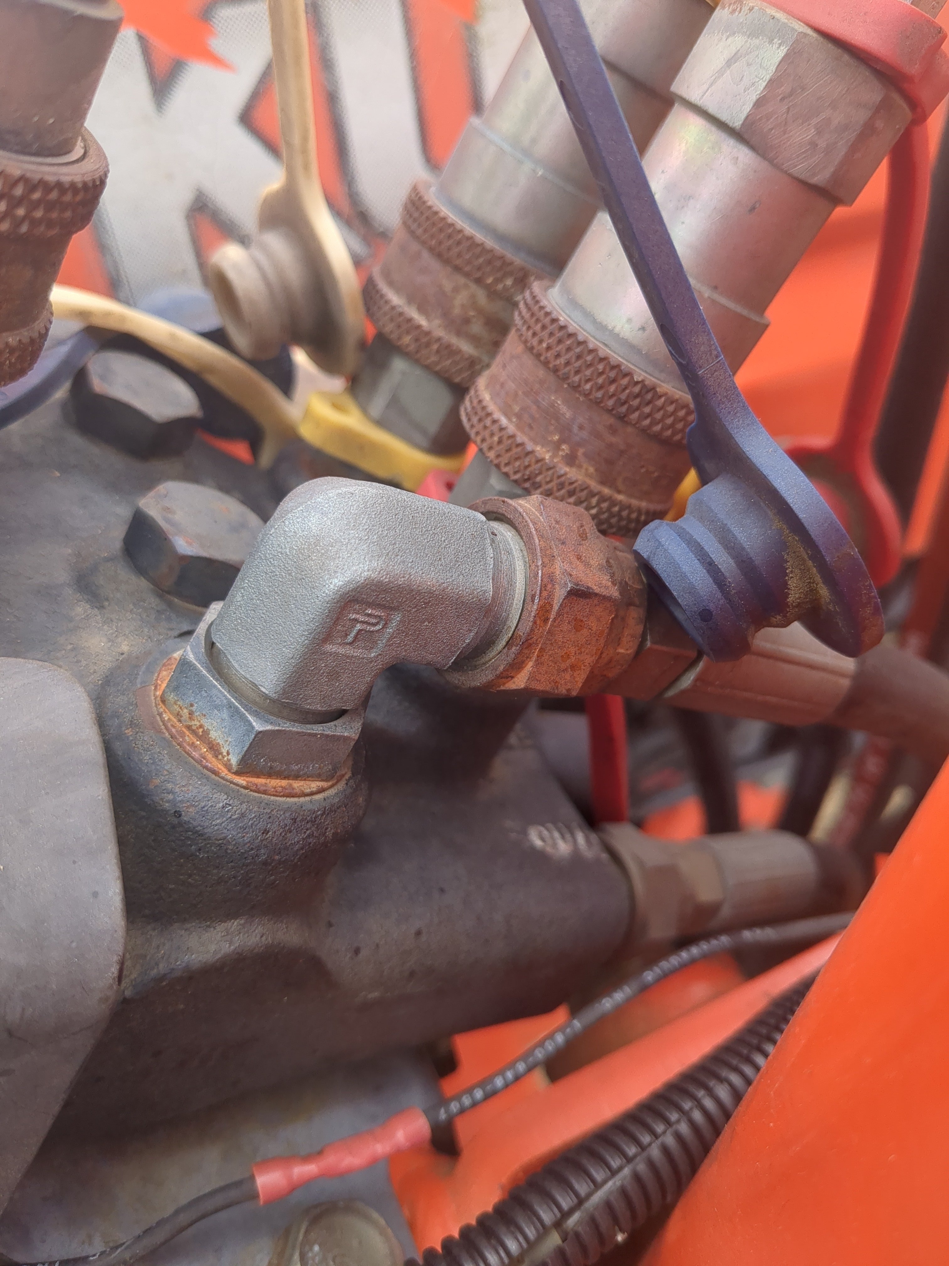

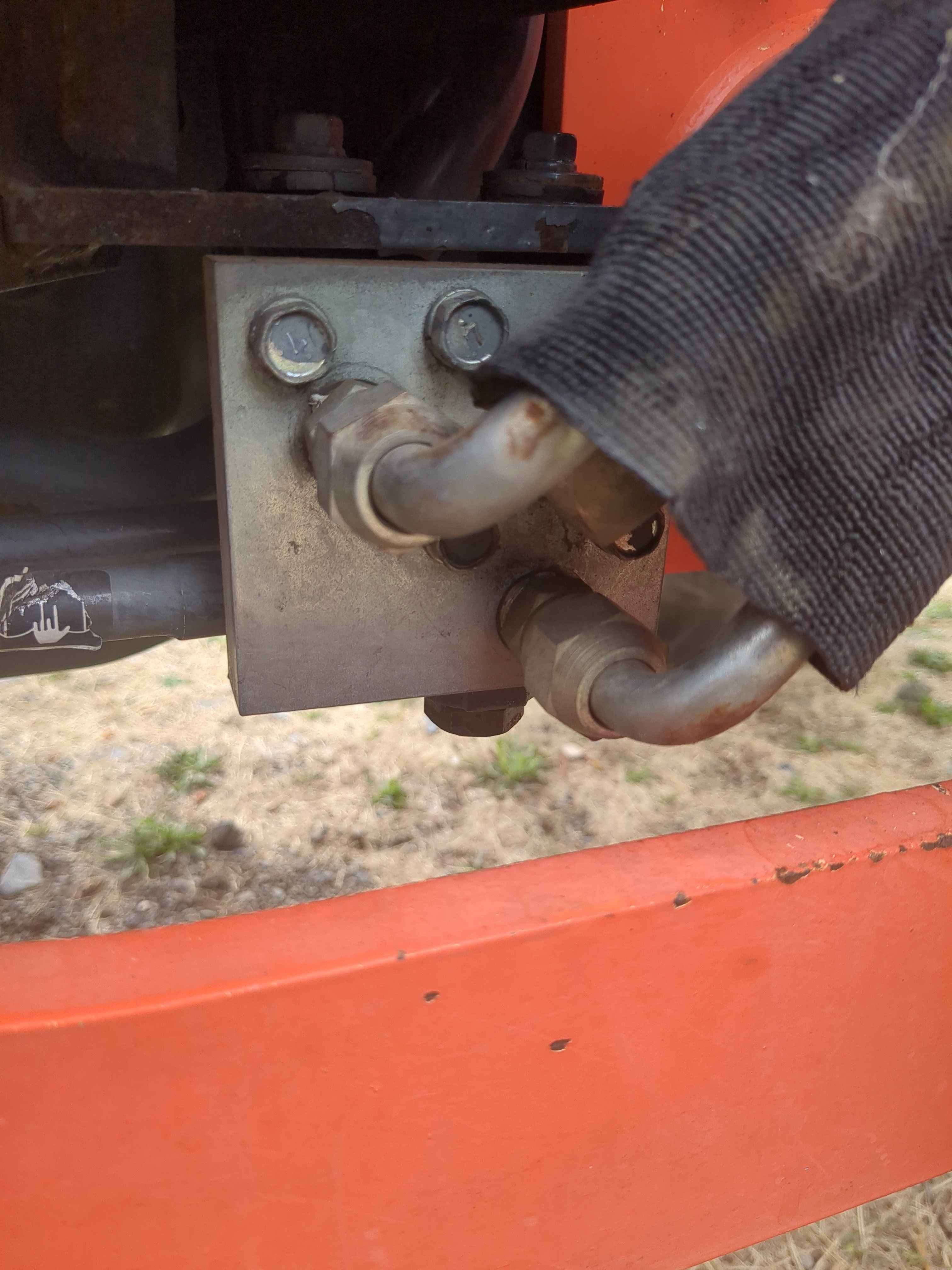

Yeah I'm still playing around with how I'm gonna run it but all of your input is valuable and has helped. It really makes me see there are allot of ways to run things.
One of you would not happen to know the pb and the tank fittings what they exactly are... Ie size would you so I can order my setup.
