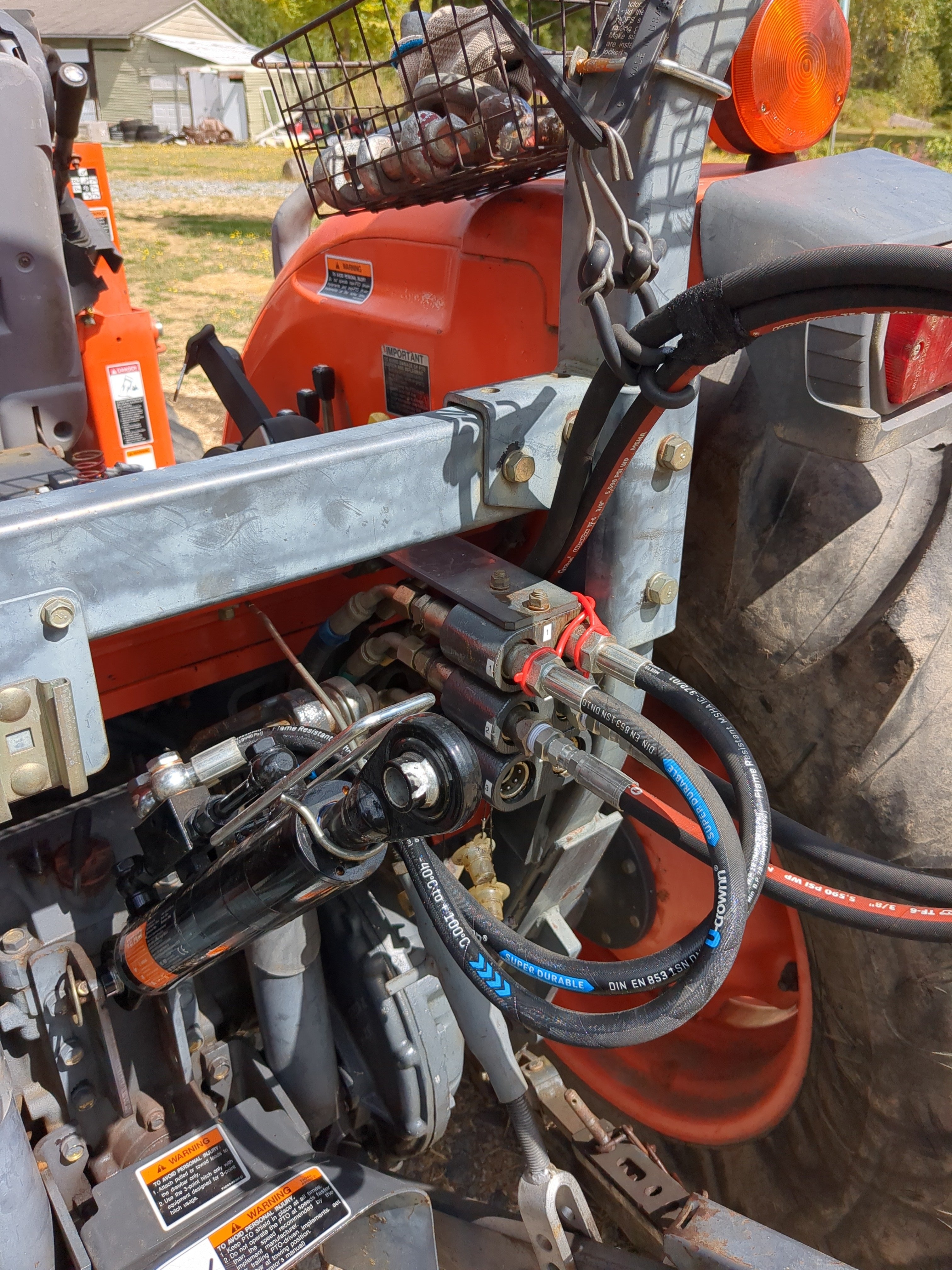

So I was thinking originally of running a power beyond loop to the rear of the tractor but, I want to be able to run front mounted implements like skid steer stuff as well.
I could run it and just have it self looping at rear for things and just undo how I run it and switch it around manually to front as needed... Long hydraulic hose.
I can't find anything online for what I'm thinking... Can I??
Put quick attach fittings at the pb port and the tank dump port... Have a short line to plug them in together when not in use then a long hose I can run to front and rear with quick connects?
Then I could run front or rear with the loop just using the quick connections and swapping line.
