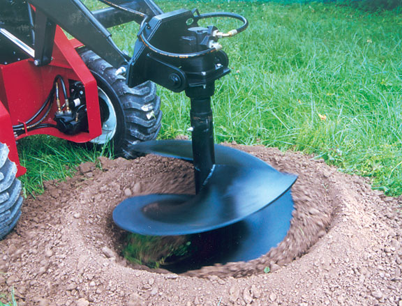

This is to mount the gearbox to. I don't think the big one has enough torque for direct drive.
My concern with the big one is the rpm. If I use it with a 3:1 gearbox then my rpm is going to be about 50 at max. that means at 20 gpm. So, at what engine rpm is my pump pushing 20 gpm? I don't want to have to run at full throttle just to get 50 rpm on the auger. Also as a rule of thumb, smaller bits need to turn faster.
The small one may be a little weak. It is rated at 5475 in lbs at 2500 psi it will be less than that at my 2000 psi relief setting.
So, if I had a motor with about 5,500 in lbs torque, 300 rpm, 20 gpm 2000 psi and a splined input shaft it would be perfect for my application and calculations.
I realize that there will have to be some trade-off either in time, money, torque, rpm, etc. Just trying to locate the best one.

50 rpm is too fast for me to dig with. I dig at about 20 or 30 rpm (1/2 to 1/3 rev per sec). I only run up to the higher rpm to clean off the bit outside the hole. You need to rev up your engine to get your pump rated GPM.

It is rated at 9700 in-lbs. continuous which translates to ~808 ft-lbs. That should be enough per J_J's earlier post.
That is 2.5 times the 3800 in-lbs. torque rating of he Northern Tool one: NorthStar Hydraulic Earth Auger — 270cc Honda GX Engine | Auger Powerheads, Bits Extensions| Northern Tool + Equipment and almost three times the 3300 in-lbs. rating of the "Ground Hog" Ground Hog ? HD99 Hydraulic Earthdrill
That is also well over the rating of any of the units sold by Little Beaver ( Towable Hydraulic Earth Drills | Little Beaver Inc. ) which are common rental units in this area.

I thought from the earlier post that the flow (gpm)didn't affect the amount of torque, only the rpm? Can you give me your calculations of torque and rpm on that motor based on my system. (2000 psi 20gpm)?
I would definitely like to go direct drive. That would make my fabrication job easier and reduce the parts that could be broken. Just want to make sure I have adequate auger torque to dig in my location, otherwise it is wasted effort. Gearboxs can be purchased for less than $150 and they already fit standard auger bits on the outlet end.

6369 in lbs or 530.75 ft lbs
Input the cu in of the motor, and input the pressure of the tractor hyd system.
Result is in, in lbs.
Burden Sales
Speed is a time factor, just gets the job done quicker.
Motor displacement is set.
Pressure potential is there, but the motor develops the pressure.
If you want to see if the motor is developing the max pressure, install a hyd gage in the hyd system.
When the motor is working at full pressure, then the torque is there.
If you have half pressure, then you have about half torque.

Using the calculator link with my new choice motor for direct drive and my system info I get;
1270 ft lbs of torque and 101 rpm. These numbers work for me except that rpm is too fast for a 12" auger. Might be good for using say an 1.5" bit for drilling holes for t-posts in rock :)
My question(s): At what engine rpm does my pump produce the 20 gpm? Is there a standard or typical engine rpm? If, for example, the engine/pump rpm has to be at 1200 to produce 20 gpm and that translates to 101 auger rpm, then I would need to run at about 600 engine rpm to get the auger down to 50.5 rpm. Correct? If so, that may be barely idle speed which could kill my engine if I max out the pressure load.
Maybe a flow reducer of some sort, if that exists.
Your thoughts on engine speed, auger rpm, torque, etc. please!!

20GPM is with the engine wide open (~2000 RPMs). Its a linear relationship, so ~1000 RPMs will put out ~10GPM.

Tractordata info is incorrect as far as flow. They say 20 gpm, but when I looked up my pump by model number, its says 17 gpm. That means at (assuming 2000 engine rpm) I get 86 auger RPM. So at 1000 engine rpm I get 43 auger rpm with 1270 ft lbs of torque.
