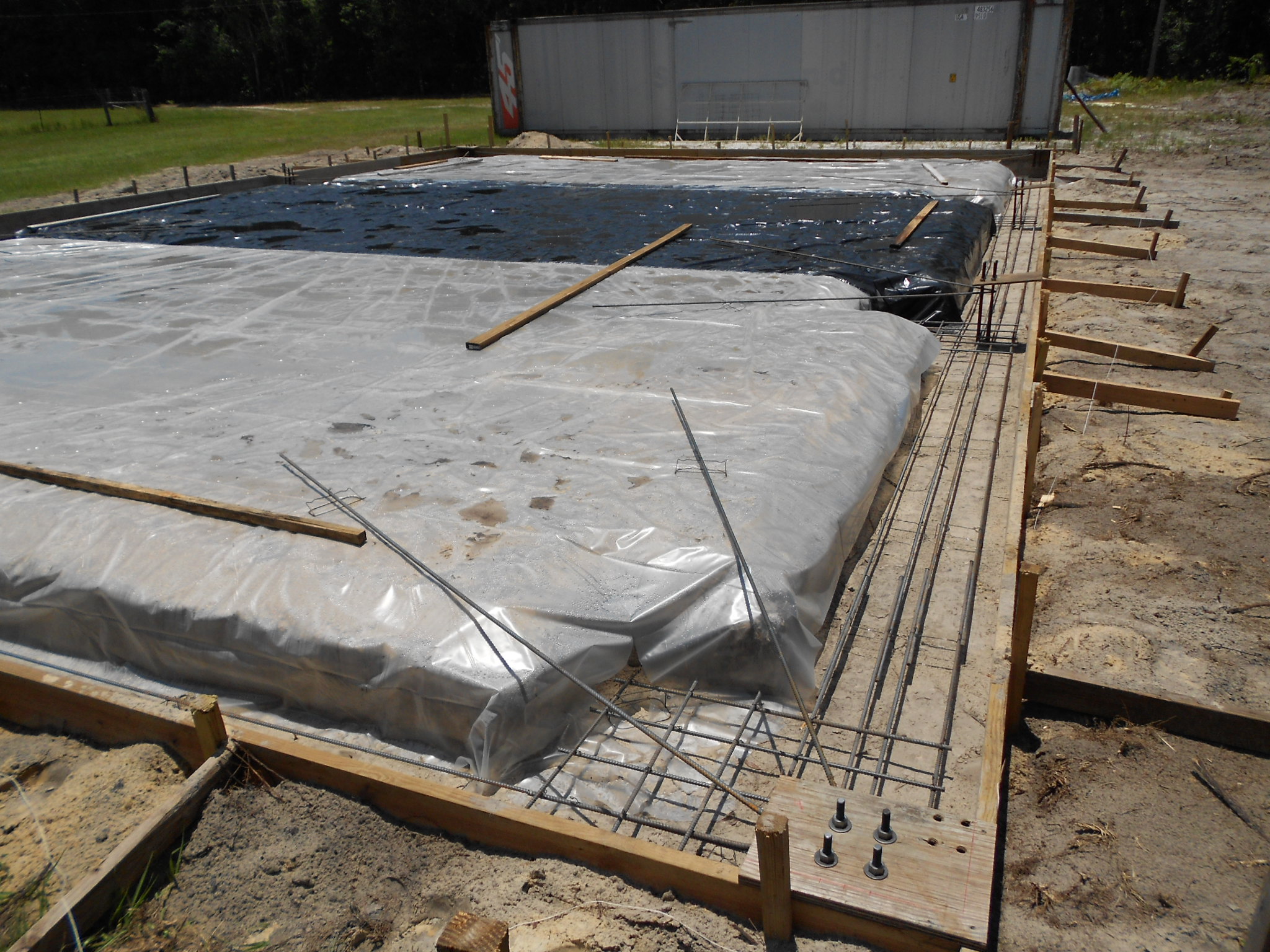

I just had slab put in for a 40' X 60' building and they only formed the top area.
They compacted the ground very well then dug it out per the drawing.
