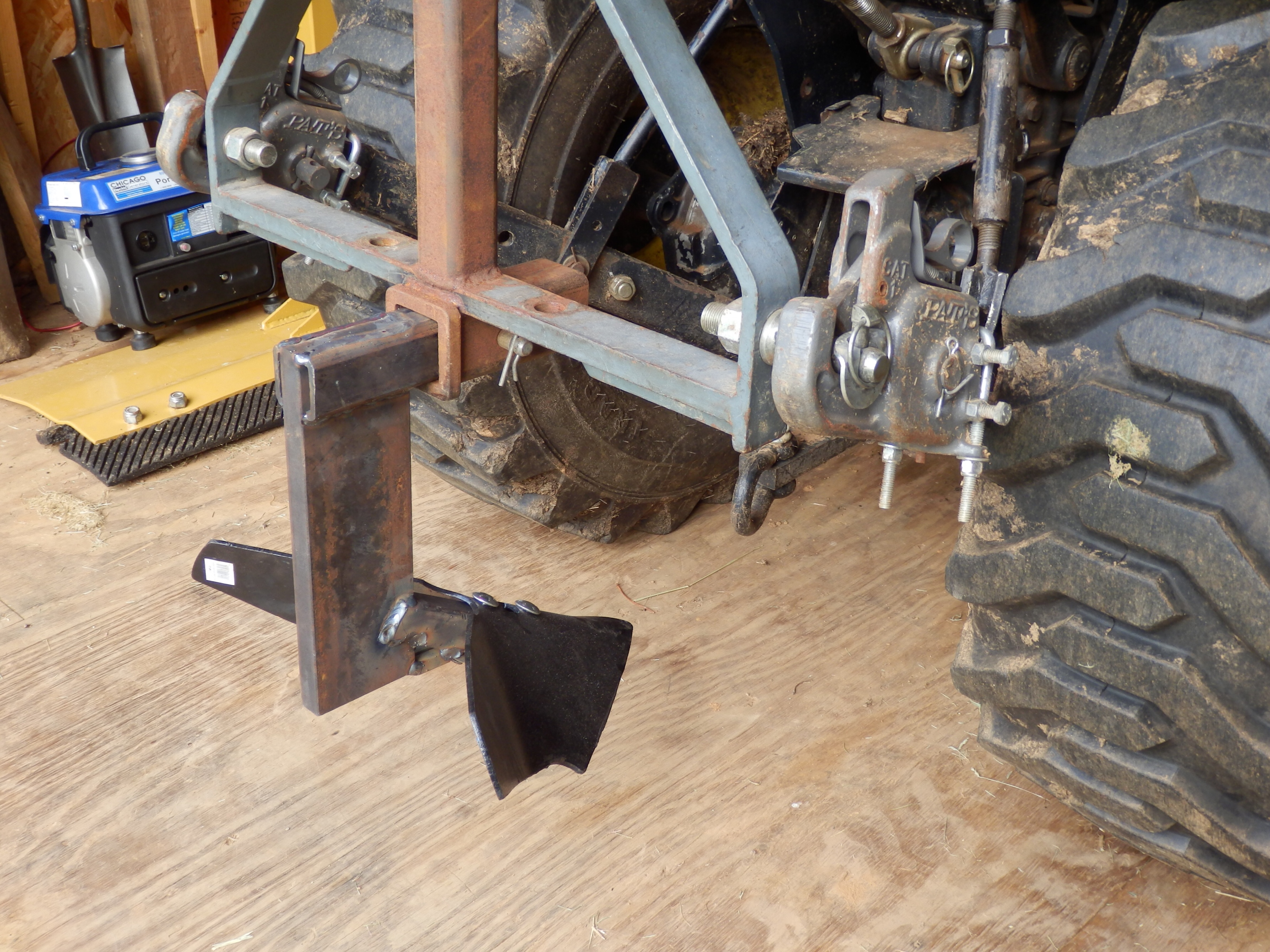

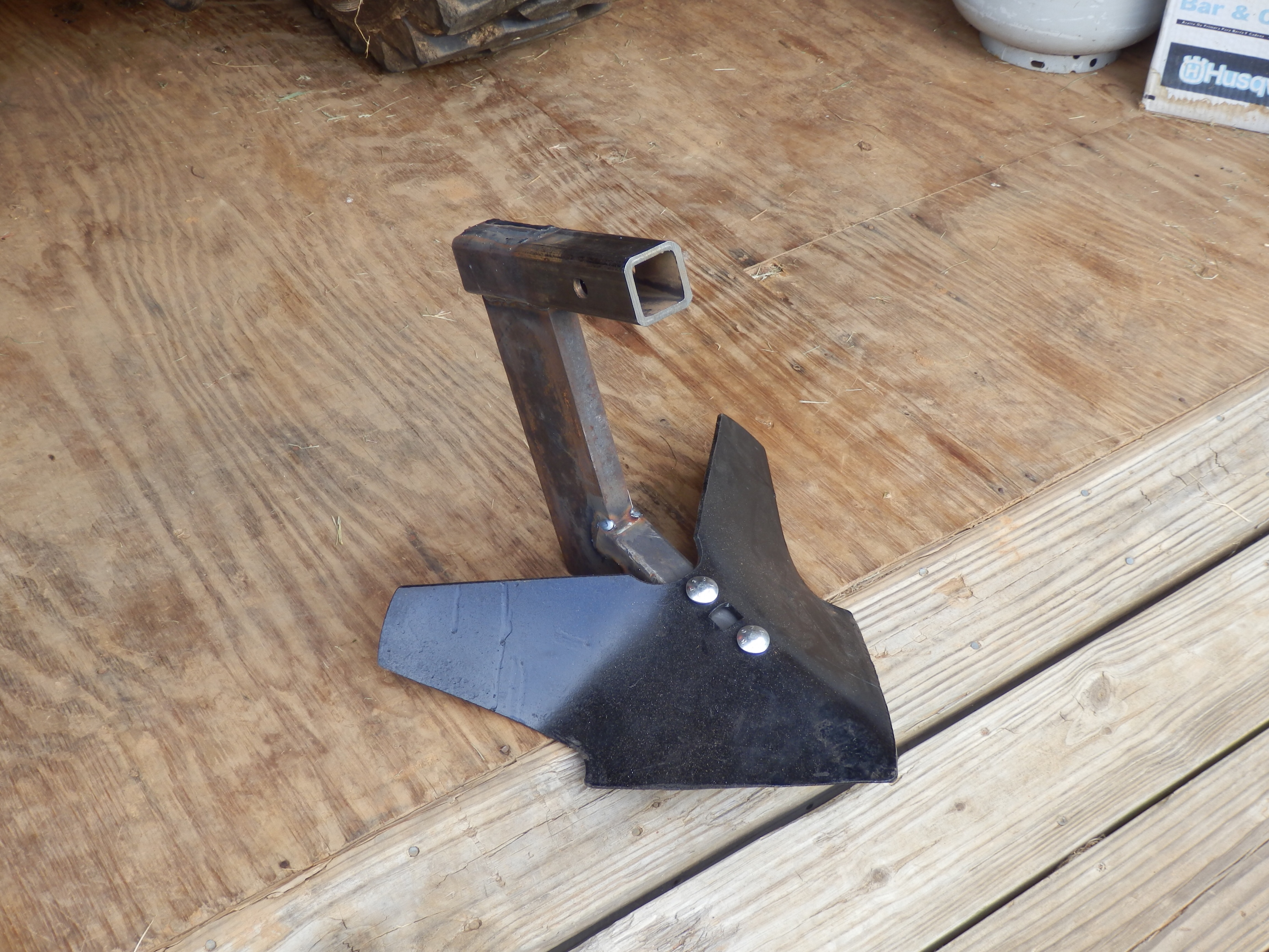

I’ve used this setup a few years now for furrows to plant in and for digging. It works great . No excessive side to side sway as P9111579.jpg
mentioned by one commenter. It was welded together for me by an Amish friend from a conventional potato plow share and some 2” receiver stock. P9111580.jpg
