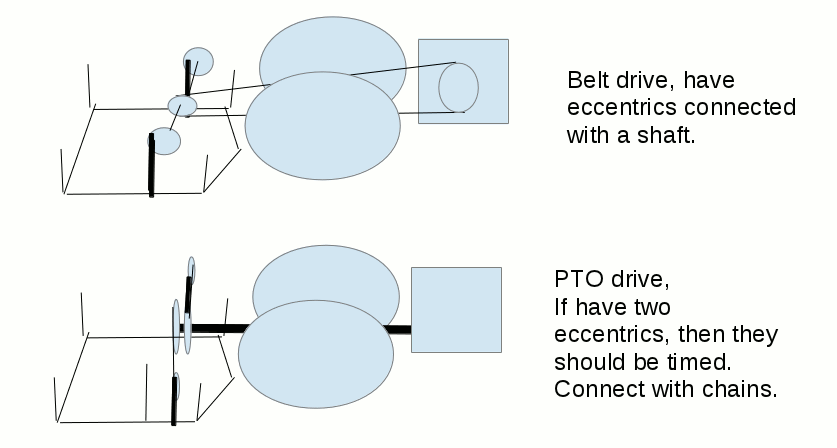

The shaker mechanism will probably take some abuse.
I'm not sure you need a right angle gearbox, but it might not hurt to isolate the shaker from any shafts in your tiller or tractor with belts, chains or a U-Joint.
If you have a longitudinal (PTO), perhaps a couple of chains to transmit the force to the side of the shaker box.
If you have a transverse belt drive, then a shaft.
No right angle gearbox, just belts, chains, or shafts.
It might be easier to make with a single eccentric, but it might cause quite some torque on the system.
Actually, if you have a bar going across the top, then you should be able to connect an eccentric in the middle... making it much simpler.
It still doesn't make a big difference which direction it is facing.
