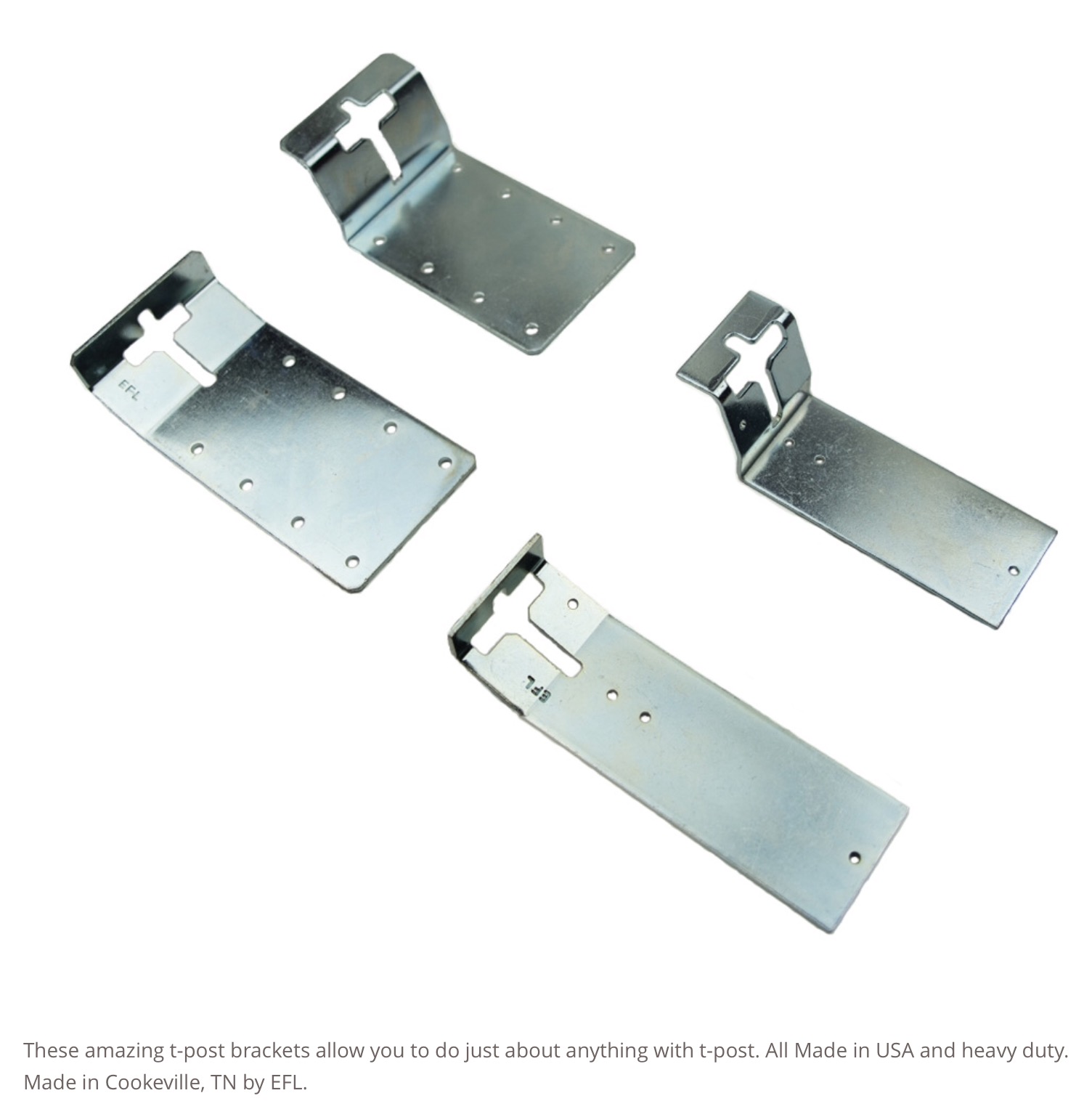

Had to do the same thing...and found these t-post brackets to be easy and real useful. :thumbsup:
Good to see that the idea fairy still hangs out in Tennessee!
Home - Electric Fence Light
Kinda funky navigation on that website but here are some ideas:
Photos & Videos - Electric Fence Light
Also available on Amazon and eBay...just search for "t-post bracket"

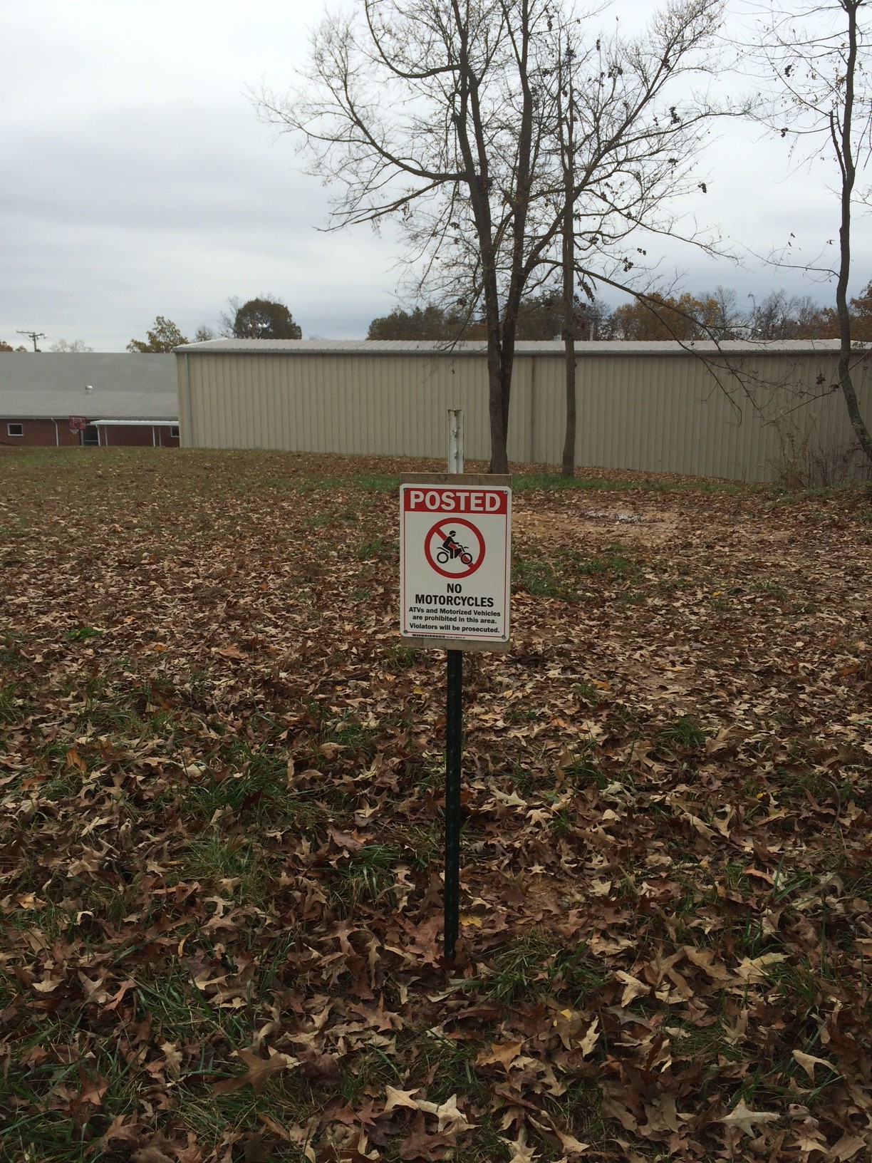

Had to put Posted signs up at church last year. Neighbor kids were riding around the gym and all over the grounds. Cut a groove in some 3/4 plywood, filled it with construction adhesive, then screwed it to the T post. Mounted signs I found on Amazon. sign.jpg
