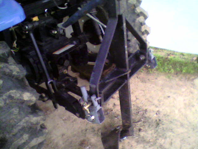

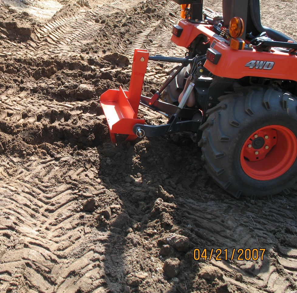

Here is a subsoiler I made out of some scrap metal I had laying around. I got a few different blades for it from the local farm supply house.
It sure lets me know I don't have a very heavy tractor when I hit something solid. But it does work well for my needs in very compacted soils. I used it to dig up and loosen some soil that I needed to move with the loader. It worked perfect for that task after I ran back and forth from different directions to loosen it up.

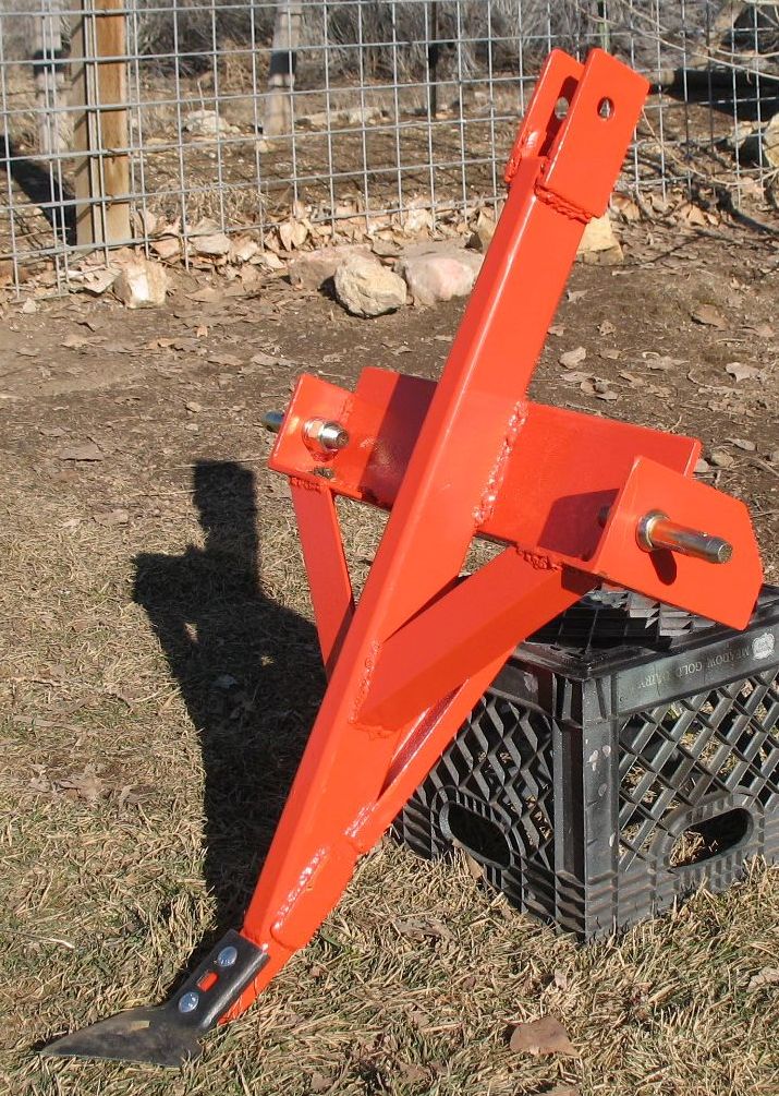

Here is one I built about a year ago. I cut the cross a bit shorter than the usual implements. Felt like it would give more strength. I put a brace on it for strength.
A stand is a good idea.
I fixed it so that I can use several types of points. Such as a middle buster, or other plows, as well as the subsoiler bit I made for it.
