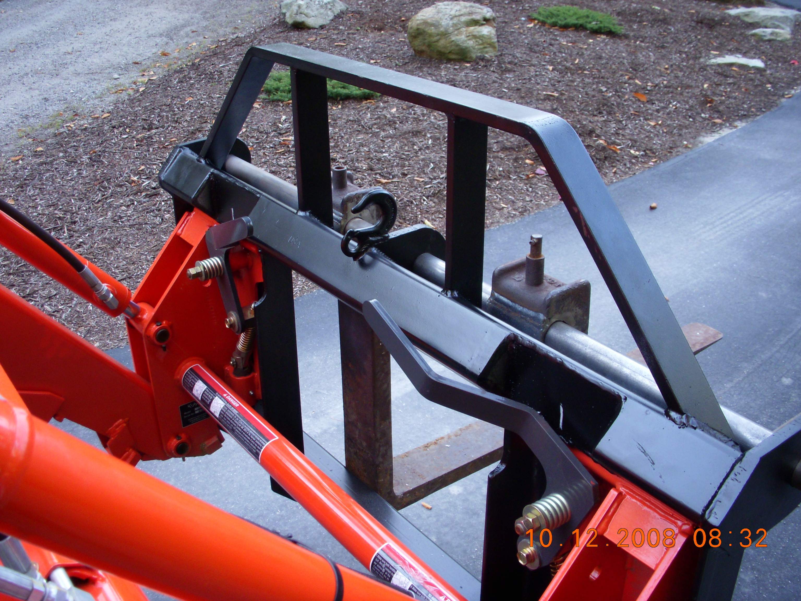

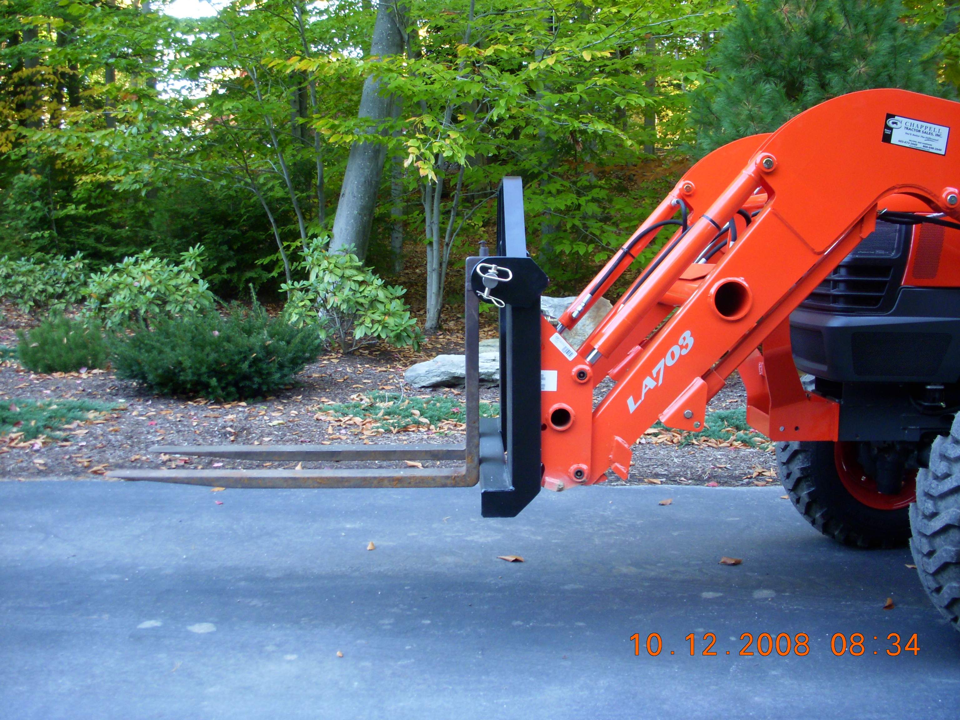

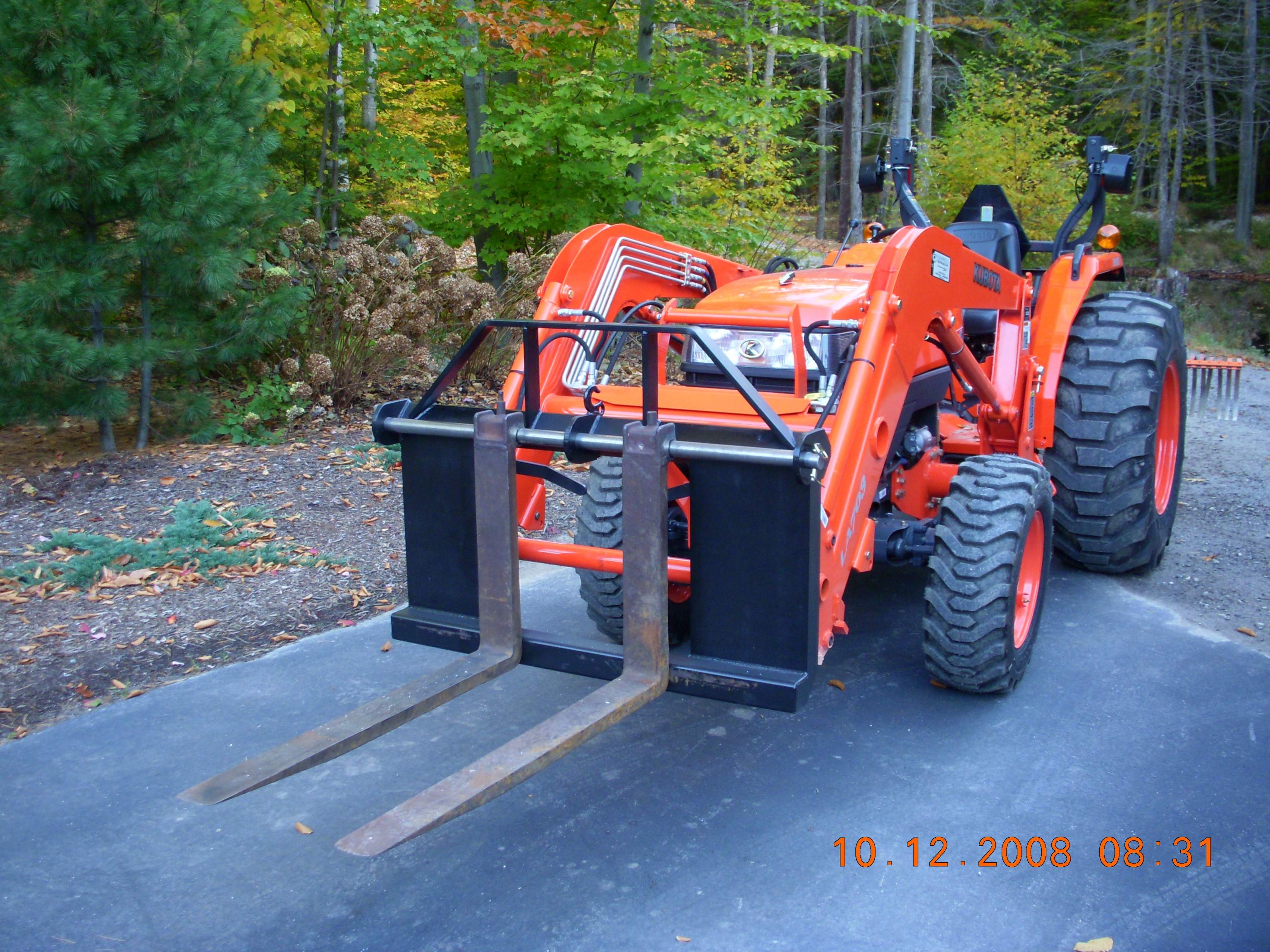

Found these forks on a scrap yard. They were worn out on the "heels", see pic, thinner in the back, does not matter for me, can lift 1500kg. Self made frame with Trima quick hitch. Wide frame, very stabil for lifting logs and lumber.

I'de like to see more details on this. Looks fairly easy to build. Have you got any plans or more pictures?

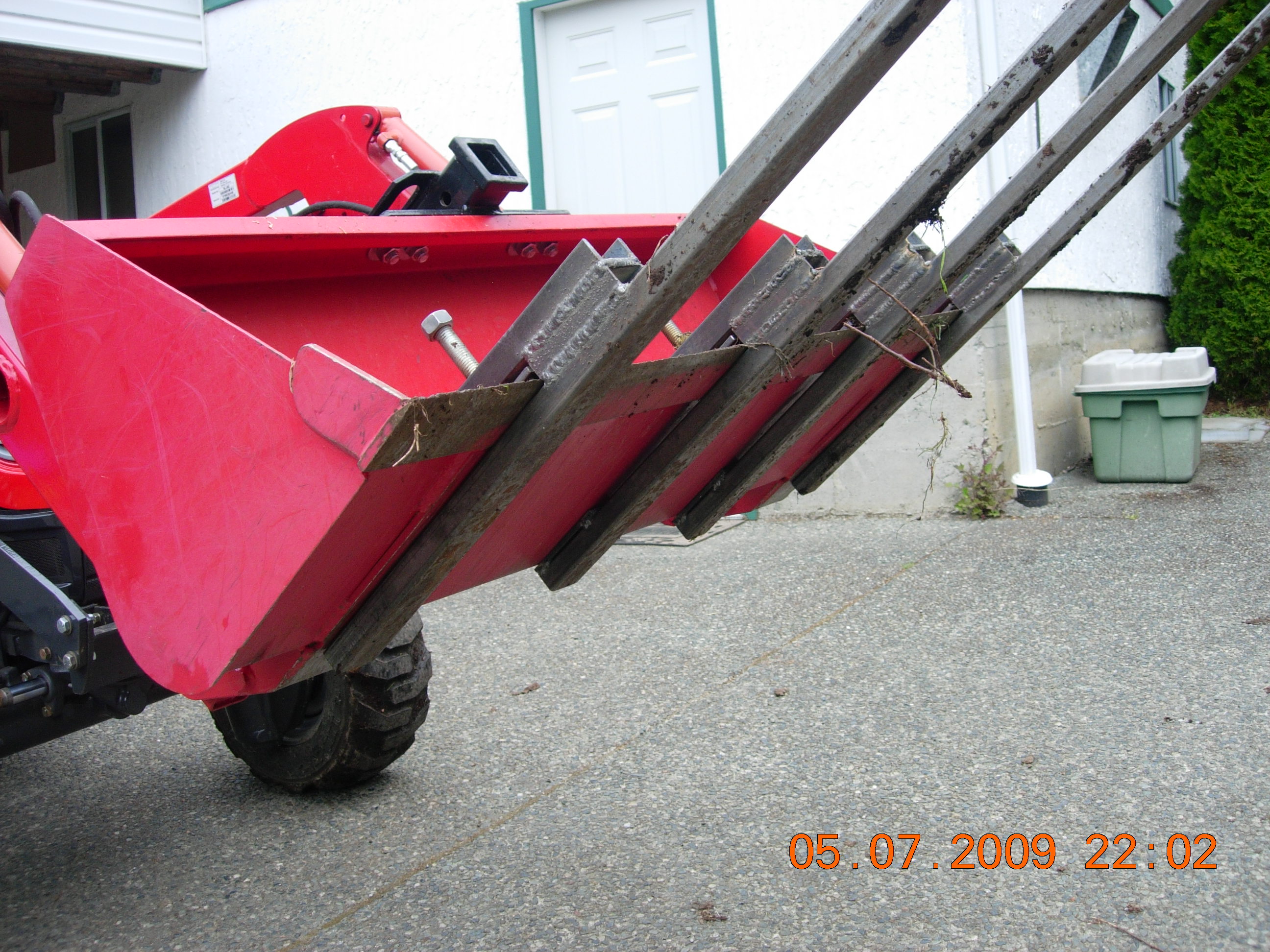

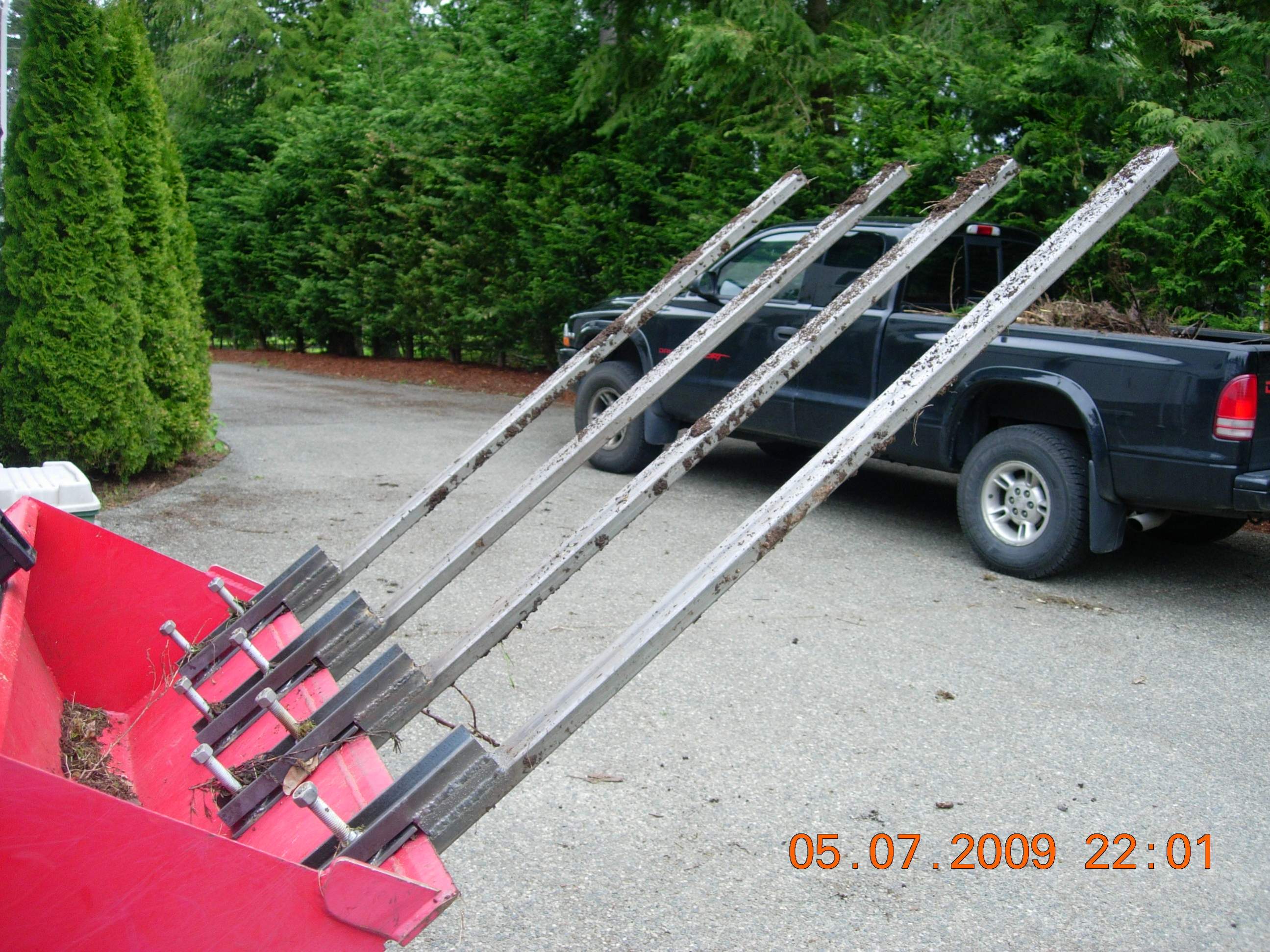

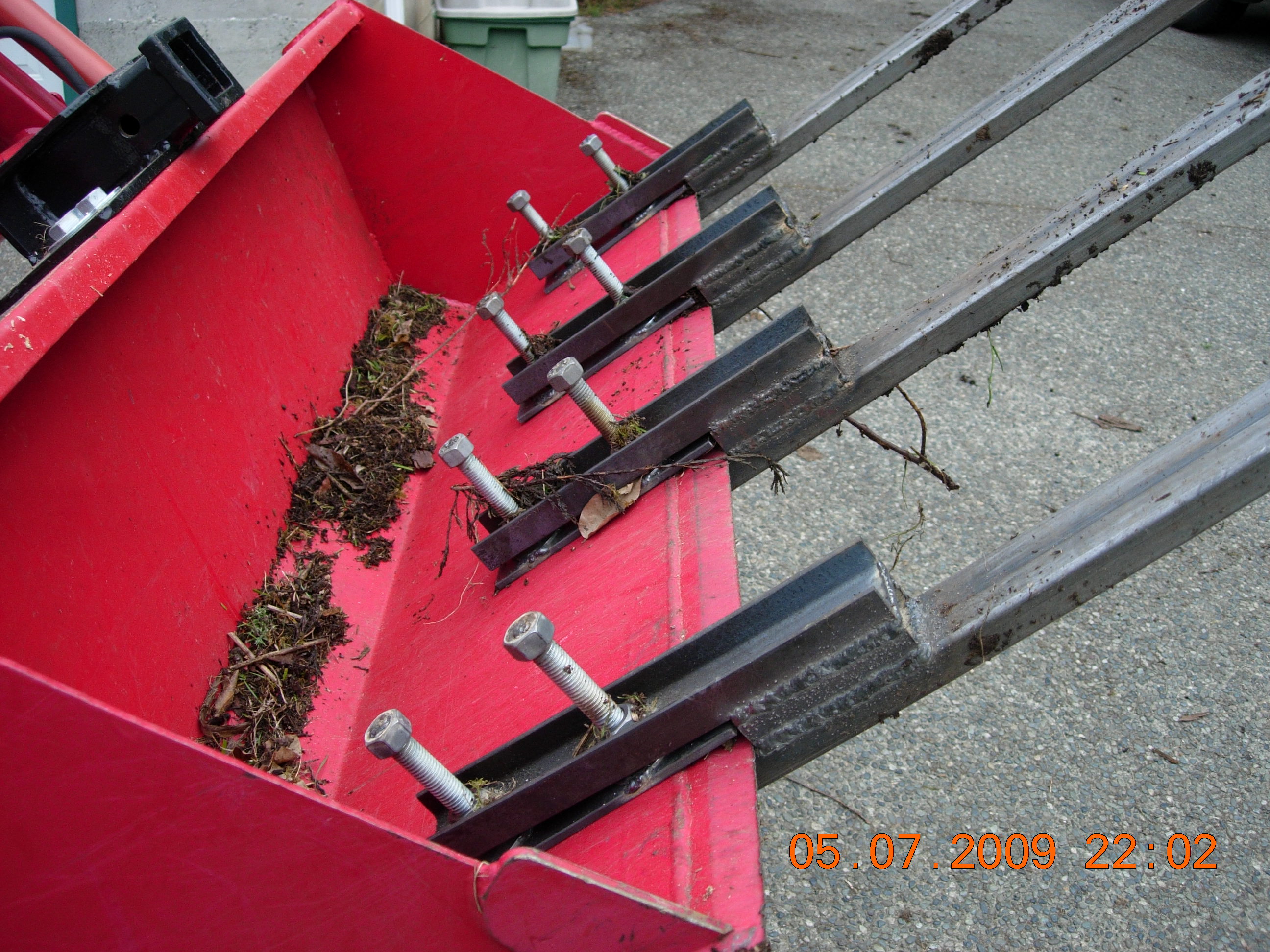

I got lots of ideas from this site.
I mainly wanted them to pick up brush.
This is what I came up with and they seem to work pretty well.

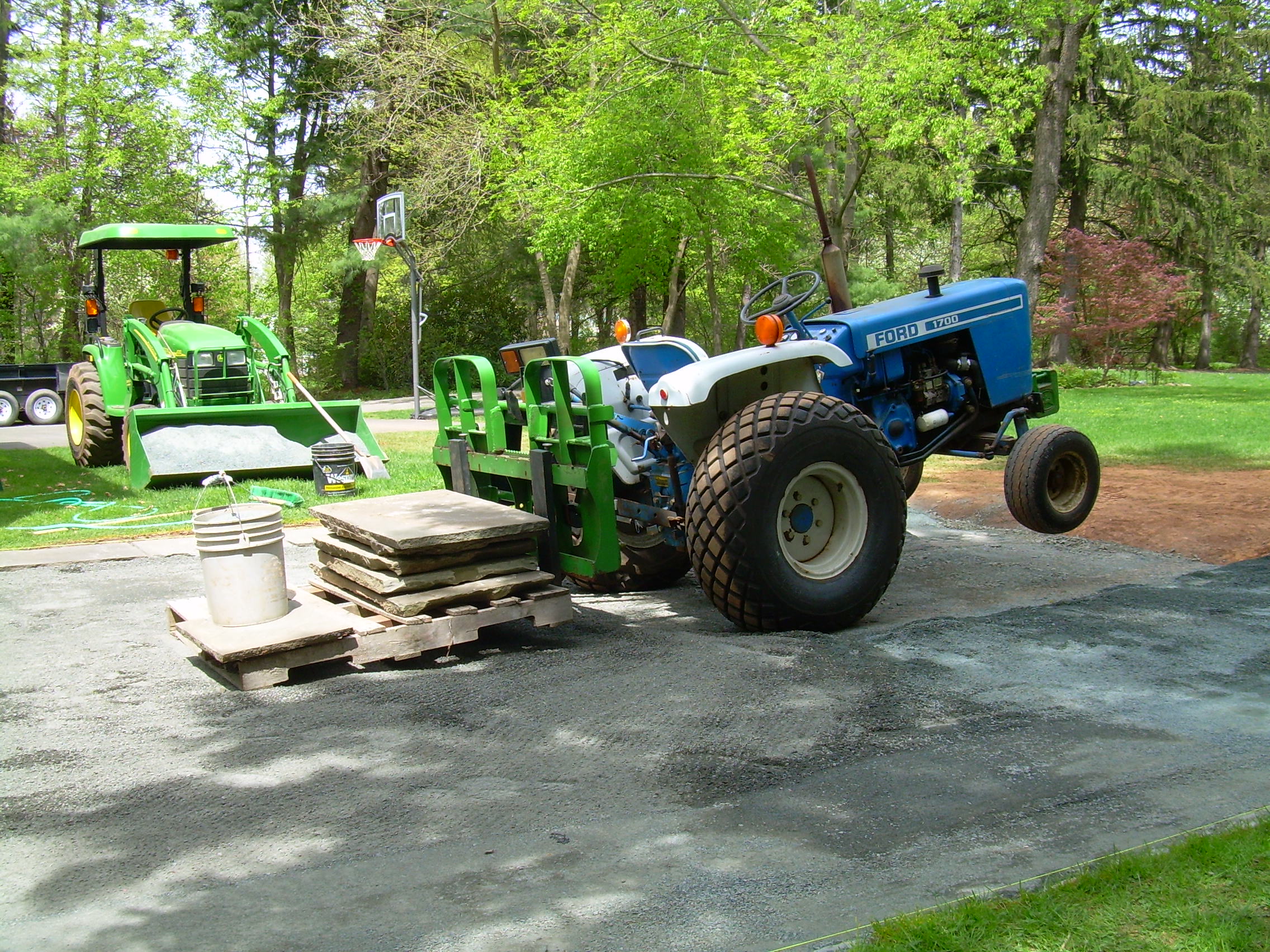

   / POST YOUR PICTURES OF FORKS? #98
Don't know if this thread is just for home made forks, but here are my factory built ones, been using them quite a bit lately.
Modded mine to work with JD and HF 3 pt quick hitches, the HTL on JD makes for very easy pallet engagement.
