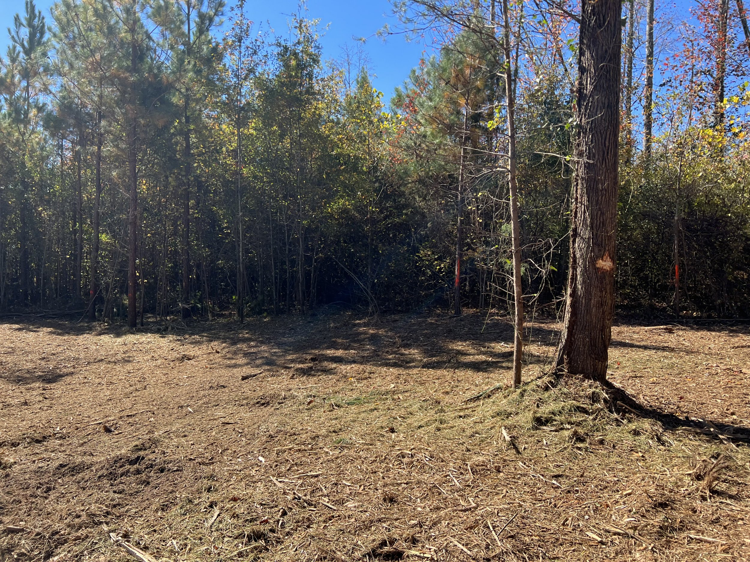

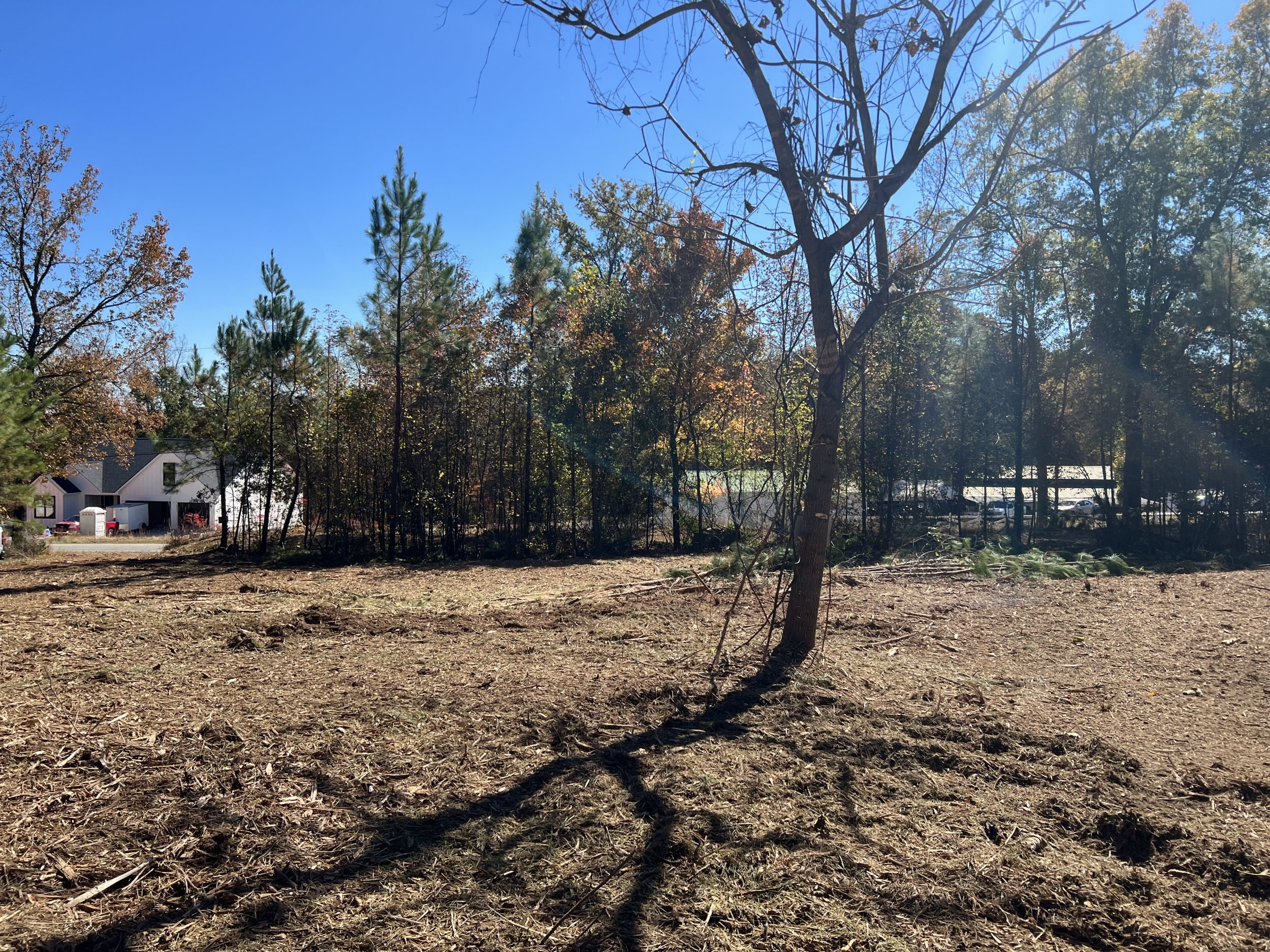

So I got a little work done at the property…
And I decided that the many small trees might be best handled by the titan post puller..
Anyone else have one?

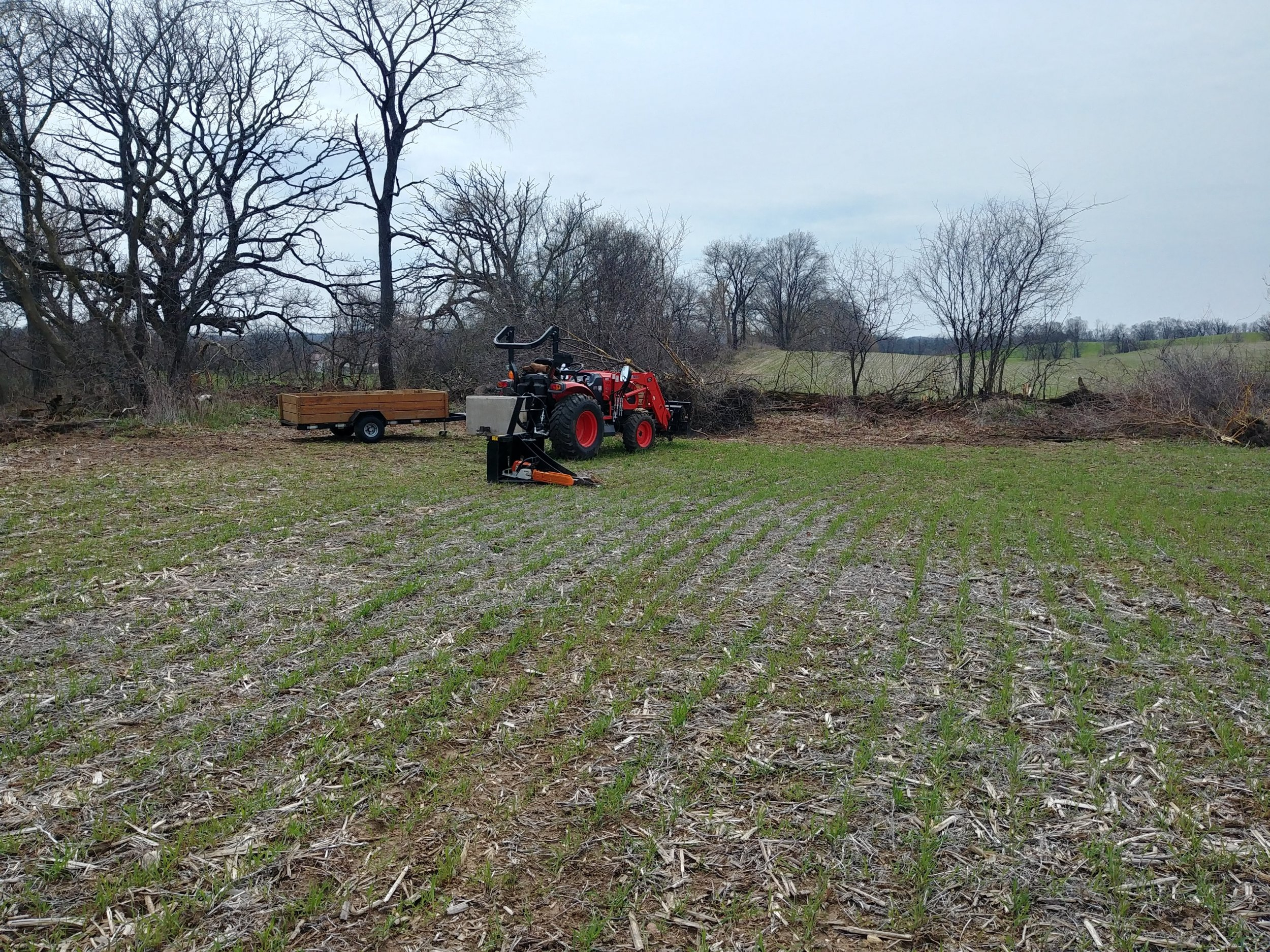

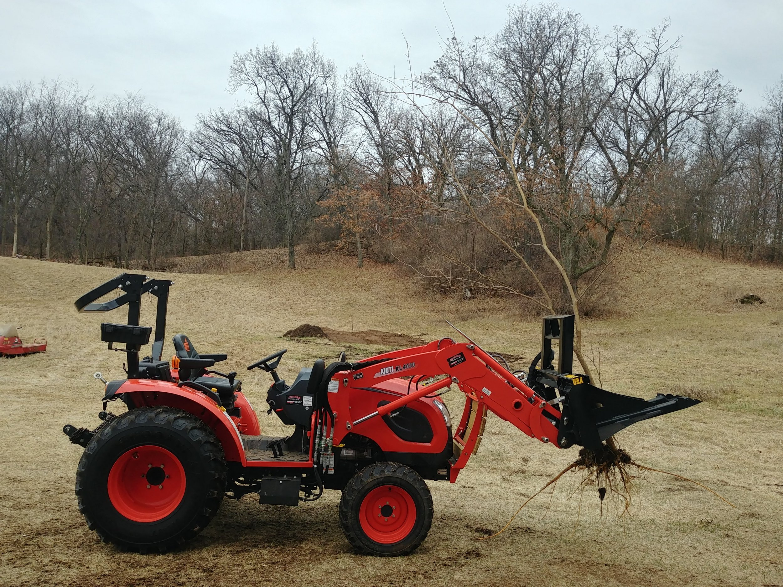

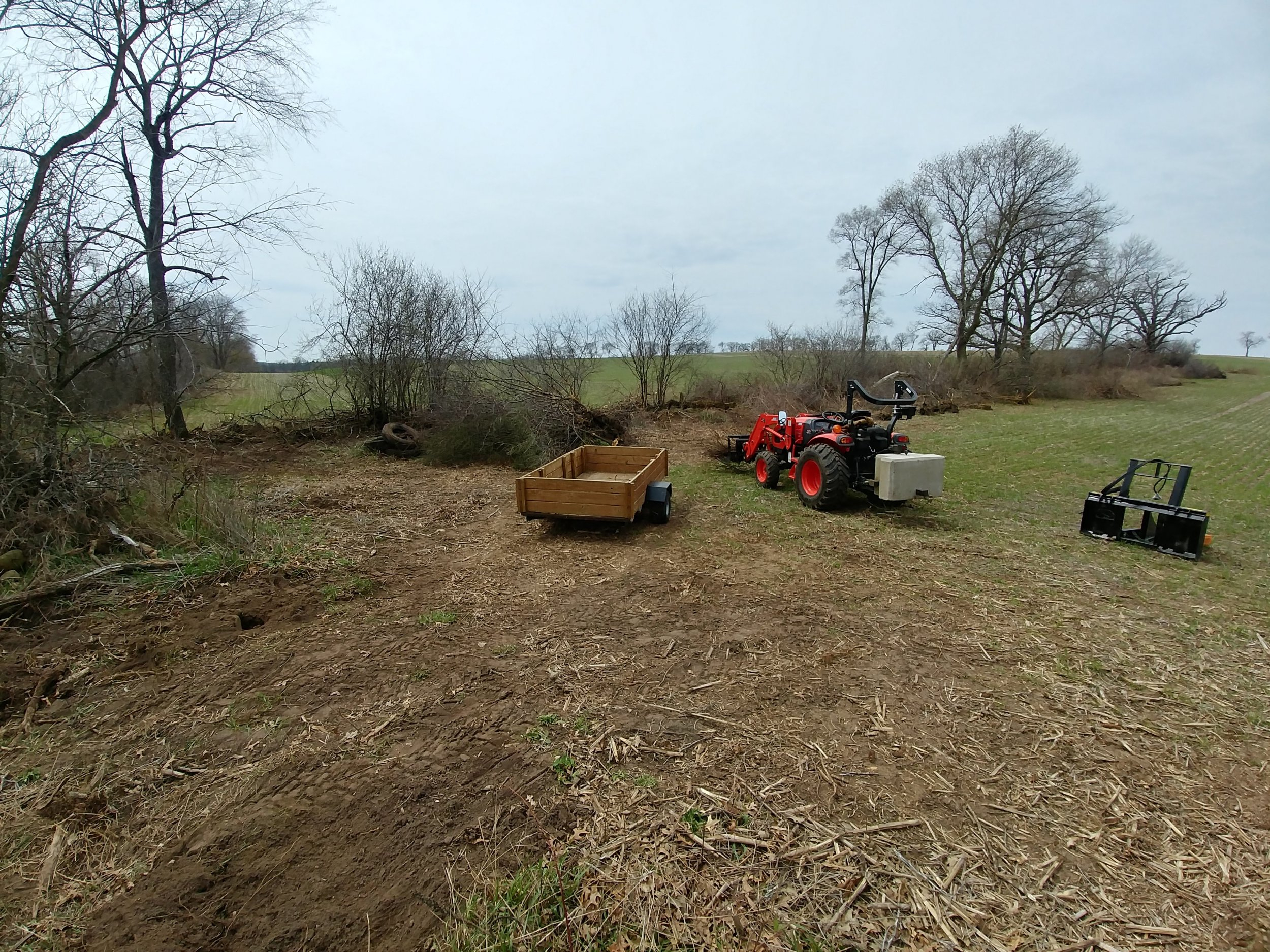

Ck4010hst, Stinger stp34 tree puller, 1000lb rear counterweight, CTA grapple
5"dia would be an upper limit using the tree puller. Buckthorns/honeysuckle/cherry come out fairly easy. Mulberries have extensive roots that will zipper out from a long ways away. Hackberry, oak, hickory, elm, have very deep strong roots and are impossible even when very small. Otherwise about 4" dia is a "practical" limit. Larger trees leave a large root ball divit (buckthorn), or a tangle of roots behind (mulberry). Just use a chainsaw for the bigger stuff.
The technique I finally settled on was to grab ahold about 4ft up, push and tilt the loader over to uproot half the roots, pull and tilt the loader back to pull out the other half, drag it all off and pile. Keep the 4wd off to remove the stress on the front end. Surprisingly, when it's bone dry out they pull the easiest. The roots at that time are desiccated and weak, and the dirt sifts off easily, root balls "can" stay very light and limited. We have a lot of brush and junk coming since we stopped pasturing 25yrs ago. At one point we used a skid steer to pinch the stuff out and push it off, but that left a fox hole like berm and a spot where more junk took root - repeat. Now we pull it, spray brush killer, one two punch.

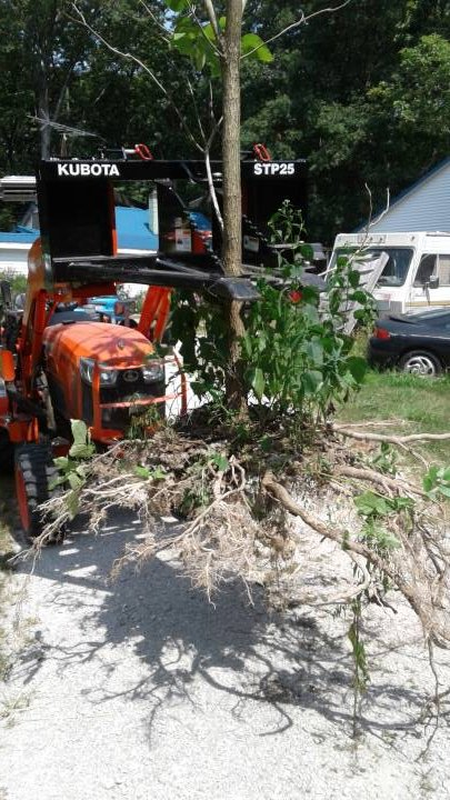

Have the STP25 with pusher bar attached. Trees vary but 3-4" is good on an MX5200 with loaded tires and an implement hanging for ballast. When doing a lot of little trees, grab one, then grab another and keep going till the teeth are full. Works good as long as you aren't coming out with a huge root ball for each.
