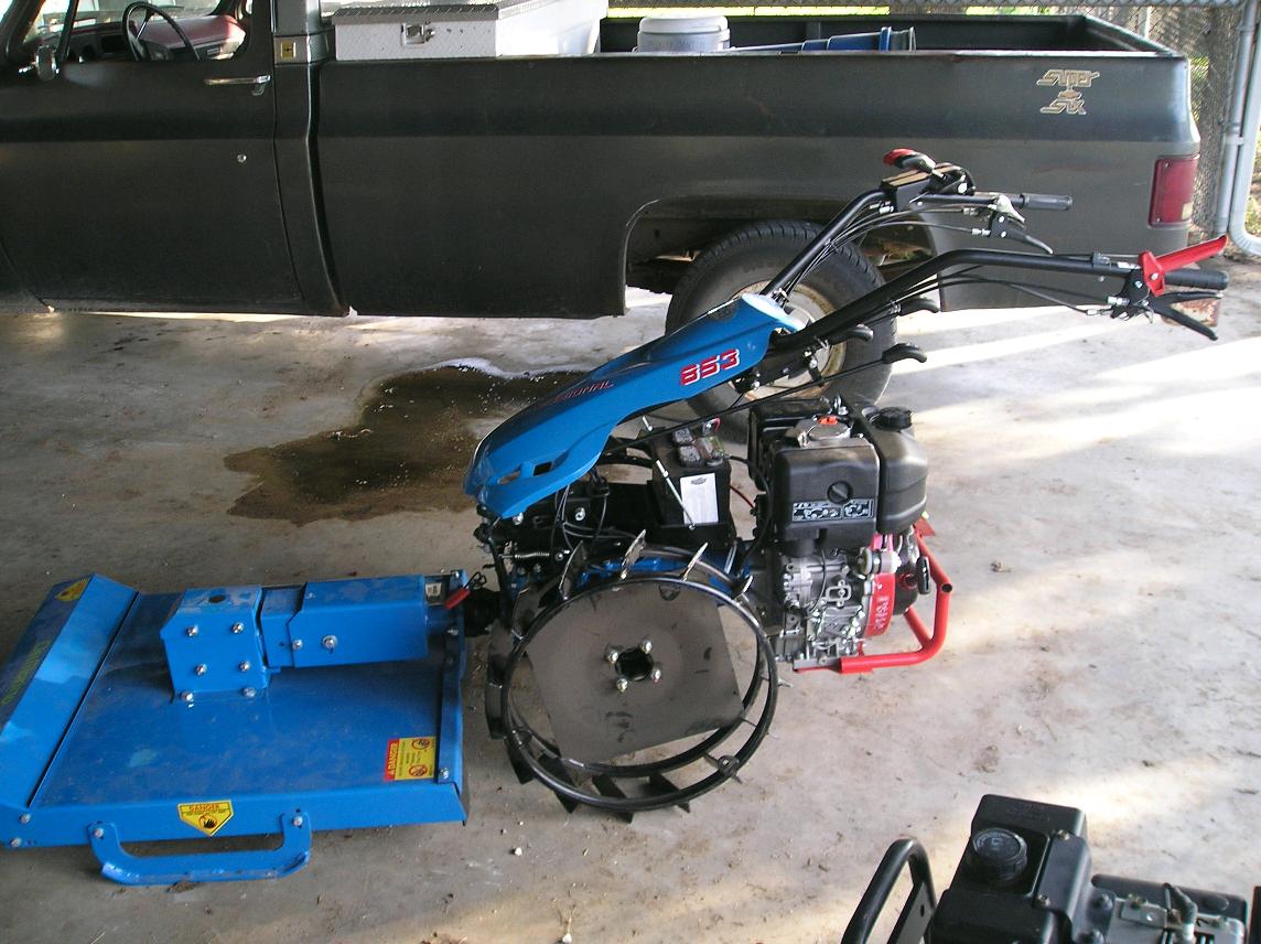

BCS 853 with 23" steel wheels and brush hog attachment. If you double click the thumbnail, I think it will reload the picture much larger.

Nice machine,, like the wheels!

Nice looking Lombardini diesel, Highsmith! Like you, I bought an 853 with 12 hp Lombardini diesel this past May from Earth Tools. It is a sweet running and powerful motor that does most tasks at half throttle or less.

With the wheels, looks like there'll be no stopping that monster in the brush, did you notice the floor, your Chevy P/U must have really got excited when you pulled that nice looking machin in beside it.:eek: Thanks for the picture.

Now are those the wheels from here?
Tractor Accessories
or did you fabricate a set of you own?
   / Post pics of your two wheeler #78
Mine came from Earth Tools.

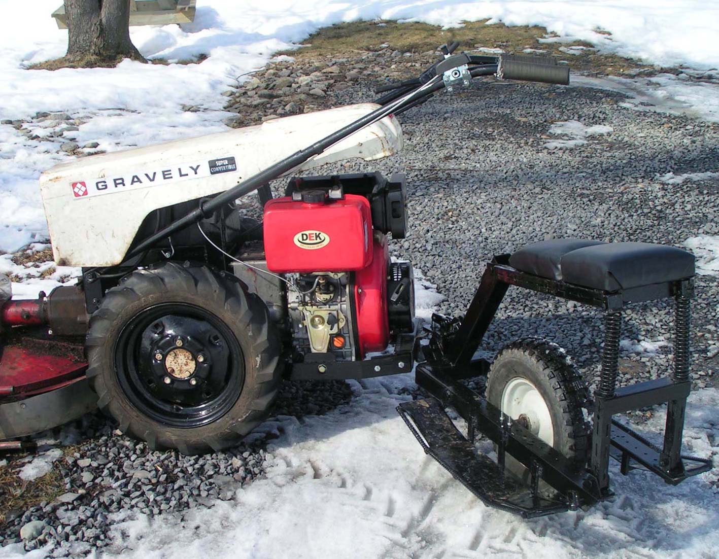

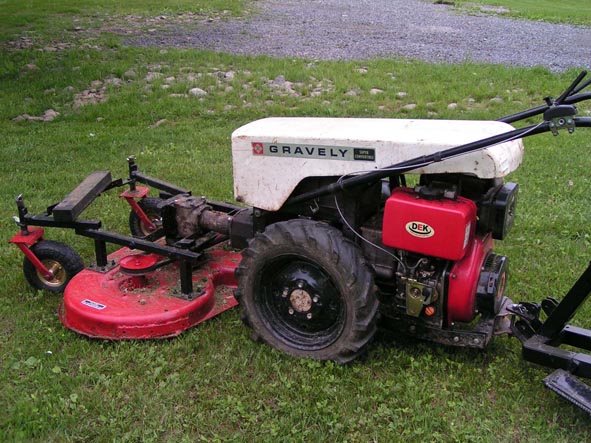

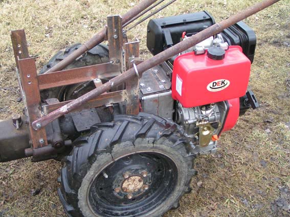

i like Oldmexh DIESEL Gravely. you it come like that or did you put that engine in?????
   / Post pics of your two wheeler #80
Hi! This is a Gravely L model 5 hp I install a Dek-diesel 10 hp . Not easy replace a Gravely engine because Crankshaft go in Planetary tranny. Now This Gravely run very well 180 hrs make . Very powerful run with about one liter fuel hour. I sold my Gravely L8. I prefer Gravely with reduction gears . bigger wheels more traction a little bit more slow. I join some pictures. Good luck ! Oldmech
