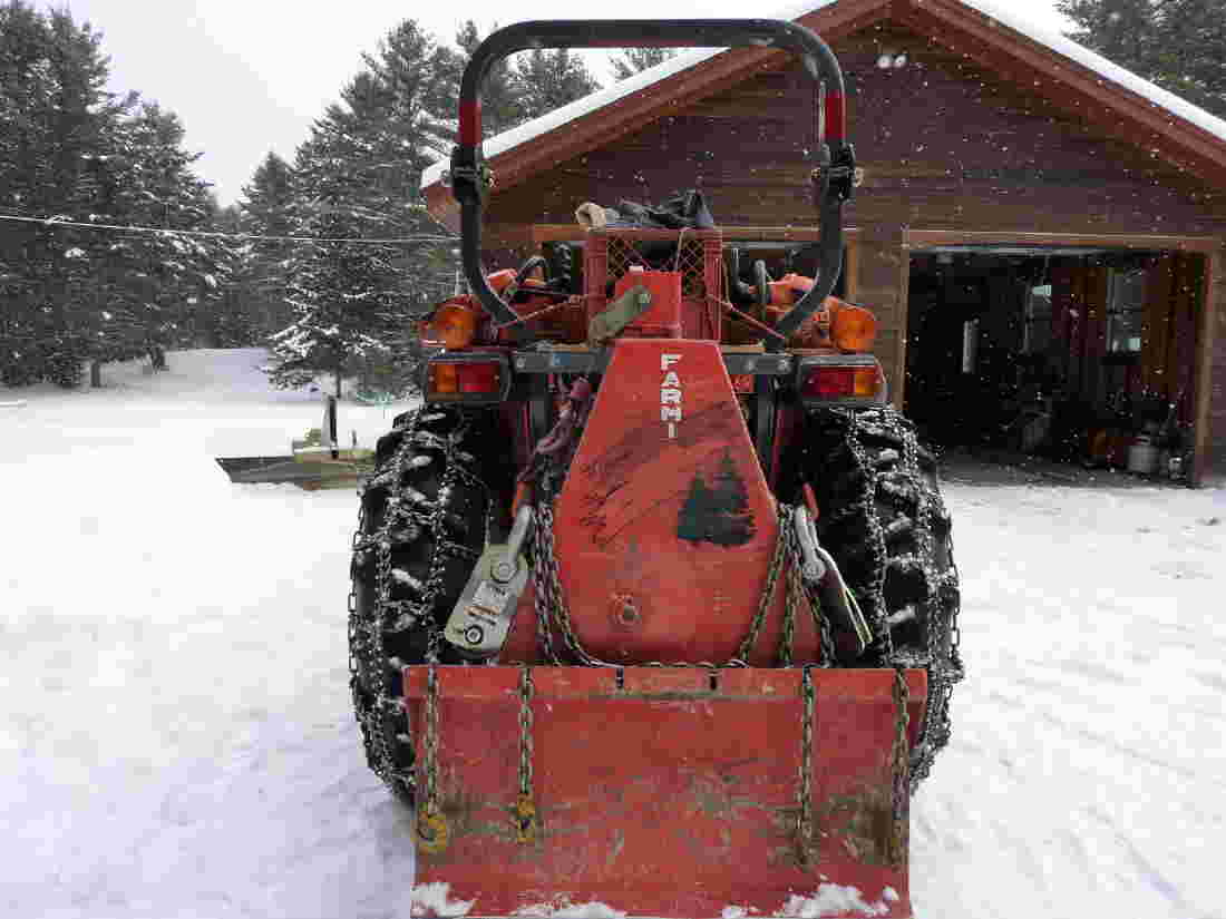

Thank you very much. When I purchased our Kubota 5740 last year I fabricated a similar one for it but this time I went with a bumper/shackle center design with quad flash L.E.D. oval strobe lights in it. I use the FEL tubes for tow slings and they are kept in there by machined aluminum caps that I made. You'll notice the caps on the FEL, they are black. Never enough room on a tractor but this system works for me :thumbsup:
For the longer items I needed to carry I went with these rubber clamps and this is how it looks.

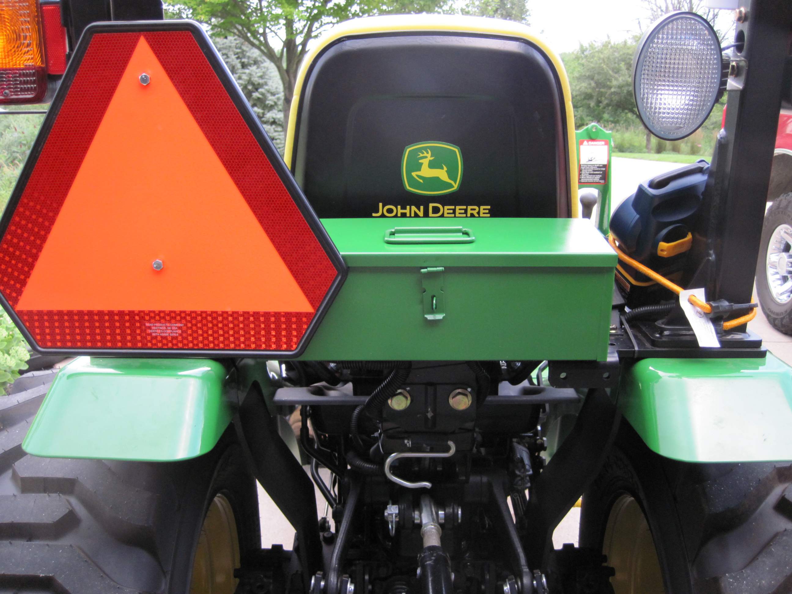

View attachment 279003View attachment 279004View attachment 279005View attachment 279007

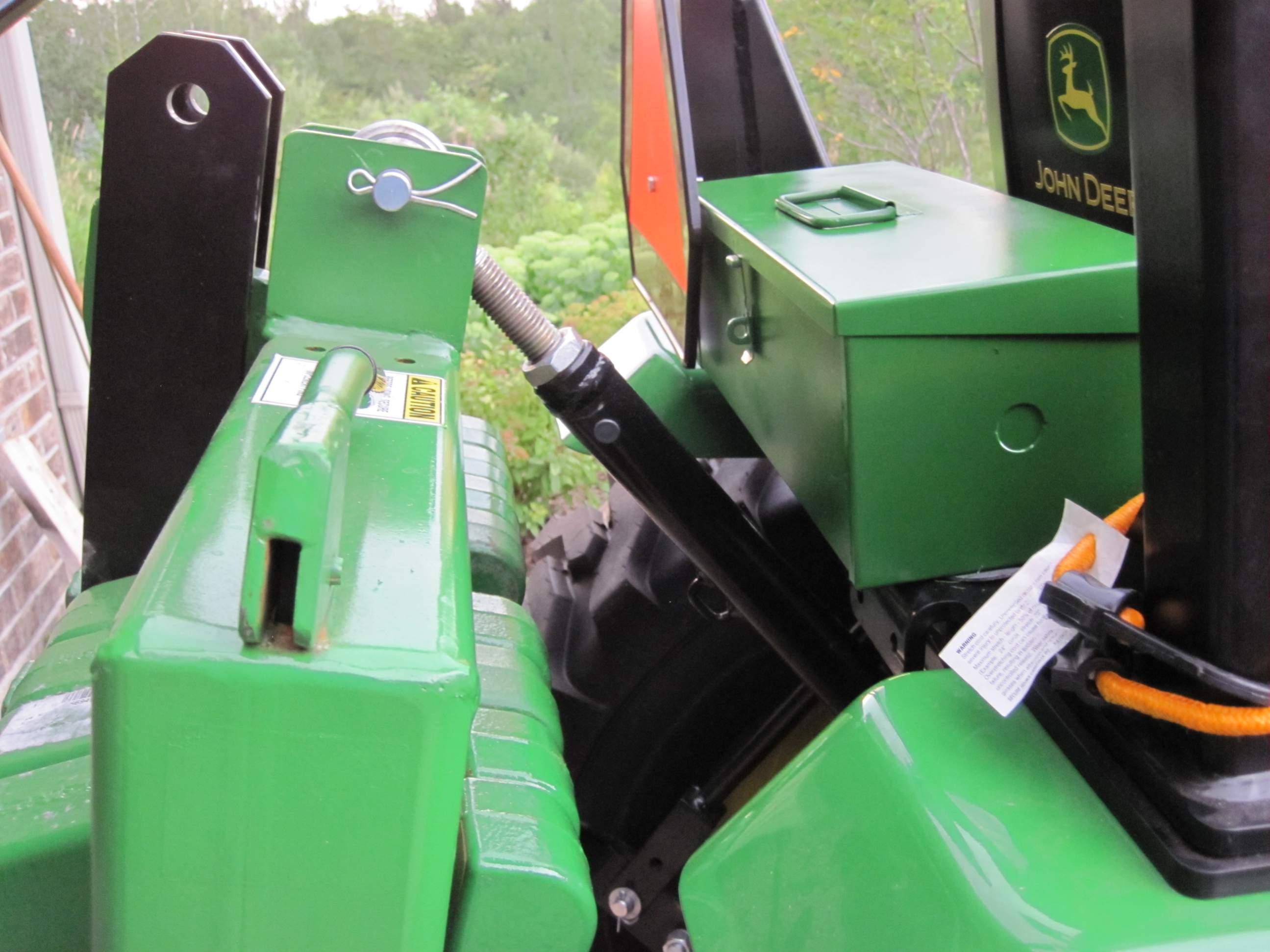

Good morning,

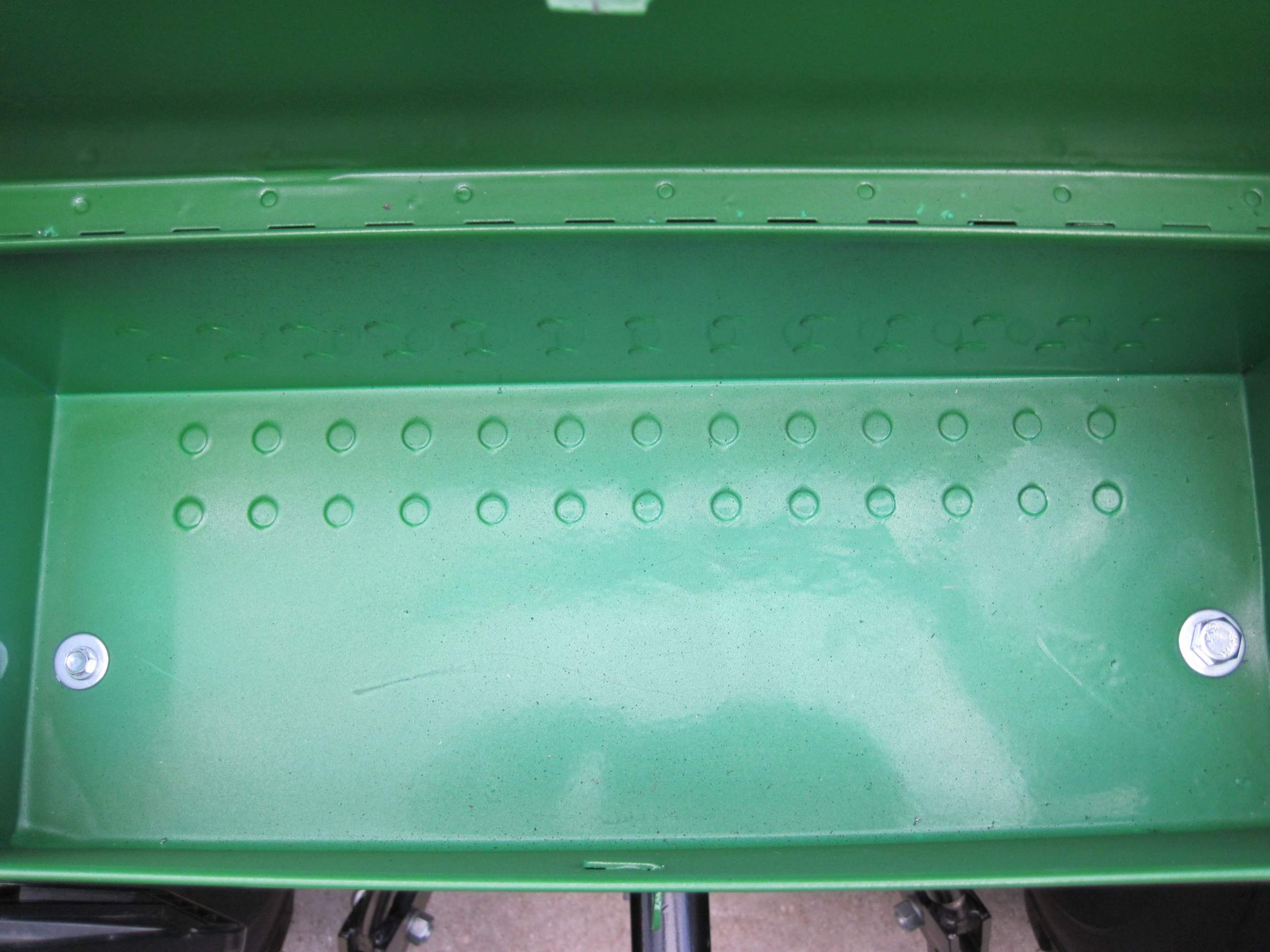

This is what we did for our 2520. I wanted something that mounted behind the seat yet did not create an interference with the seat or the 3 pt arm. My preference would have been plastic but I found this generic metal toolbox at our local Fleet Farm.
I did paint the box as the green on it was closer to an Oliver green vs JD. Not a big deal. The installation was quite basic in that I used an existing hole on the rear frame and then similar to the extinguisher mounting, drilled a hole on the left hand side and used a #12 self tapping screw. Once it was secured to the frame, I added a rubber mat at the bottom for less rattle. I did need to add some washers/spacers on the SMV sign in order that there would be no interference with the opening and closing of the lid.
The toolbox measures 16 x 6 x 6. The main reason for the toolbox was to have a place for my chain, my Kubota tow strap and a few tools (channel locks, vice-grip, & screwdrivers).
I love what you did. I have less space between the SMV sign and the back of the seat than you do, but I could shift a box to the right side. Thanks for sending the info.

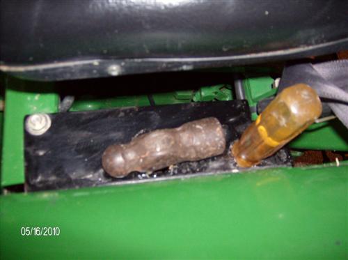

Plate w/ tubes for hammer & big screwdriver/prybar.

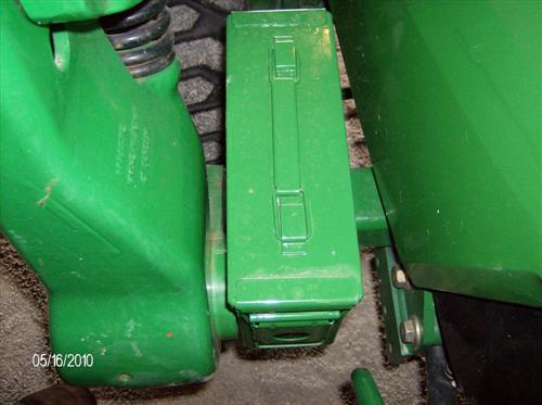

Ammo box clamped to loader frame.

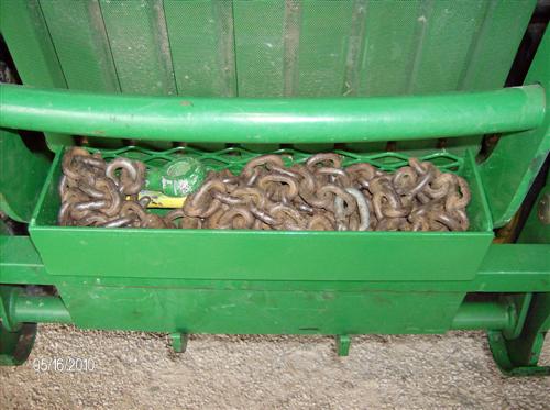

Chain tray between grille guard uprights.

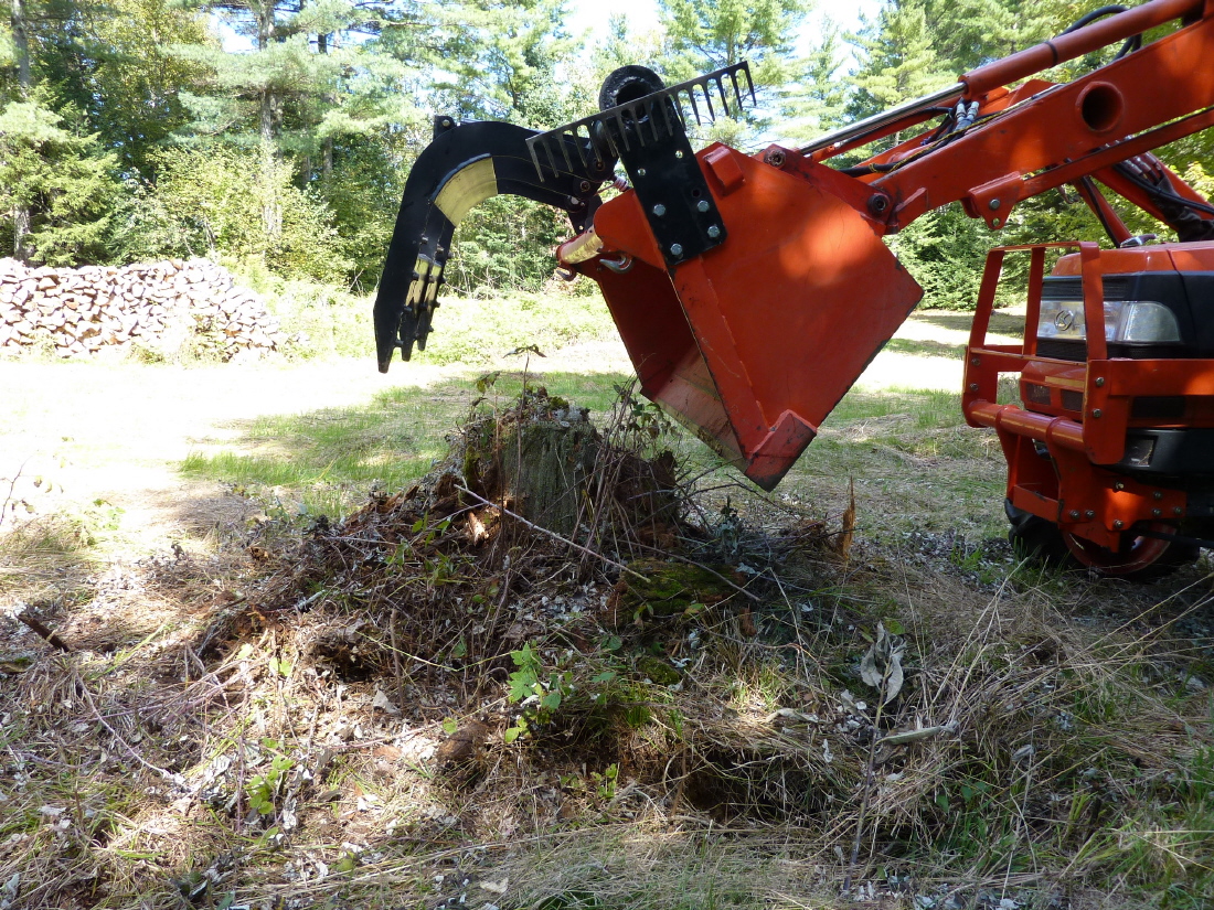

I keep a rake, peevy, or iron bar in the loader torque tube or the grapple tube. My not so fancy tool box sits on a shelf I put across the fenders and supported by two pieces of light angle sandwiched on the rops
