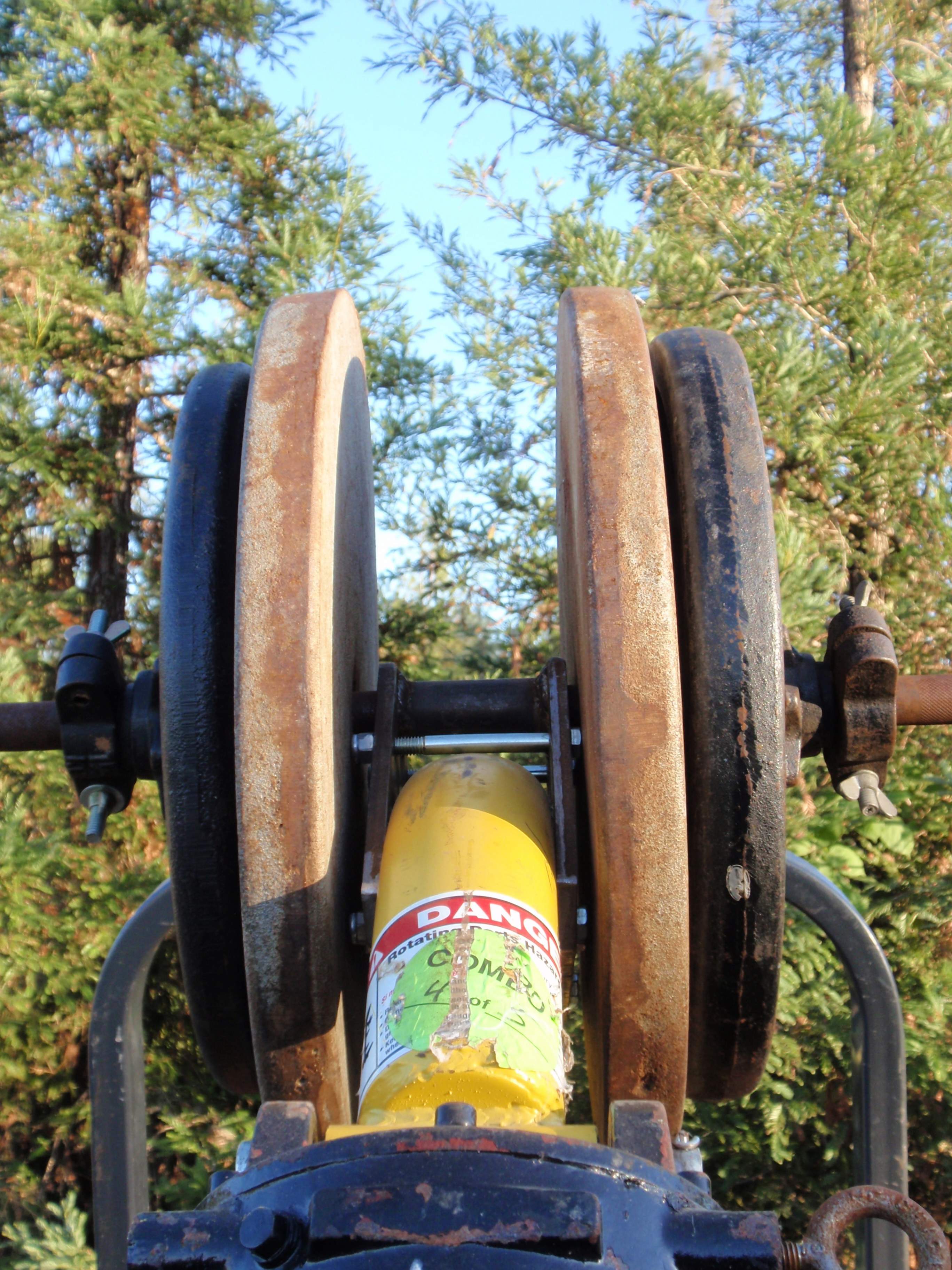

Pics continued from post @ end of previous page:
From the tractor.
From directly behind the gearbox.

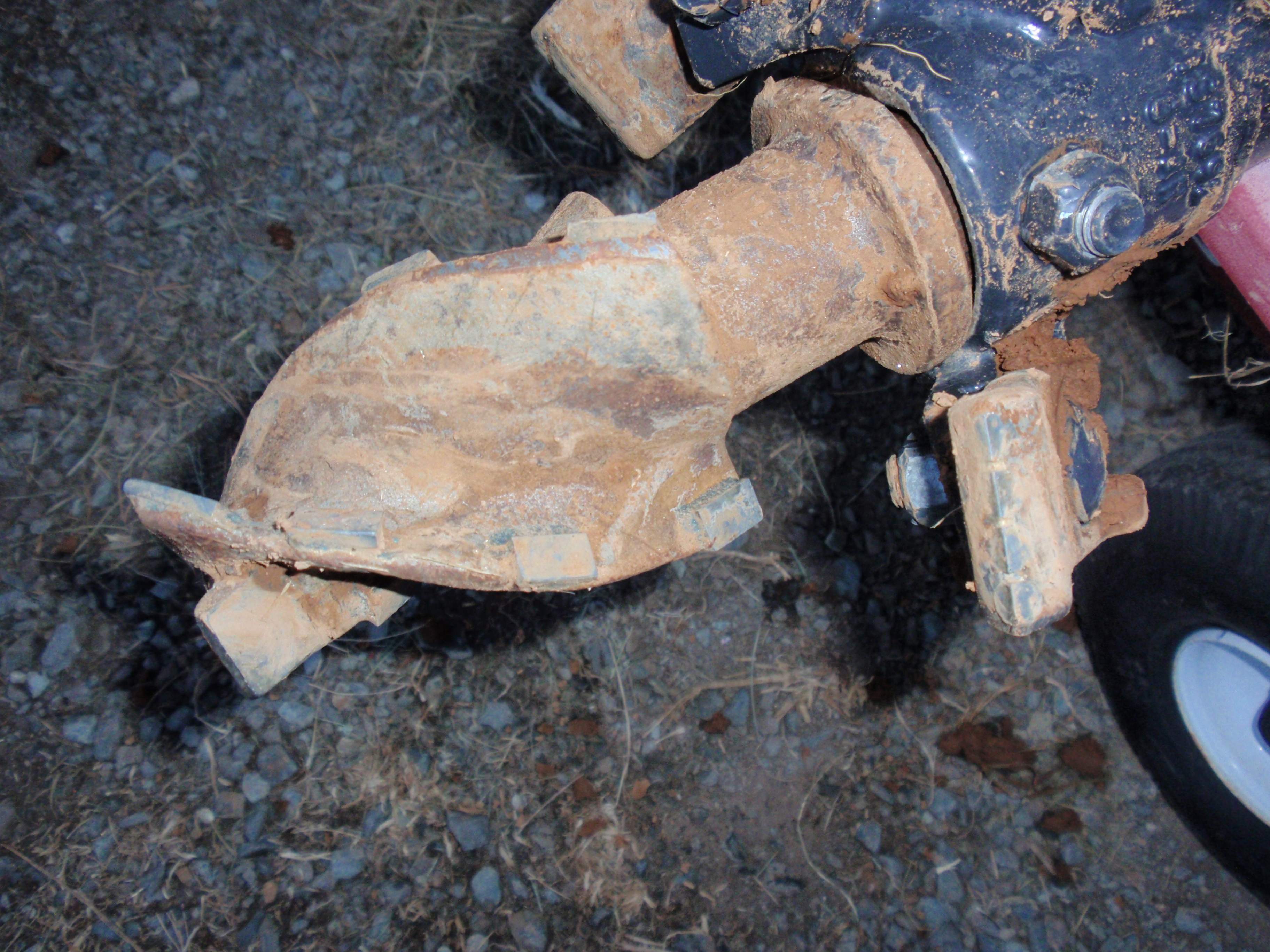

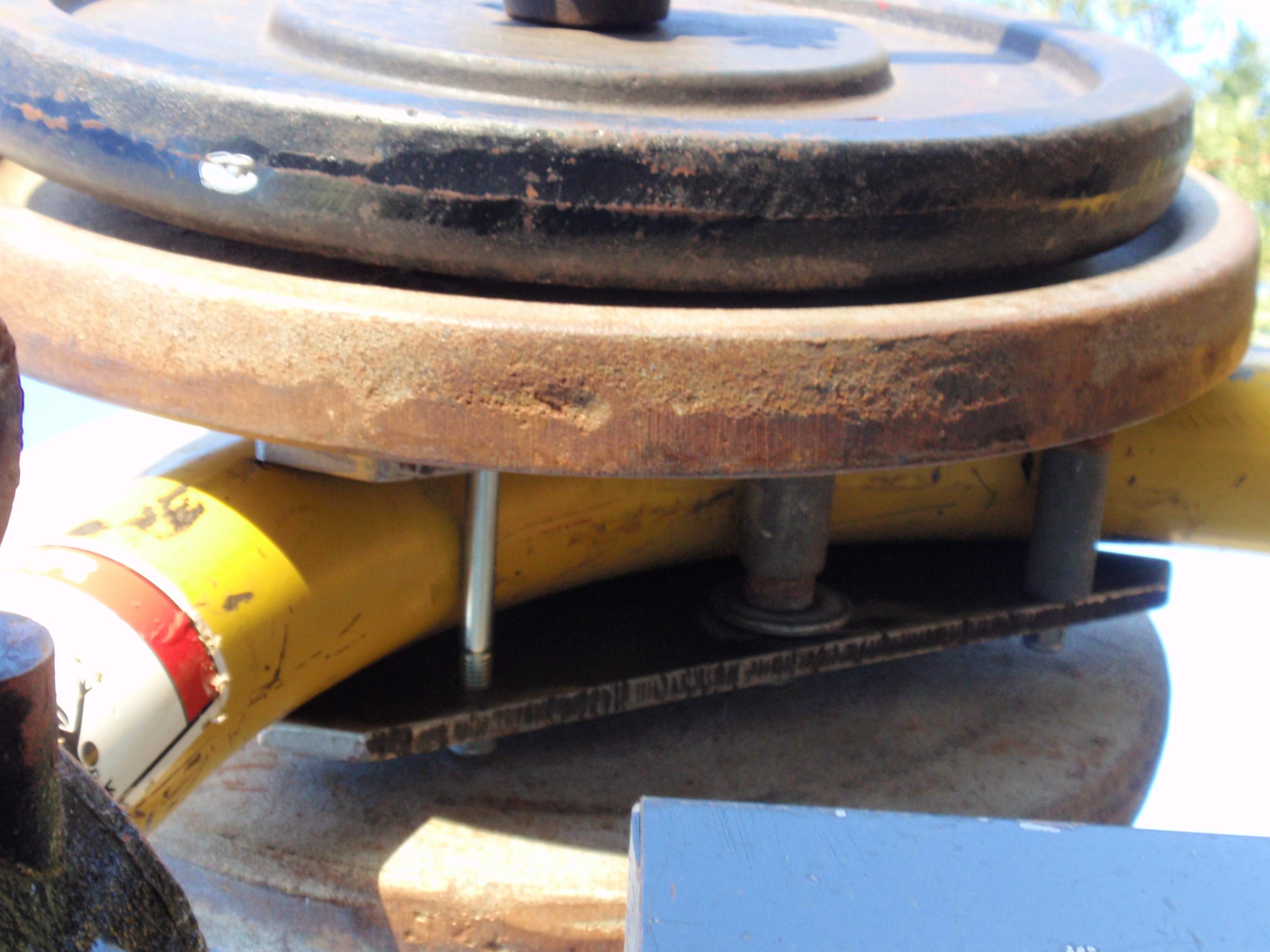

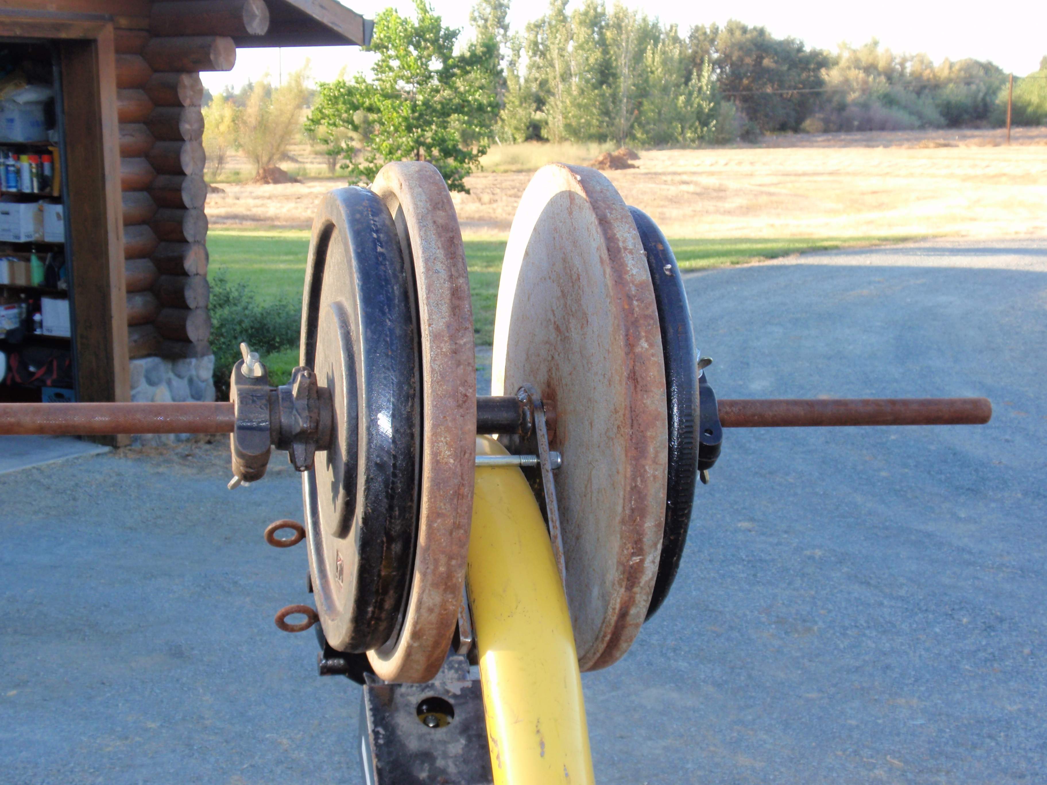

   / Post Hole Digger Warning #52
The machinist didn't get the holes alligned such that the bolts would be flush with the PHD frame so I used some galvanized pipe as bushing/spacers to tighten things up flush.
The Pengo carbide teeth and tip. Note the carbide studs on the side of the tip.

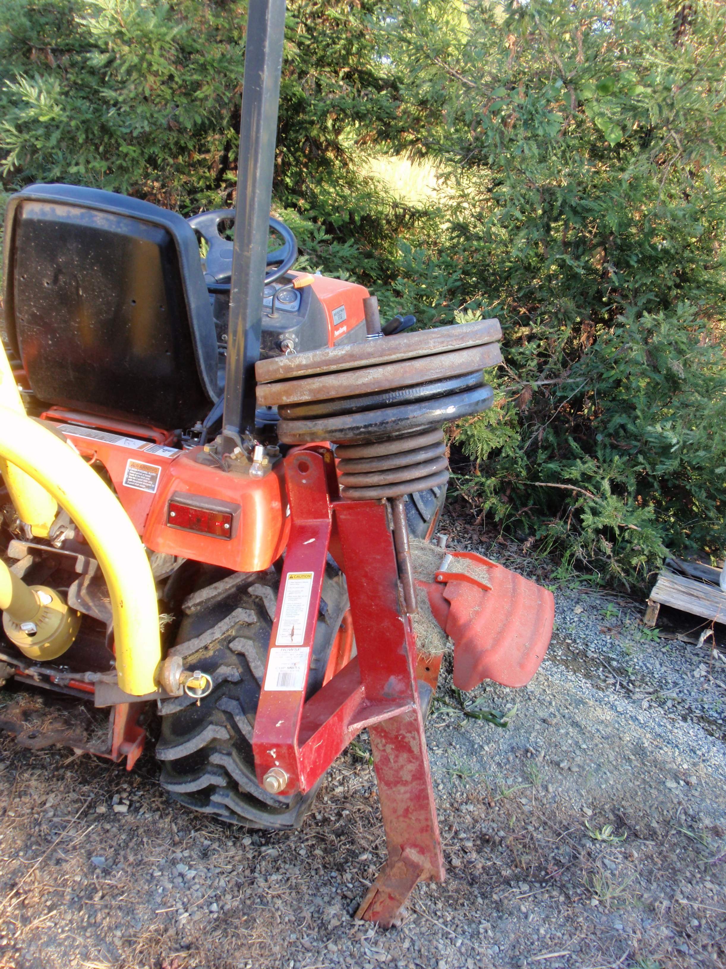

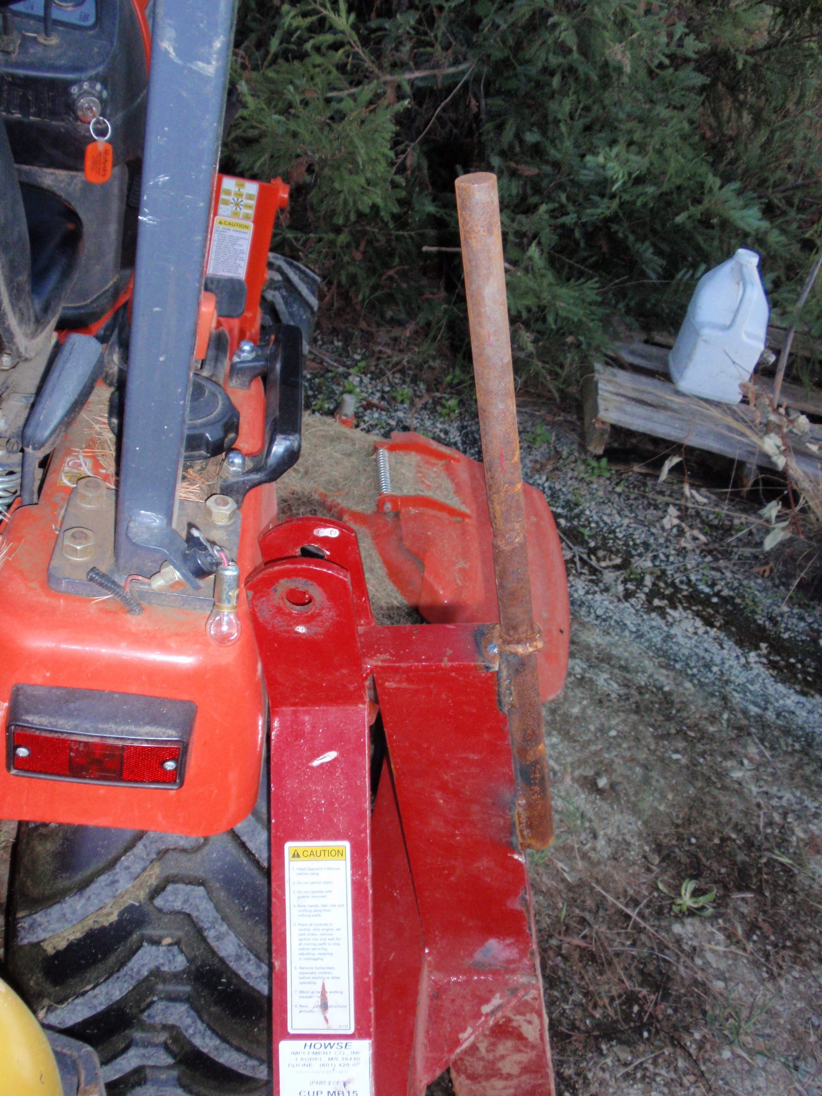

   / Post Hole Digger Warning #53
Last two:
Sub soiler with ballast.
Subsoiler without ballast so welds can be seen.

Tom,
Nice job with the weights, but {there is always a BUTT (-: }
Those look like HANDLES !!!
I would be SO TEMPTED to just hang from them, maybe even climb on the digger frame and lean out there.
Actually that would probably be safer, since any loose clothing would be farther from the rotating parts.
I think my tractor needs an "operator absent" cut off switch under the seat ?

Thanks for the compliment. As far as your warning, LOL, there's no way I'm gonna hang from or lean on that while that rig is turning.
