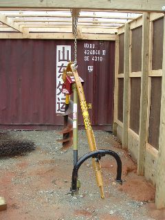

Has anyone made, or seen, or have a photograph, of a stand for a standard type post hole digger that holds it in position to hook up too the tractor?
I am familiar with the display type stands, that are used for selling and you see at the stores, but I am wanting something that I could back into, or under or something and hook the PHD into and then disconnect from the tractor.
My current plan calls for 4 legs and a frame with 2 chains hanging off, and two eyes welded onto the PHD boom. Back into position, attatch chains to boom, then lower slightly so that the frame is holding the PHD and then disconnect.
We switch between PHD and BB and Rake frequently and looking for ways to make this easier.
I did do a search and was not able to find it. If I missed something, please steer me in the correct direction.
Thanks

I hung mine from a rafter. I doubled it up with a piece of half inch plywood in between. Then I looped a chain around it and put a hook on the end.
I can put my PHD on by myself fairly quickly now.

Well, I need to go back to computer 101. That is exactly what I was looking for and am not sure why I was striking out on Searches.
Thanks for showing me those, and I apologize for not finding them. But I will spend a bit of time and see where I am going astray as I know where they are at now.
I think I will do mine slightly different than most in that I hope to hang from 2 points, then it will be sitting in "hookup" position.
It did kind of kill me when I saw the one made from a swing set. In the know bull, it really happened, I gave away that exact same swingset about 2 weeks ago. Had I thought a little more, it would have become a PHD stand /forums/images/graemlins/shocked.gif
Live and learn.
Thanks again. Will post picks if and when I get it done.

Mine is basically L channel rectangle with two uprights to capture the lower links on one side and a 1" piece of round tube on the other to catch the bit holder. So if you looked at the PHD from the side the business end sits low and the lower links sit up about 6". Basically it puts the top link about 1" low of the mount and this works pretty well. I still want to make two holders for my bits and a small cradle for the drive shaft. But that will be on the list of stuff to do.

I made a rolling stand out of doubled up 2x4's for a base and uprights. I back the tractor up to it, then wrap a chain around the PHD.
