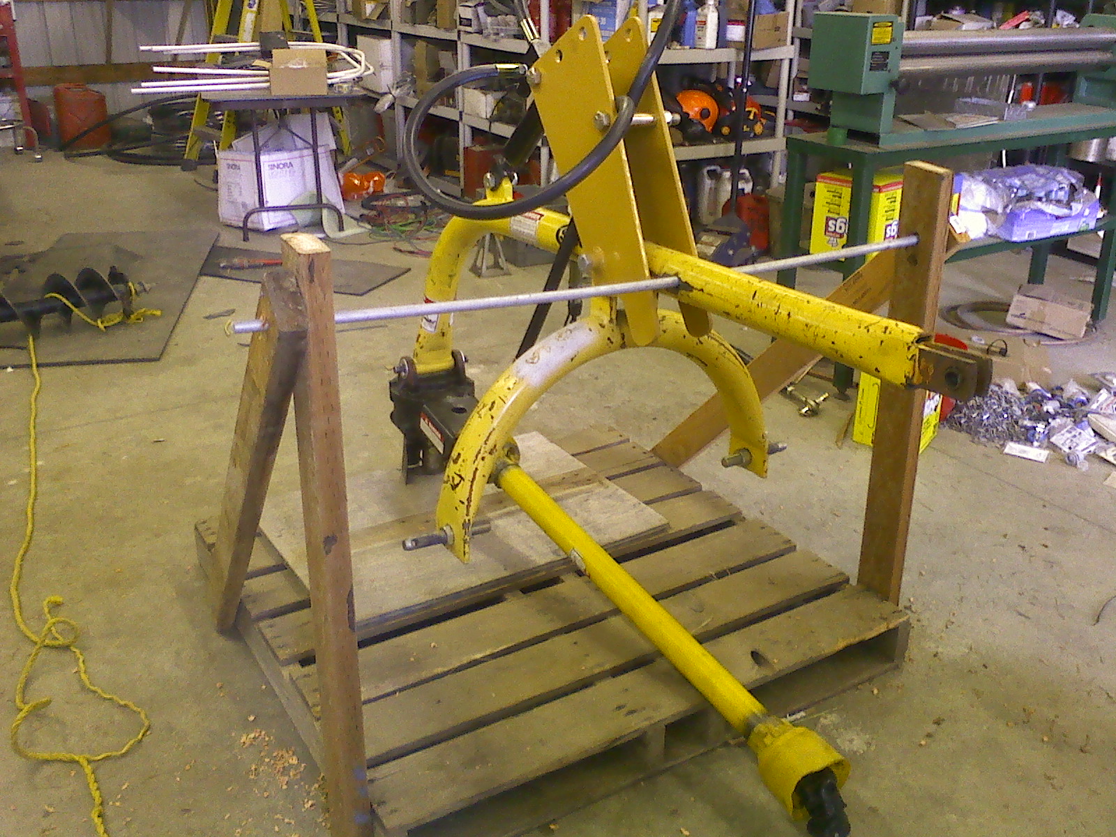

i have a speeco h.d. post hole digger. need to build stand for it.. any suggestions as to how build one thanks

Any I've seen are made from two A frames and a support beam between them with some angle bracing from the beam to the A frames.

I tried stands for mine and finally gave up. While they do work, it wound up being more of a hassle for me. Instead I just take the auger off and let the remainder of the unit down onto a thick pallet so it's easy to hook up. It seems to work for me and it not too difficult to hook up next time around..

Since I had the PHD on the tractor, and some old posts available, I dug two holes, about 3" apart, set the posts. The top of the posts are just right (dug the holes to make it so) to lay a 2x4 on edge across the tops under the arm on the PHD, essentially hanging it there. I loosely attach the PHD PTO shaft to the frame to keep it from dropping in the dirt. Works for me.

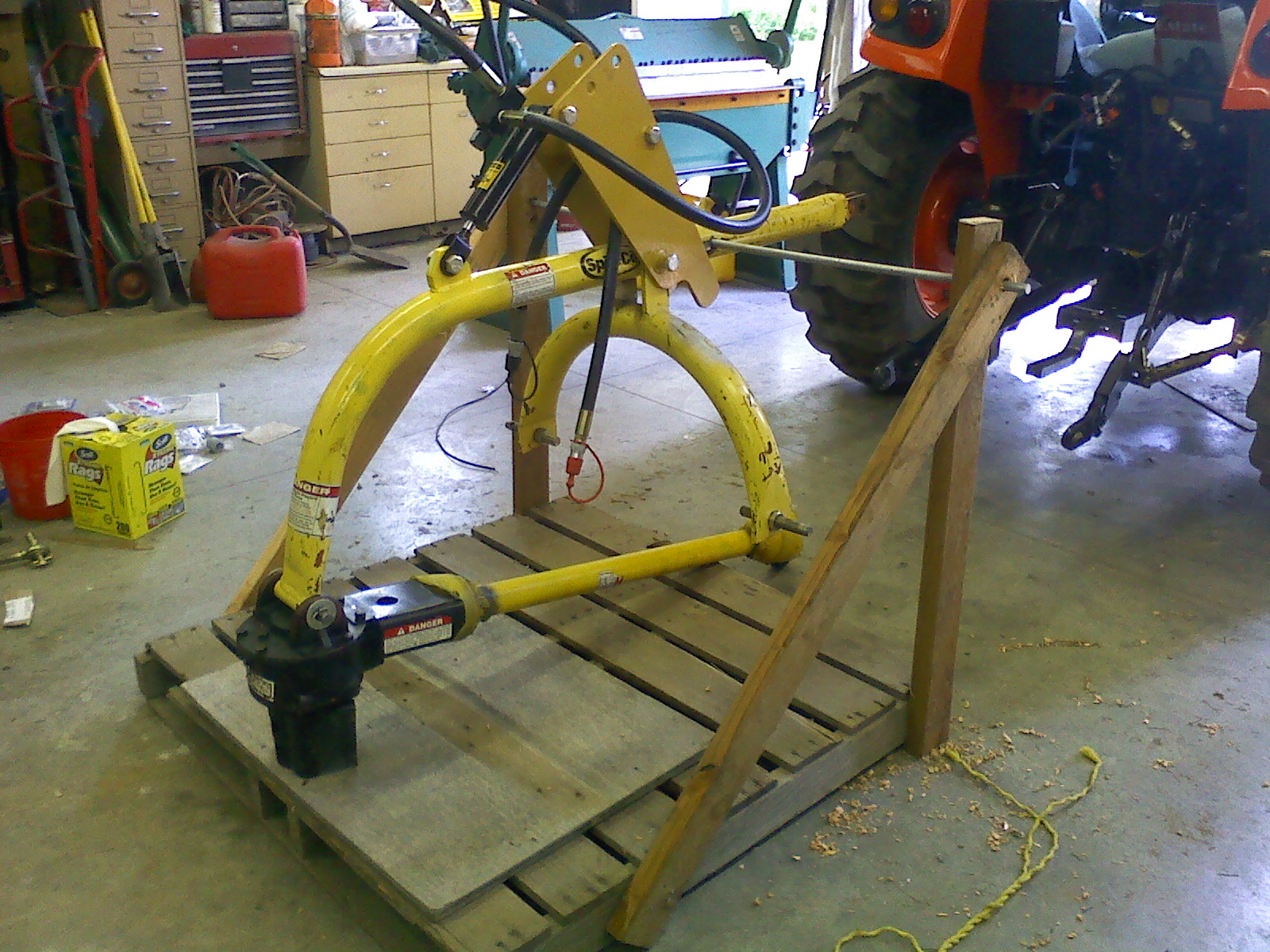

This is a simple one i built. I can now move it with my tractors forks and can easily attach it... PLUS it was CHEAP top build with scrap wood. Mines a Speeco with hydraulic assist . I used to leave the auger installed, but it always gets in the way. It hooks up in a few minutes so what the heck. Plus now im forced to verify that the bolts are tight. I was also thinking of making a grade 8 pin to replace the bolts. And use latch pins to secure. Would be real easy to do, but i am a lazy sort. Will be a winter project i guess

Is your digger a facory original or did you add the cylinder to it?
How well does it work and what kind of ground do you dig in?

Is your digger a factory original or did you add the cylinder to it?
I added the pressure down system to it earlier this year. Ground is decomposed granite and is hard digging. The hydraulic assist adds a few hundred pounds down pressure and it really helps me dig the holes when the ground is dry.
How does that hydrolic assist work???
It has positive down pressure, but automatically releases all pressure when i raise the boom. Its a single acting cyllinder. Its amazing on how much it helps get hole started.
I used to get stuck trying to get holes started, would have to stop snd use pry bar to disloge a rock or get a small hole started. Or have someone help push down on pry bar to assist (very dangerous). With this .... No more problems.
I have to use it to set new fence next month on the 10 acres we purchased accross the street last month. Will get a workout
