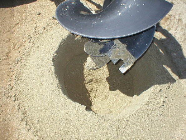

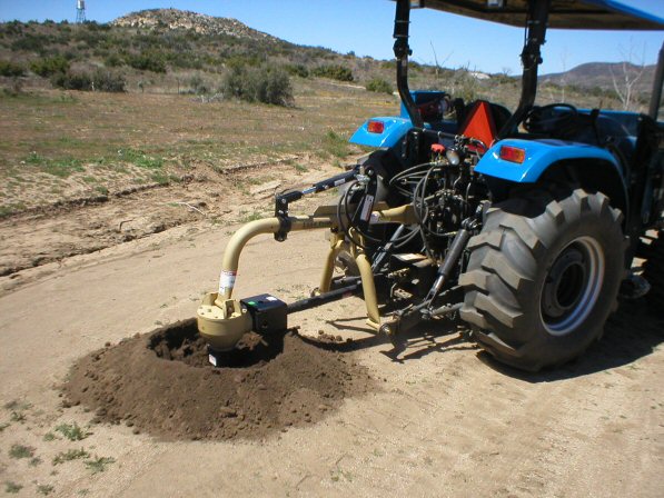

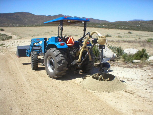

Pat, the down force option is great. A few weeks ago I drilled a seven holes that in the past some of them would have taken a lot of time and water.:( I drilled each of these holes in about a minute, maybe 90 seconds at the most.:D 24 inch tree auger, about 42 inches deep. The first 2 pics are of the same hole. The auger would only go in about 4-6 inches, (center point depth) very hard decomposed granite. Put the down pressure on and the auger went in like it did in the 3rd pic.(top soil) Amazing what a little hydraulic pressure will do. :rolleyes:
Those pictures are very impressive... looks like a Landpride Unit?
Thanks for the user report. As I said, I thought I might want that but your report has pushed me over the top. I WANT DOWN PRESSURE!!
Yep, Land Pride PD35. I am a weekend warrior, and one weekend I spent more than a day trying to put in a few 18" holes. :( Before I went home I put 40 gallons of water in 2 that I could not get down much more than two feet. During the week I made a stop by the local John Deere - Land Pride dealer and ordered the down force kit. With a limited amount of time to get things done, I just don't have the time to fool with a few holes most of a weekend. Finished the holes the next weekend without the down force kit, (3 week delivery time) but from then on, I have been able to drill a hole when and where I want to.:D

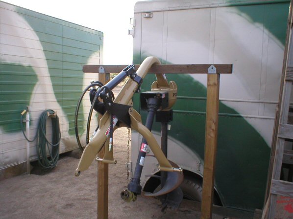

Oh, don't know about anyone else, but I learned the hard way that you need to put the down force kit on while the PHD is on the tractor. :eek: I installed mine while it was hanging on my PHD stand, and while most of everything was ok, I did have to re-adjust the position of the hydraulic before I could even get the PHD hooked up.:eek:
One last thing, if I remember right, the down force kit was about $550 and worth every penny. ;) Ultrarunner, how much did you have to pay for yours? Just wondering.
