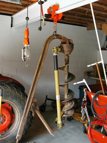

Hi Wally, When I got mine I had the luxury of having a beam going through the basement garage of my barn (partly by design of course) so I just got a beam trolley to roll it out of the way and it aids greatly in connecting it to the tractor..;) Enjoy and be safe...

Nice work!
I will not have that luxury as mine will be stored out side.
Thanks for the idea!

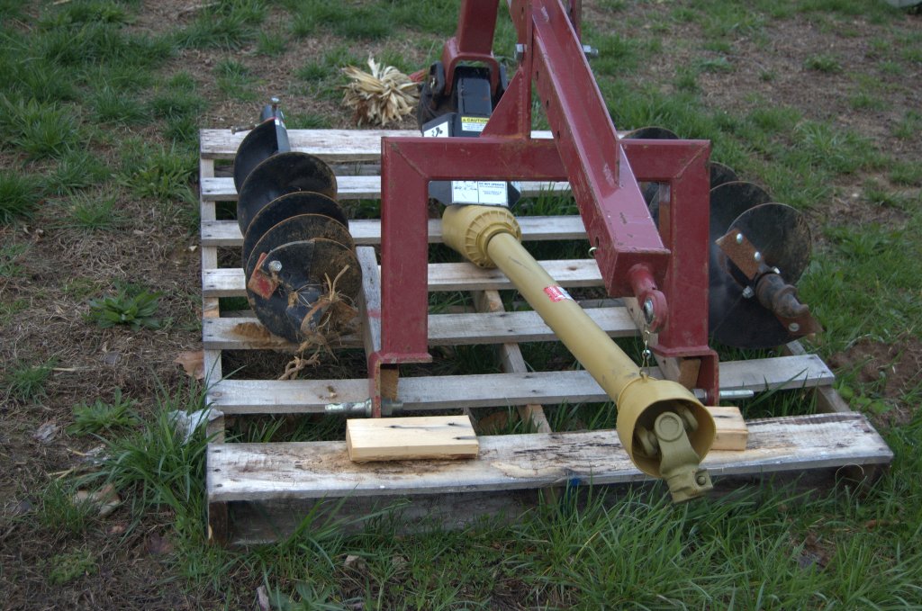

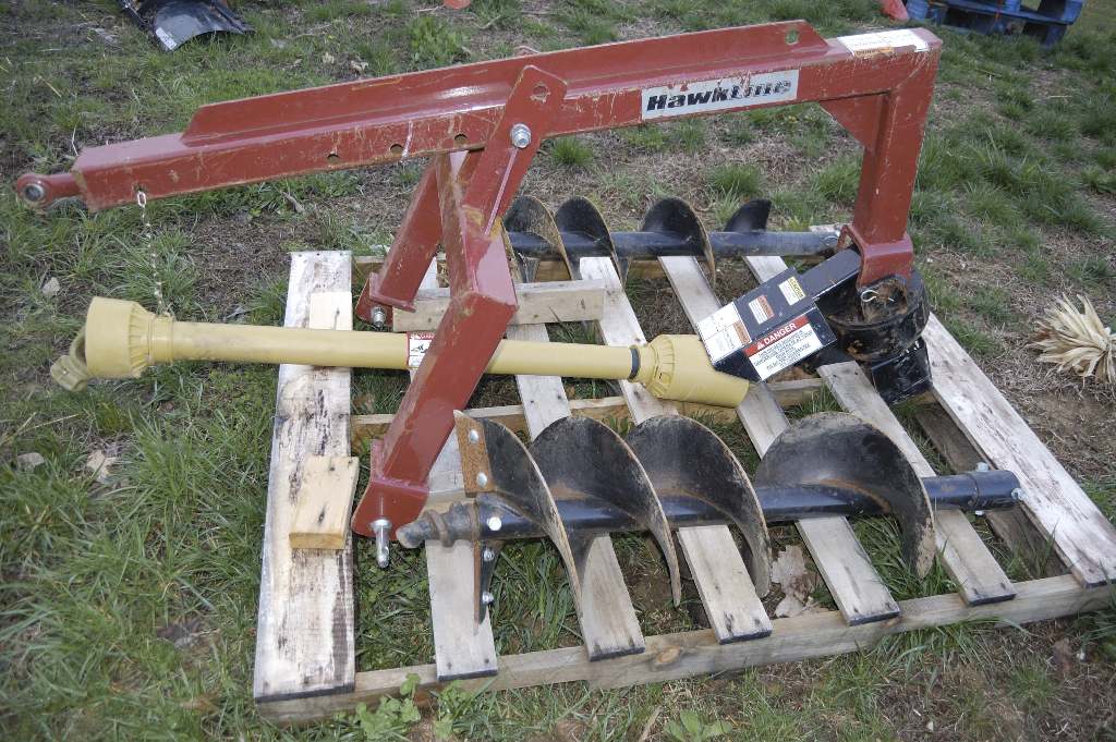

I know it looks kind of junky but here's my solution. Just found a long pallet and lowered the PHD minus the auger on to it. Put some scrap pieces of 2x4 to keep it in place at the level it meets the tractor when lowered. I can now connect and disconnect in no time with out wrestling the digger. Once hooked up I raise it and slide the auger on (easy once the boom is on the tractor).
I just did this a temp fix and it's worked so well I haven't changed it. If I ever get some free time I'll pretty/stenghten it up a bit, but for now this'll have to do. An added bonus is I can move it around with the forks if needed>

I don't have a beam trolley (that's one cool tool!) but use a similar method.
