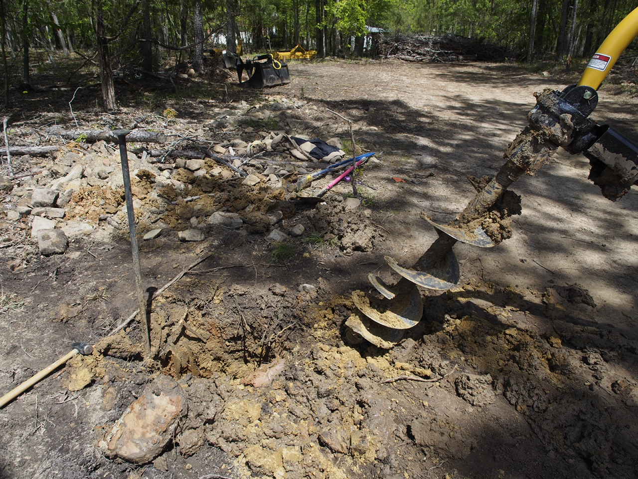

The ground type may dictate which model you purchase. I have drilled holes in sandy loam and dense, hard, rocky soil. I think the TSC/Speeco HD PHD is a great bang-for-the-buck being used in soil that is not dense and hard rocky clay like I have. I destroyed one SpeeCo standard 12" auger and damaged a 9" auger in my soil. The HD SpeeCo augers (not available at TSC) are a good add on.
I have the ETA and it is a good piece of equipment. It comes standard with the HD SpeeCo auger. I have bent flights on the 12" auger as well as breaking off the auger tip.
From a build quality standpoint, the ETA is stronger. On the borrowed TSC unit, I had to redrill one of the the auger mounting holes at the PHD mounting point as it was drilled a bit off center and only one of the two auger mounting bolts could be used. Otherwise a decent unit. It also is setup for Cat 1/2 tractors. SpeeCo has a down pressure hydraulic cylinder as an option but its operation did not mesh with my needs. I seem to recall it only supported ~ maximum 2000 PSI hydraulic pressure and my CUT uses ~2700 PSI and I did not want to do the mods necessary to adapt the down unit for my needs.

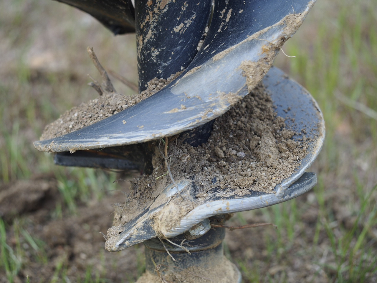

I don't know those brands, but have learned that the most important part of a post hole digger is the cutting teeth on the auger. You get the right one, and it does all the work. You get the wrong one and you are hating life. I found the right one on my third try. It took me awhile because I tend to avoid Tractor Supply, but out of desperation, I gave their Countryline 12 inch auger a try and was blown away by how quickly it dug!!!! I also learned that having a good auger meant paying attention more to what you are doing because it will quickly bury itself into the ground. Never having had a really aggressive, go through anything auger before, this surprised me.
When you wear out the cutting teeth, Tractor Supply has then there for a fair price.

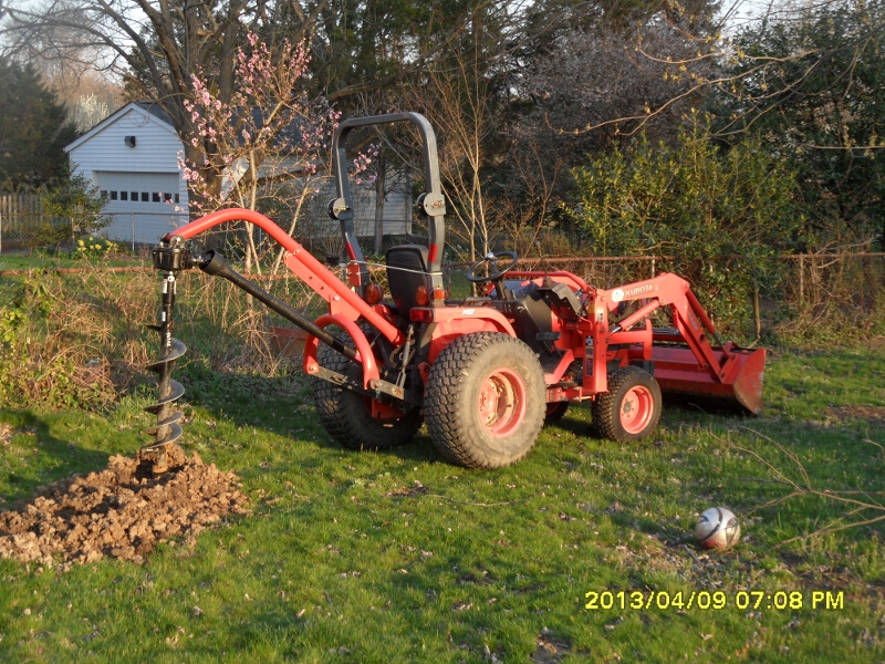

I bought a cheap Dale Phillips Equipment
Well I now know the brand, quality, difficulty of assembly and if it will work on my B7610.
First of all - This might be lengthy.
My travels brought me within about 2 miles of the Petersburg, Va store so I decided to swing by and maybe get a PHD.
Agrisupply now lists 3 tractor posthole diggers:
#48598 Heavy Duty Post Hole Digger $359.95
#31391 Posthole Digger 50 HP $339.95
#69499 3 Point Post Hole Digger Frame With Gearbox $349.95
I thought any one of the three would do for me, but I like to see things before I buy them.
SO I get there and look. They only had 1 set up, the #31391, and I was told they others in crates, but no #48598's, just #31391's and #69499's, the store guys referred to the #69499's as the "black ones". (They said the metal shroud on it was much cheaper).

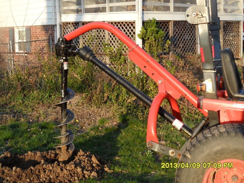

Well the #31391 Posthole Digger 50 HP looked ok to me (definitely no Bush Hog but hopefully sturdy enough). So I bought it, a #56932 (9" auger for Dale Philips), and a #56933 (12" auger for Dale Philips). Then also a handful of shear bolts of both sizes. Agrisupply carries 2 line of augers, these looked like the heavier duty ones.
I forgot gear oil, had to buy that later.
Assembly was straightforward. The only problem was I couldn't get the oil drain plug out, but I'll get that later.
Quality - The metal looks good, heavy. The paint job is less than adequate. It's like an afterthought. Big drips, bolts painted solid. Almost reminds me of a rattle can paint job.
So I put it together and found that everything fit and with my 3 PT raised to the max I had about two or three inches of clearance for the point of the auger to miss the ground
Drilled several hole in fairly soft soil. Seems to work well and a good bang for the buck.
