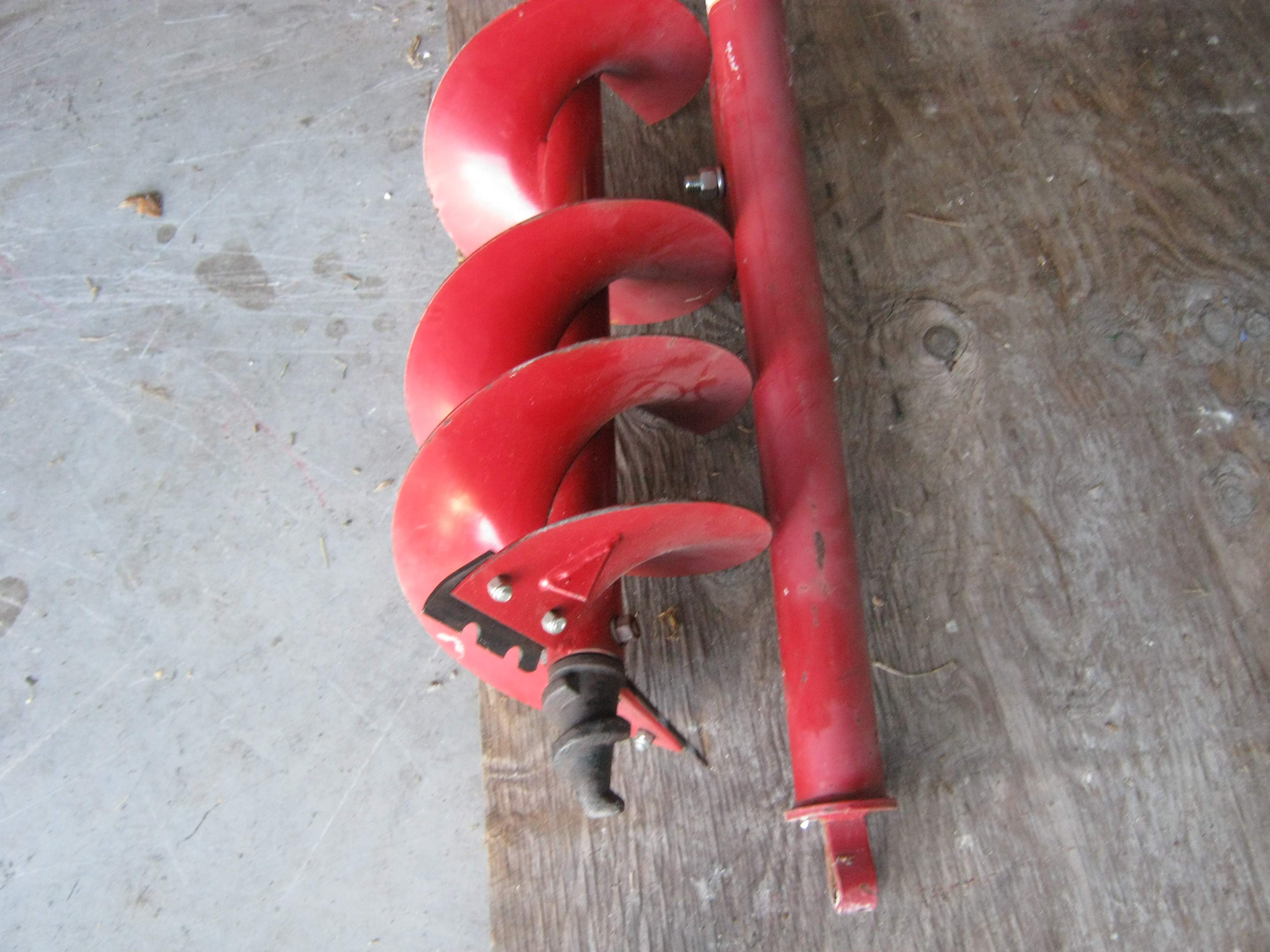

Are you talking about these teeth?

Yes, the two black parts held on with two inch long bolts.

The auger teeth are hardened more so than the auger itself. The auger won't last long without teeth on it.

Tractor Supply sells both the cutting edges and the screw points.
I would certainly consider them as 'wear items' as they are doing the bulk of the work and will certainly have to be replaced over time.
