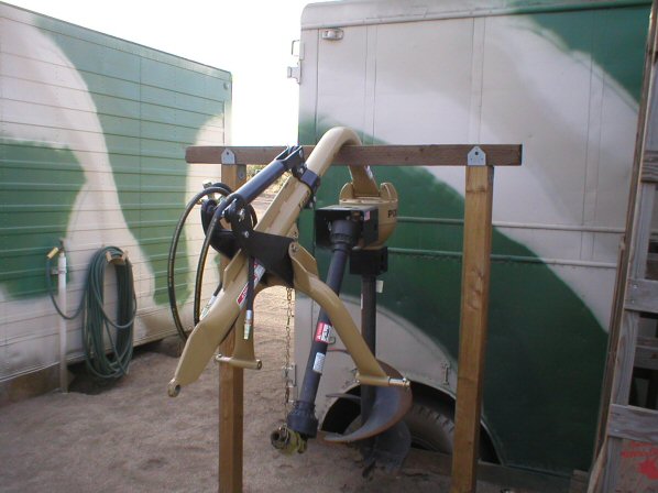

Just my 2 cents worth here.

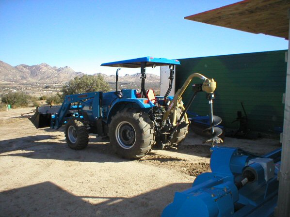

As far as the weight, the unit is most likely a pretty good unit. Not sure about wrestling with it off of a factory stand or not, but it takes me less than 5 minutes to hook mine up off of my home built stand that would cost less than $20 if you were to buy the material.
Can't give you a hands on answer about the clay. But would think that as long as the clay was not sticky wet, that the double flighting would be a plus.
My opinion is that the lower gear ratio is better, but others may feel different.

NH is New Holland and it weighs over TWICE the Land Pride PD15. (the auger is 6 inches shorter, however). For the most part, I'll have it parked on a concrete floor in a barn.

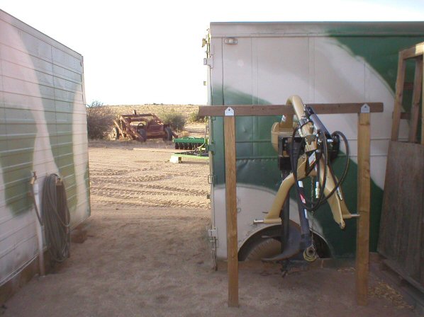

I like pic's with the homemade stand. I'm always amazed at the price for things like company stands. I noted that a 9 inch extender for the auger was nearly $300 !
My neighbor has a cheap stand, he chains the PHD to a low branch on a tree in his side yard. :) He lifts the PHD up all the way, runs chain around PHD and tree branch, lowers PHD to take weight off of 3pt, pulls pins and goes. Takes him less than 5 min to connect or disconnect.
/ Post Hole Digger and Auger #8
All that said about stands, insure that you have some form of stand.
A PHD can put a serious hurting (pinch) on you in a hurry if trying to manually put one in place.

MVR, how do you get the auger over the top post?
With the double flighting would it not have clay in smaller pieces so if were to clog it would be smaller clumps to deal with? Made me wonder, if you have a tank of used oil to set the auger in between holes would it help prevent sticking?
My nephew uses a simple stand for his PHD also, he has a shed with dirt floor, he runs the auger into the dirt and it holds right well. Not sure but probably places a block to hold up the tractor end.
If the auger sticks to where you can not lift it and cut off the tractor and use a simple piece of round metal to turn the auger back-wards. Might be slow but is not hard. Then take it further and put a hyd motor on it and run it either way as needed.
As to the RPM issue, you don't want to run an auger at a very high rpm anyhow unless you are 100% sure the ground is clear of any thing that can catch it such as roots. kt
/ Post Hole Digger and Auger #10
The top cross beam is removable. If you look at the picture, there are saddles fastened to the posts and the 4x4 just sits there.
When going to remove PHD you have the auger lifted all the way up, then slide the 4x4 under the boom and set it in the saddles on top of the posts. Then lower the PHD down to where the weight is just off of the 3ph. Disconnect and drive away. Just the reverse to hook up. Usually takes about 5 min. No muss, no fuss, no pinched anything, no PHD twisting on a chain, easy, easy, easy.

I ended up with the Landpride PD25. I wanted to ask you a little more about your stand....it is the best I've seen!
You mentioned that you are using 4X4's. Is that for all 3 pieces?
Also, what other hardware did you use?
Since I'll be storing this on a concrete floor, I was thinking of having some "boots" made for the uprights....some steel set upright that the 4X4's would slip into (kindof like the rectangular back end of a trailer hitch) and that would have 3 or 4 flat feet welded to it and extending out at 90 degrees.
Thoughts?

Hondo, thanks for the complement. I have a Land Pride PD35, and as you can see, those 4x4s hold it up just fine. At the top of each 4x4 there is a sheet metal saddle that is fastened to each vertical post. The top cross piece is also a 4x4 that just sits in the saddles that are fastened to the posts. The saddles can be purchased at about any place that sells lumber.The saddles are commonly used on decks and patio covers. The posts are in the ground about 24", in fact those holes where the very first holes that I used the PHD for. As far as building a stand that will work on concrete, I am sure that it will work, I don't know who, but somebody that used to be on TBN had pictures of one that he built and it was like what you want to do, except that I think that his even had wheels on it.
Good luck with your stand and if you have any other questions, just ask.
One other thing, why the Land Pride instead of the New Holland that you were looking at, just wondering?
MtnView: Did you concrete the two vertical 4X4's or just backfil with dirt?
/ Post Hole Digger and Auger #17
The 4x4 posts are pressure treated. I drilled 6" holes and filled with dirt and tamped. No problems so far.
