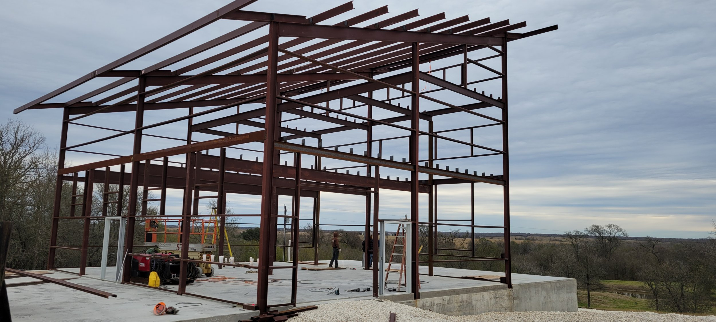

Given this is the welding section of the forum, attached is an in-progress photo for the shack I'm building to house the tractor. After the metal siding and roof is up, I'm thinking about closed cell spray foam insulation. I've been following behind a lot of armored trucks lately, waiting for stuff to fall out the back.
