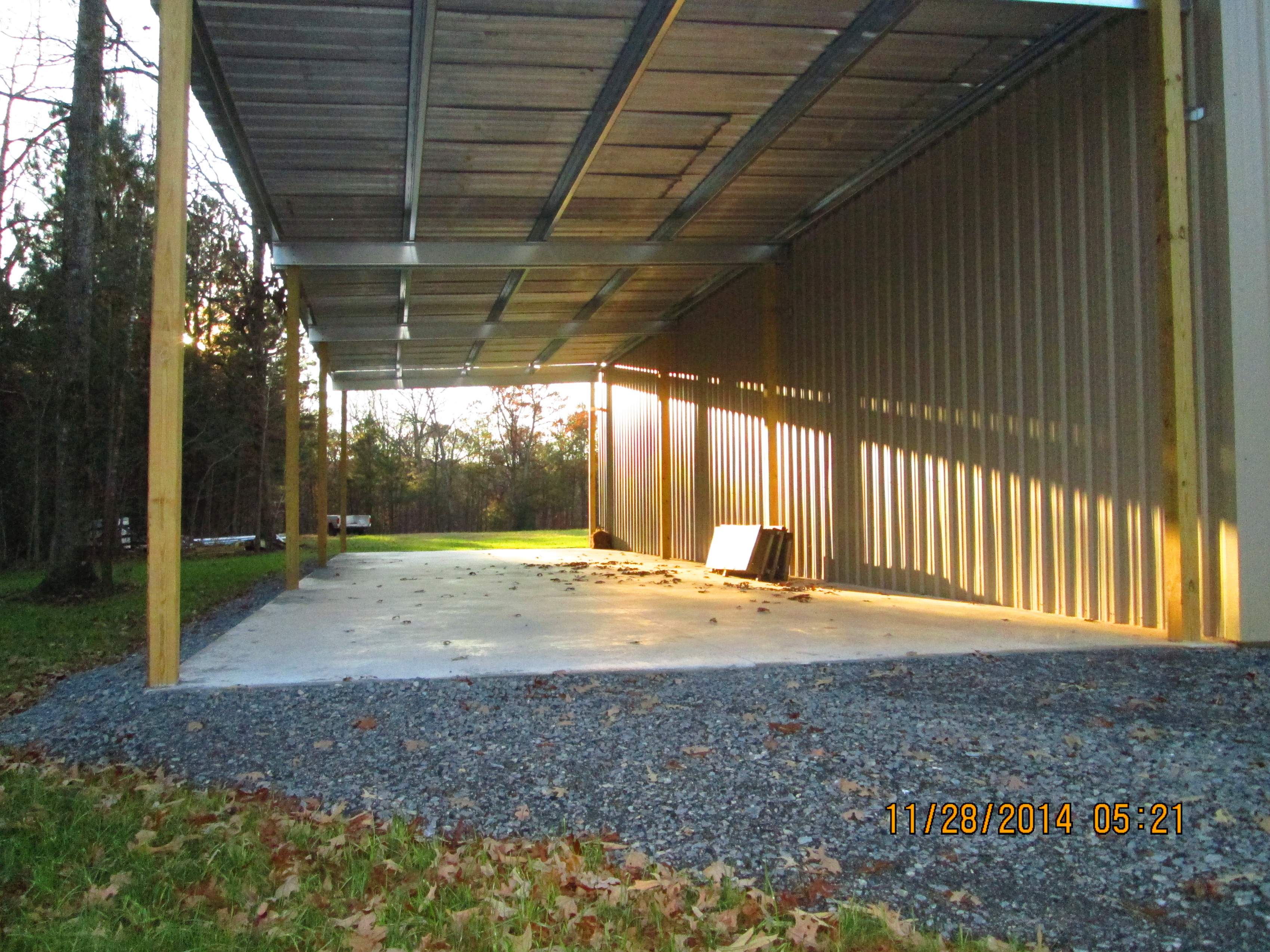

Not sure if you are thinking of a house or shop ? I think this is good use of wood and steel.

Dan: Thanks for the info, I'll look into one of those wood graining tools. It could help a lot with the aesthetics of the structure.
NC: I can't see too much from the resolution of the pic, but yeah, something like that, maybe a little bit. I like the metal framing a lot. maybe I just like welding stuff 'cuz it's new for me, but that framing looks similar to what I had in mind. The wood will be planed and tongue and grooved and varnished, try and put in nice trim on doorframes and window casings etc wherever applicable, try and dress it up a little.
