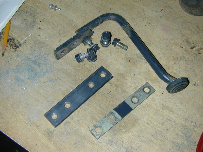

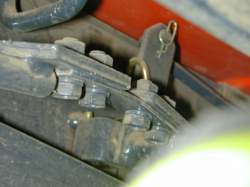

I mostly agree w/ everybody but the BX's have a weak link in the diff lock linkage. I posted some time ago about it but can't find it now.
The first pic shows the piece I'm talking about. Kindof hard to put it into perspective but easy once you crawl under.
Pic 2 is of the piece I re-made, out of REAL flat stock, rather than the OEM piece of crapola. I think I used 1/4" stock but don't remember.
Though taking the mush factor out of the system WILL give you a postive feel, as stated you'll still have to wait for it to engauge.
I use my lock a lot and also take the time to unlock it each time.

You raise a good point Bernie :) I may not use it a lot compared to the number of hrs I use Baby, or maybe as much as other folks do. I may have should have said, I'm not reluctant to use it now that I fixed the linkage. Now it's a measured press of the pedal. Before it was ... well, why bother, I never knew if it would catch or not. At 1000 hrs, the pedal pad is still barely worn. The pic was taked at ~400 hrs.
