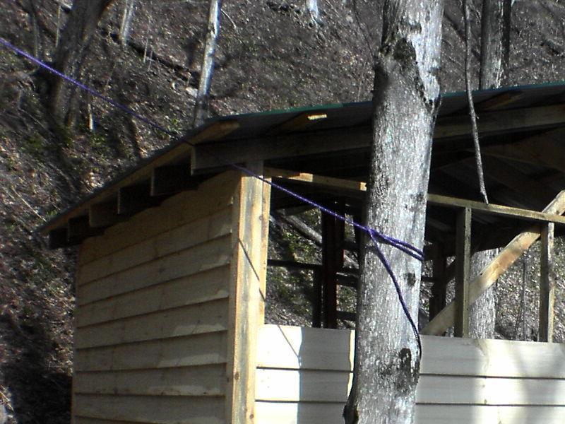

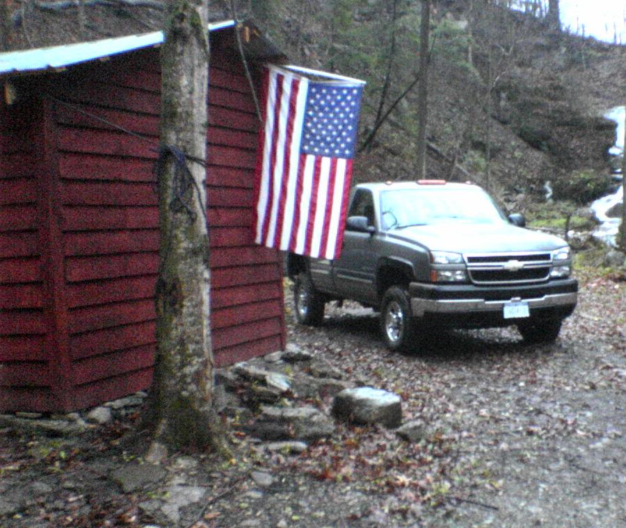

Here are a couple pics of a small 10'x10' lean-to made completely with lumber from from the mill. I made a jig to mill the tapered clapboard siding. I used a special corregated blade and one of those rare metal logs for the roofing. :)
