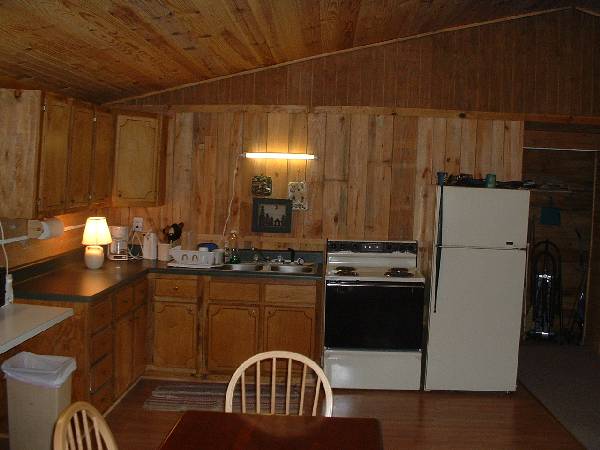

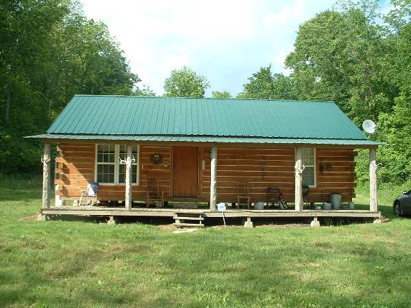

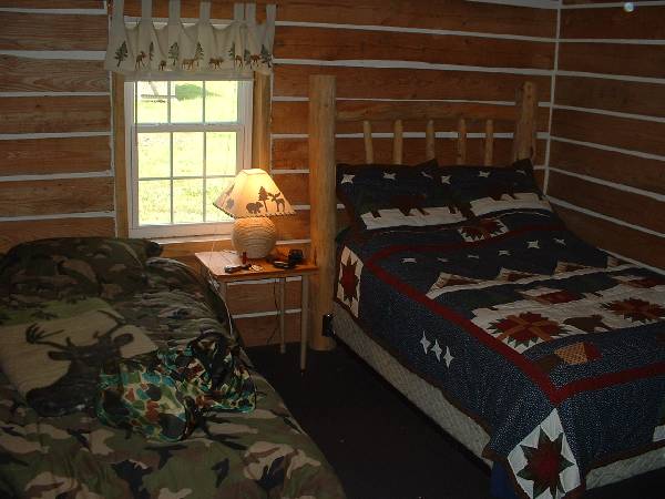

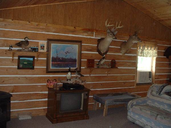

Here are pictures of a cabin I built on my farm. The logs for the exterior walls are 6X7 and were sawed by guy with a Woodmizer portable bandmill. He also sawed 1 bys which I used on the interior partition walls. I utilized about 80 pine trees which were planted by my grandfather back in the day. The guy who did the sawing was a very nice gentleman and he only charged me $1500.00 for the entire project. I have been told that was a steal. Anyway, the cabin is my weekend getaway. I completed the project about 4 years ago and have spent many a fun weekend in it.

Beautiful cabin! Love the interior. I wanted to go with logs for my cabin, but I was intimidated by the labor involved. I went stick built and I'll probably regret it my whole life, although I'll finish the cabin sooner.
