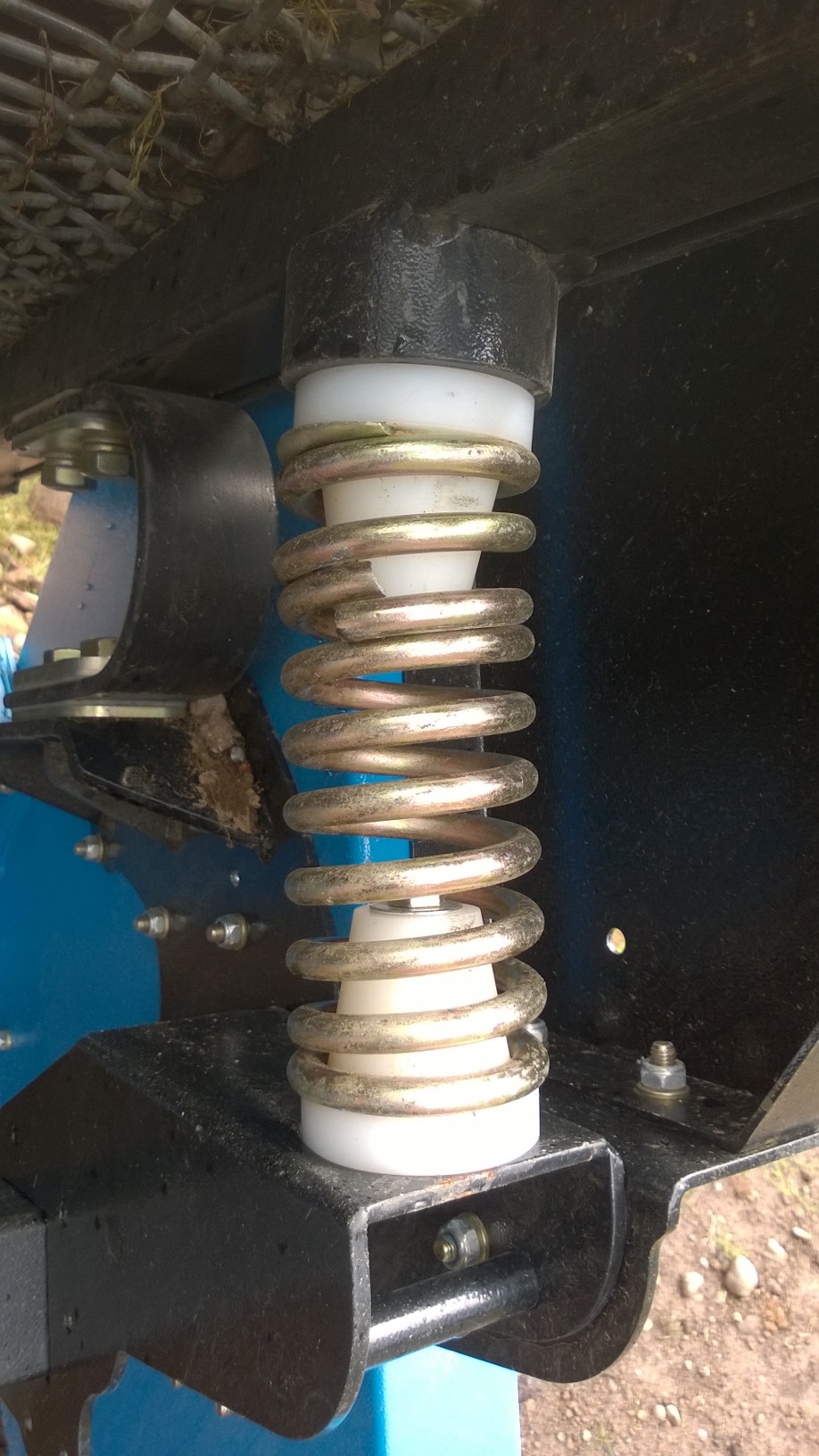

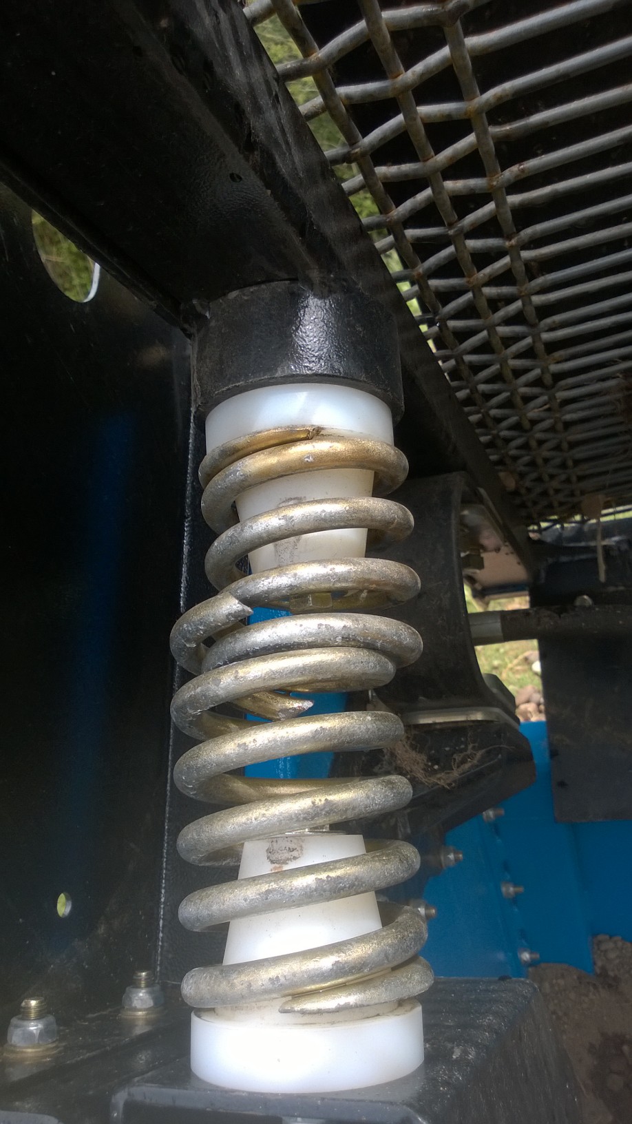

After about about 3 hrs using the screener I noticed both coil springs were broken into two pieces. I don't remember it being like that before but I can't imagine what I've done that is unusually hard on it.

The coil spring have been designed to be our weak link in the chain. They are hardened spring steel so if the are compressed quickly to the point that the rings hit each other they may break. I have design the machine to do this to make the operator conscious of put to much down pressure on the screen deck with the bucket and damaging the screen deck.
If you can our 877-254-7903 number and talk with Peter we can send you out a new set to get you up and running. Let Peter know that I said that I would cover the cost of the springs.
The springs are about 40.00. Some customer keep a spare set on hand to eliminate down time.

Brad, Thanks for the posting. When the unit is repaired if I try to screen material with grass, etc in it I'll remove the mat. Haven't tried that yet as it looks to be a bit of a wrestling match to take it off and on solo.
This is the first I am hearing about the coil issue.
Kind of disappointing given I was trying to be careful and they were broken the very first session, but if I had been warned about it I would have had second thoughts about laying out the bucks so I can understand not telling me and risking the $7k sale.
But at a minimum I would have had extra springs delivered at the same time as my unit and extra meshes, to save shipping costs.
I'll try to be even more careful with the springs, but if they keep breaking I confess I won't be very happy about it. Was not my expectation to be having mechanical failures so easily/early.
