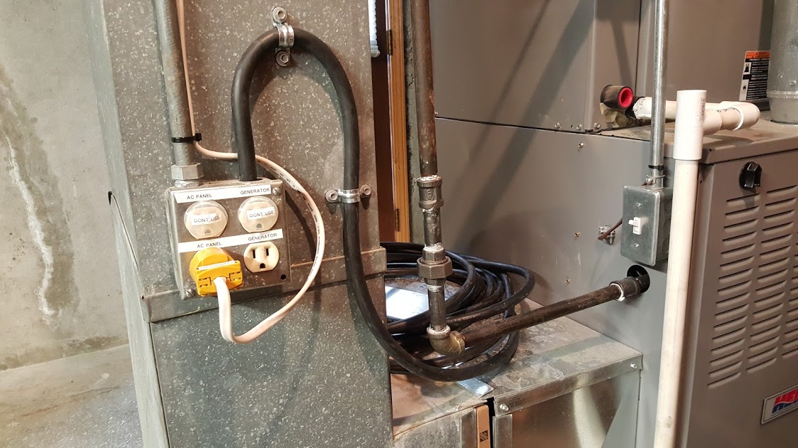

You are correct. Step I did not mention is breakers are flipped off in transfer box when I flip the transfer switch to generator source. When generator is warmed up a little I flip the breakers on. Thanks for pointing that out.

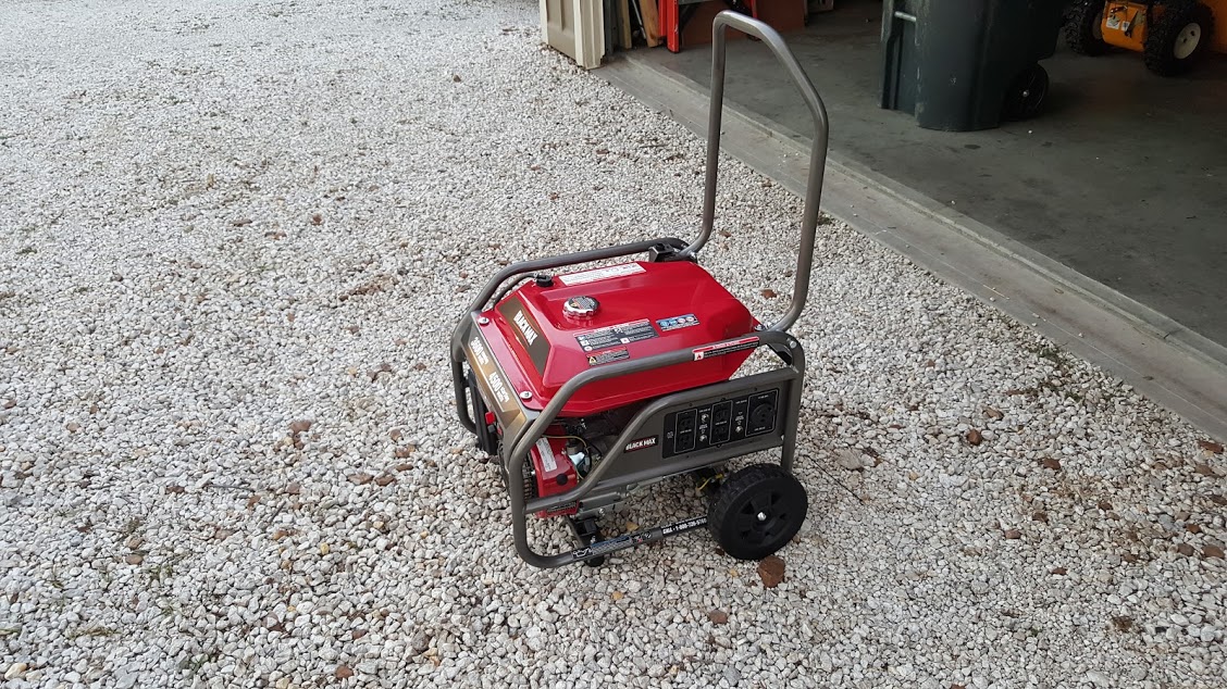

I ended up buying the one Sams had on sale for $199. Awesome little generator, very quiet. Put gas and oil in it and it fired up the first pull. I put a meter on the output and the voltage was very steady and constant.

Well I got my electrical all done for the generator and furnace last night and tested everything, worked like a champ.
   / Portable Generator #76
I would have used two separate boxes.

We recently had our first power outage since I purchased the larger Harbor Freight one and mounted it on one of their smaller "erector set" utility trailers. Mine too has always fired up with just one or two pulls. Hooked it up to my UTV and wheeled it behind the house; plugged her up and everything worked fine. Fired on first pull. Ran for about 4 hours and power came back on so I didn't get a good test.
Gotta figure out a better way though - there was no wind and the exhaust fumes still managed to stink up my living room.
