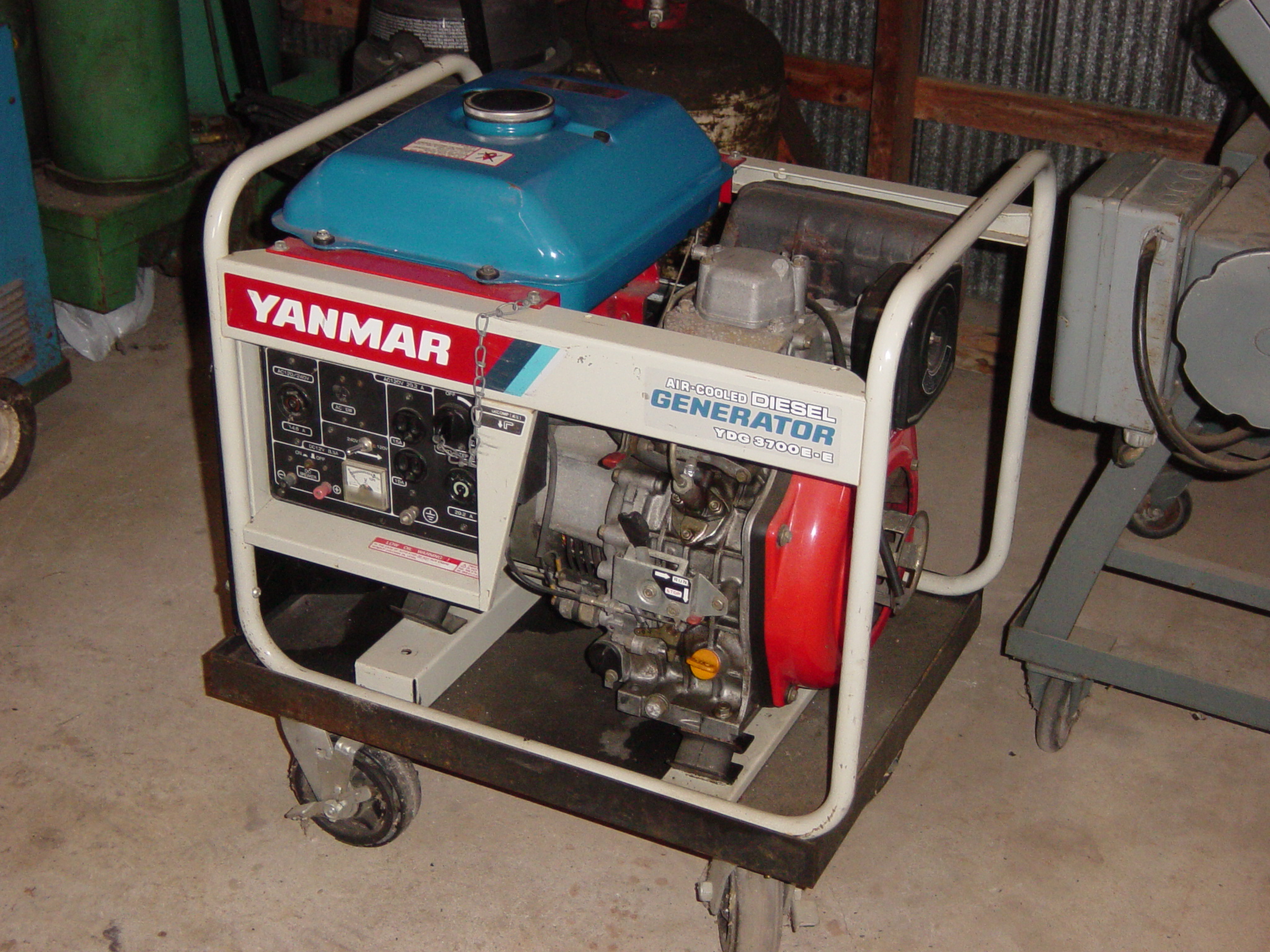

I have a YANMAR portable air cooled single cylinder. It is 3.7 K which I have put into my 200 amp whole house transfer switch and it worked great, with load observation/management of course. They do make larger versions. They are a bit pricey, but you get what you pay for.
It is a terribly noisy beast, but I know it will always start even when very cold. It has a decompression lever. I consider it my "Portable Generator" but two guys struggle to lift it.

Power went out on the weekend for a few hours and I used my main 7.5KW 1800 rpm Liquid cooled Diesel. Used a bit of electric heat, but had a fire going already. So life went on EXACTLY as usual. BUT, you won't get that for 8K!
Oh yeah, that Yanmar is a 3600 rpm screamer! Terrible to do tht to a diesel.
