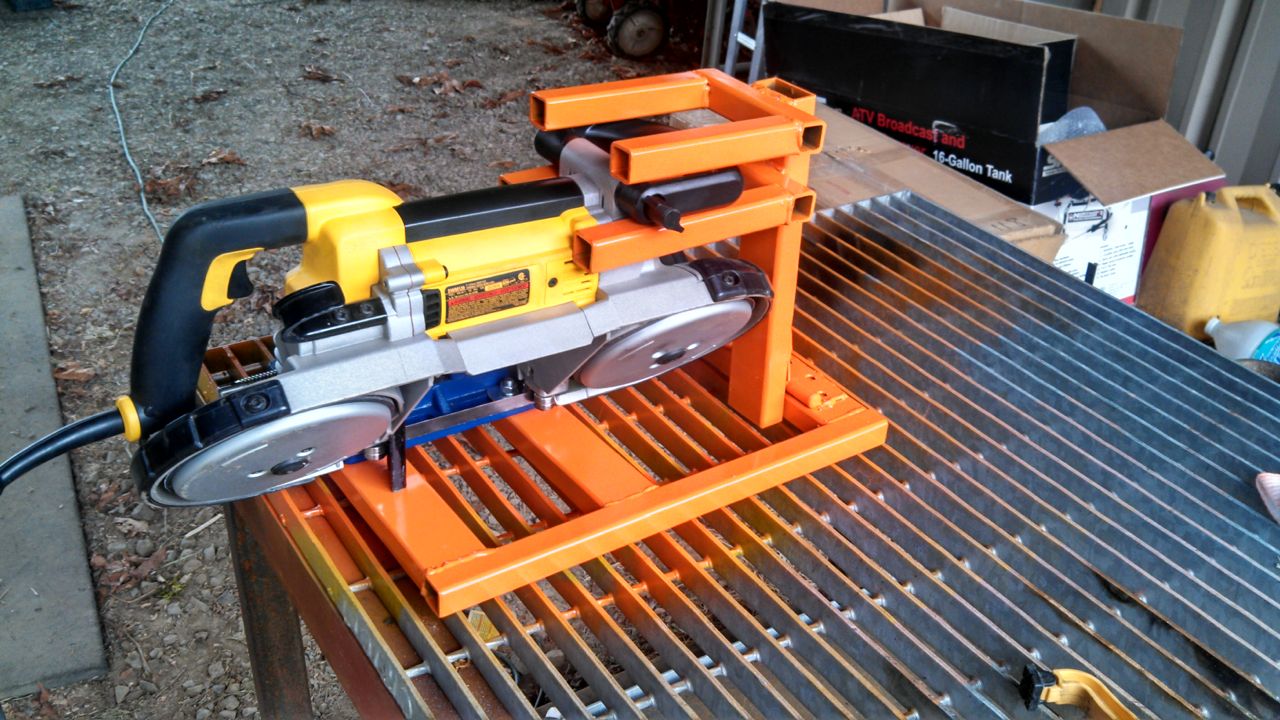

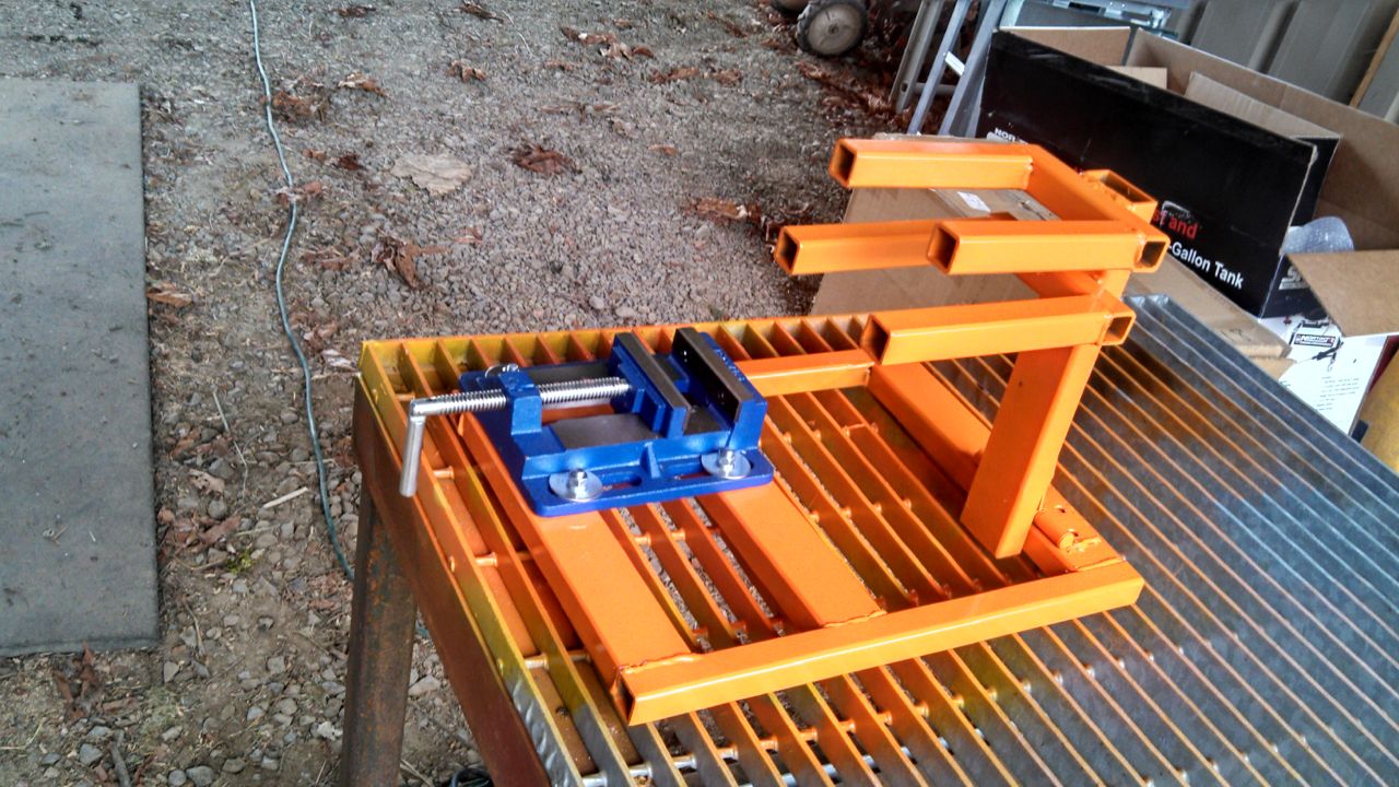

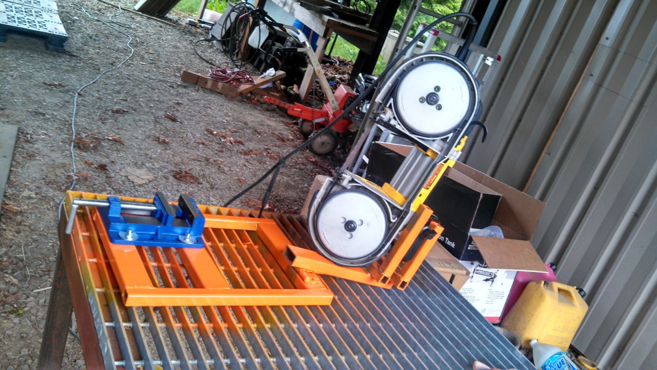

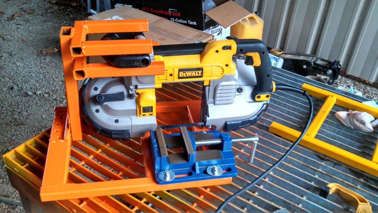

Just sharing a welding project I got onto. Practicing thinner material. Built these two mounts for my portaband which I love dearly. Only complaint is that the Dewalt does not have a locking trigger so I have to figure a way to make a clamp.
also I have not put on the aluminum plate for the upright. Still figuring out how to cut it correctly.

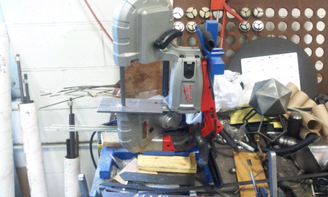

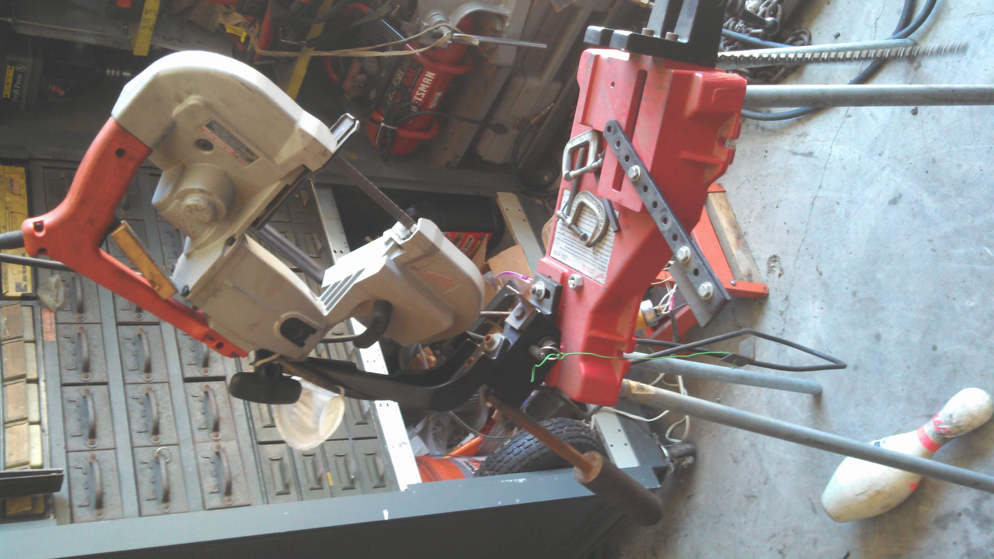

I picked up this portaband table off of craigslist for $75. I added the counter weight to the rear so you could adjust the feed pressure, the limit switch that cuts it off at the end of the cut and the ability to make miter cuts.
To keep it running in the absence of a locking trigger, I just cut a section of wood to hold it down.

Nice project. I have a potential solution for you on the locking trigger issue. On my Milwaukee portaband, I used a zip tie to lock the trigger on and then plugged the saw into a HF foot on/off electric foot pedal. Works fine. You could put the foot pedal next to the saw if you prefer and operate it with you hand. Works well for me.
For those who don't have your welding or fabrication skills, an outfit in Oregon, SWAG OffRoad, produces a very nice table for portabands. They have a variety of models, some being stands and one being a simple device you just clamp in your vise. Very well made and pretty reasonable price.

I drilled and tapped the base for my miter setup, it made it so you could just use a c-clamp to hold the material.
The chain is a PITA.
You can also setup stops for many sections the same length.
You can see the addition and extra hole in the table in post 7. Don't know why it loaded sideways. The hunk of metal with all the holes was left over from some garage door opener install.

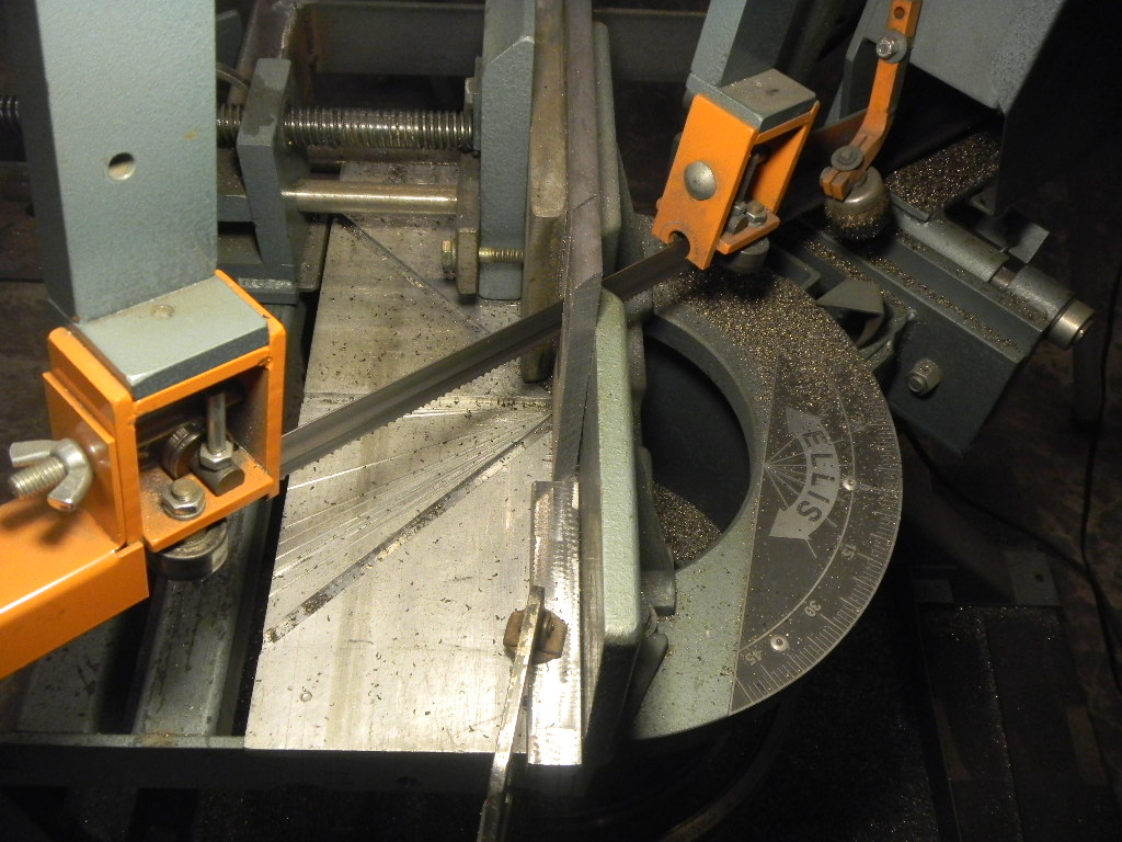

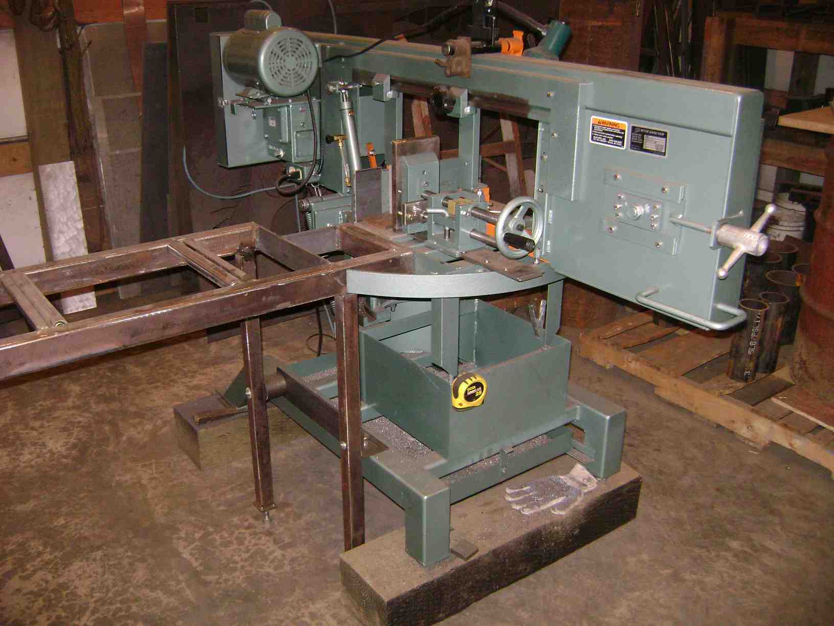

Shield Arc said:
A lot cheaper than this thing I got setting in my shop.
Nice. At work we have a big horz. saw, but it doesn't do angles. Must be great for miter cuts on large heavy wall tubing.
