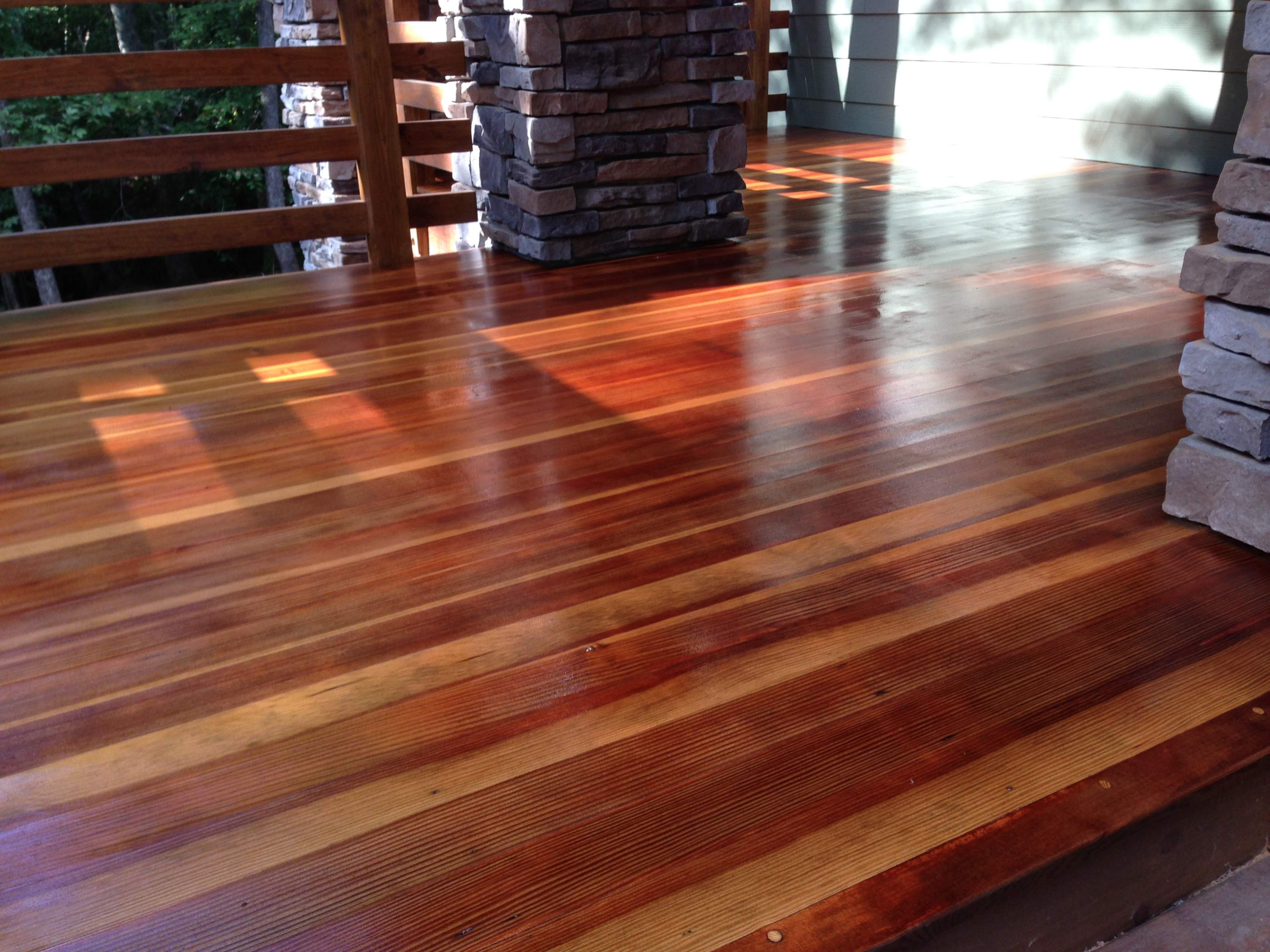

At our new house, it's all porch, in the sense that it's all covered. We used quarter-sawn douglas fir tongue & groove planks for that -- same stuff you'd find on older homes. I think my builder found new old stock, just barely enough.
We put Sherwin-Williams Deckscapes stain on both. The back porch has held up fine, probably because it is shaded most of the day and doesn't get wet unless it's a real serious storm. But on the front porch where sun and rain intrude more often, the stain started breaking down in less than a year, and I could tell it would be the same old B.S. The painter that worked on our house suggested we bite the bullet and remove the Deckscapes stain from the front porch, and then sand it and put on Cabot oil-based polyurethane. Here's a pic shortly after it was done last year:
That has held up great, and still looks good after a year. I have no idea how it will do long term though. So it's a bit of a wildcard.

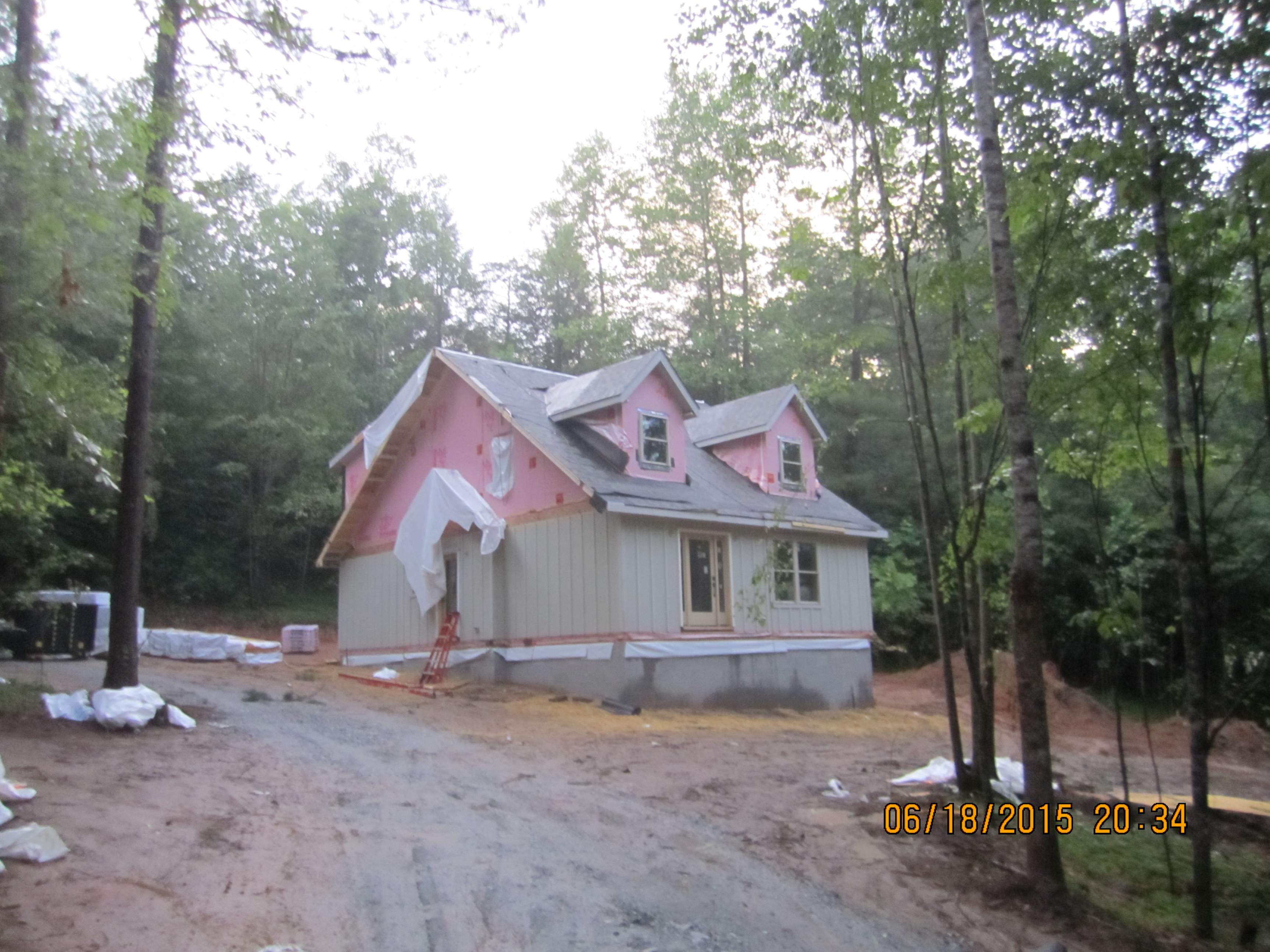

Thanks for the replies- I've been reading some of the past 'wood vs. composite' threads, and like always, guys are quick to help with their experiences. I've attached a pic of the home when it was just placed on the foundation; due to it's height, we knew we wanted a covered side and front entrance deck, so a shed roof on the front, a small gable roof on the side, and simply connect them with exposed decking. One point I want to make is that the front faces NorthEast, and that side entrance is East, so the sun might give us some leniency:2cents: Now that you've seen what I'm working with, I'm all ears to how you guys would design it as well.

Hmm, keeping in mind I am artistically challenged, I think I would do a covered porch for the side door for sure, since you already have the gable bumpout there and a little porch extension would look great. It will also add some variety to that side of the house. Maybe some timber/stone columns to support the gable. Could maybe do a different roof material there, but it all depends on your taste (I tend to like the same roof material everywhere).
Front seems like it would get crowded and spoil the look of the house if a shed roof was tacked on. I just don't see how it could be done without shoe-horning in there in an un-natural way -- the design just doesn't seem to want that. So I'd be inclined to leave that as an open deck, but style it to look good (which is where I pass the ball). It will probably have a great view out into your property. Consider those stainless-steel cable railings, which would reduce visual clutter.
Which entrance will be the main one in use? Could the side entrance become the main entrance where visitors go? And could the front entrance really be more like a door that connects inside and outside living spaces? Call me crazy, but I'd make the side door and covered porch be the "front" door, and turn the front door and deck into something like a back door that leads to an open deck.

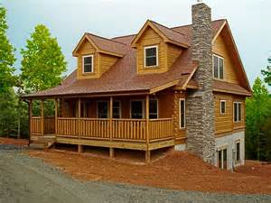

Perhaps an open deck in the front with a gabled front for my shade? Here's a pic of the same model home (with logs) that shows the shed roof design with deck:

That looks a lot better than I thought, which confirms my lack of architectural skills. The low ceiling could only help the shade. It looks natural -- I reckon that type of porch on a cabin is like butter on corn.

After debating the issue (and I'm still not done), I like the idea of the front porch protecting that wood, and the side gabled entrance as well. We're going to connect them together, so that the wife will have her uncovered portion. I think I'm also bickering about a total of 400sqft of wood, most of which will be covered anyway:cool:. Not sure it's worth me stressing over for that small of an amount. Now finding cable railings at a reasonable price is another subject!

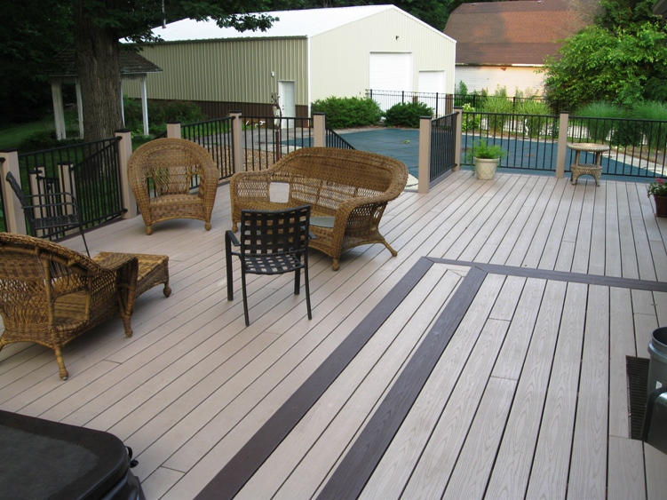

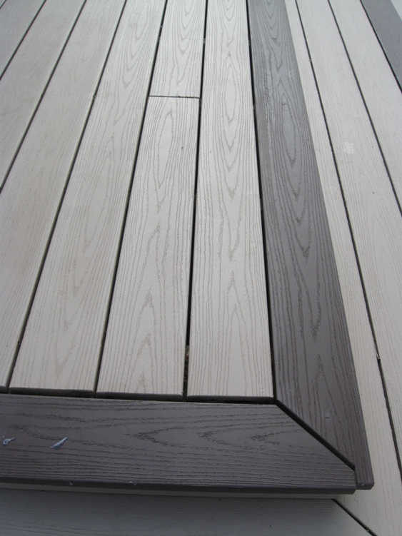

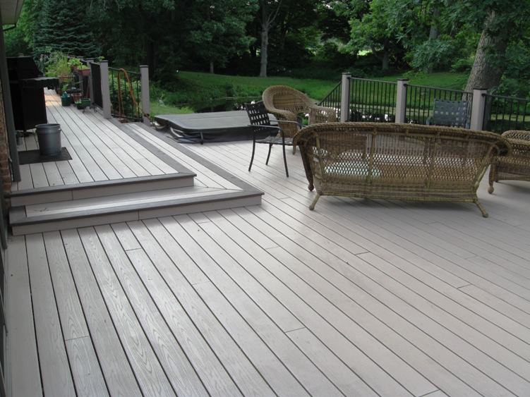

Here are a few pictures of my deck with Azek composite. This is about 4 years old and the only maintenance to date has been power washing a couple of times a year. As long as you don't mind a painted wood look and can handle the initial investment, it's a option worth considering.

The joists and stuff that's not visible were left alone. The railings and posts are stained with Sikkens teak stain/sealer, which is used on other parts of the home too. It is not suitable for wear surfaces like floors or steps, but for other wood surfaces it works well and after 2 years still looks good. My builder swears by that stuff, but it was new to me. It's sort of thick and syrupy compared to stain, and leaves more of a smooth shiny finish.
