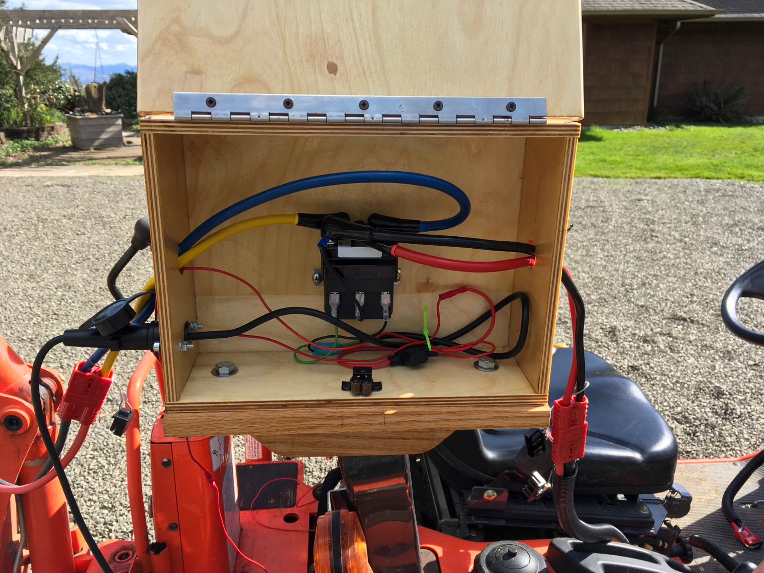

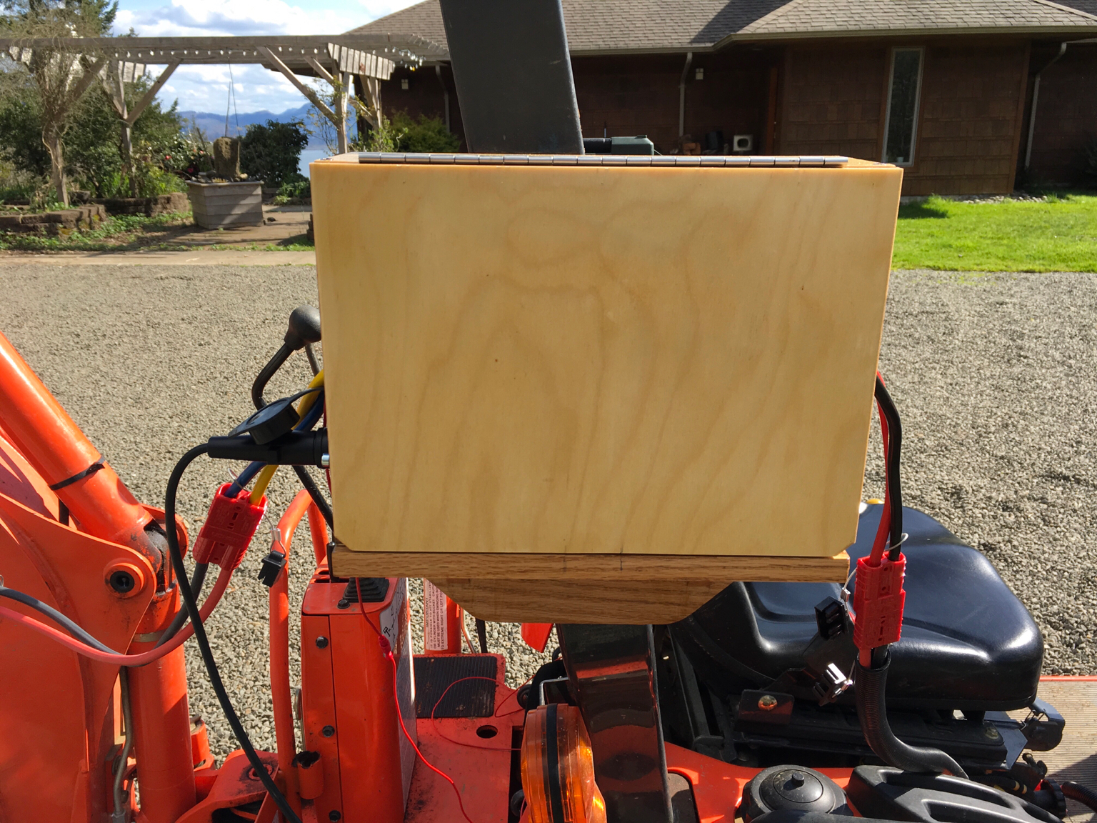

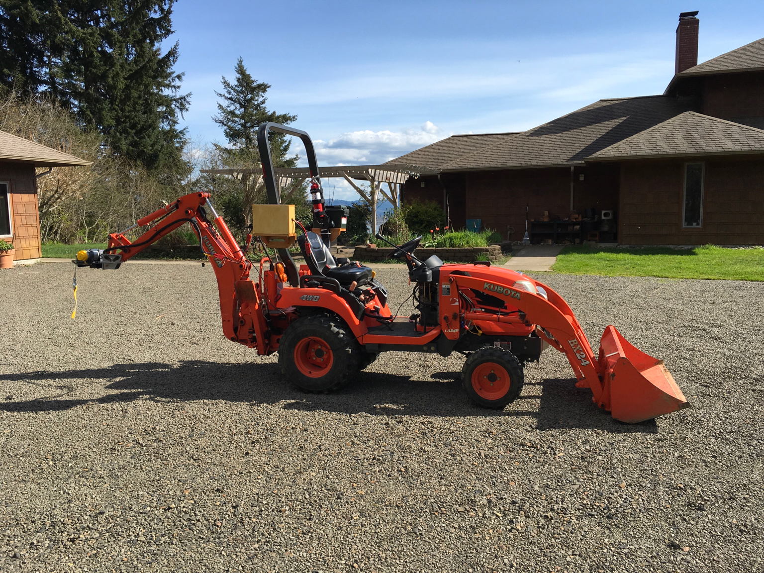

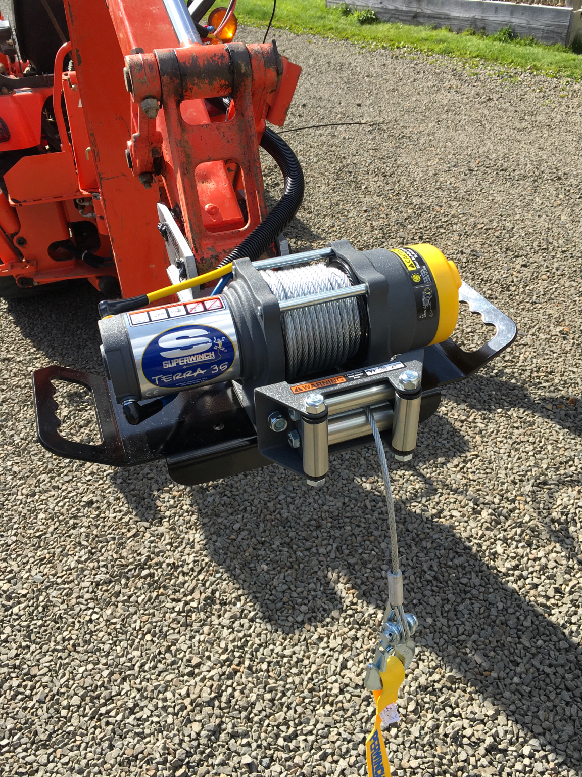

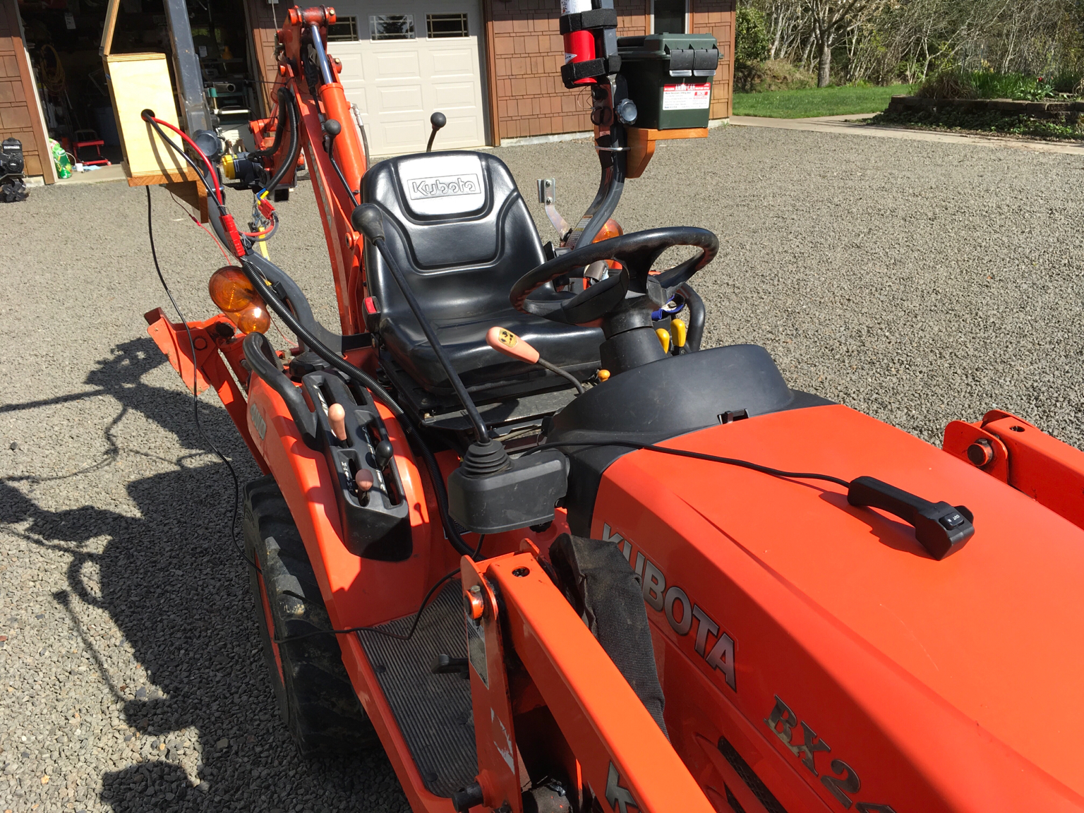

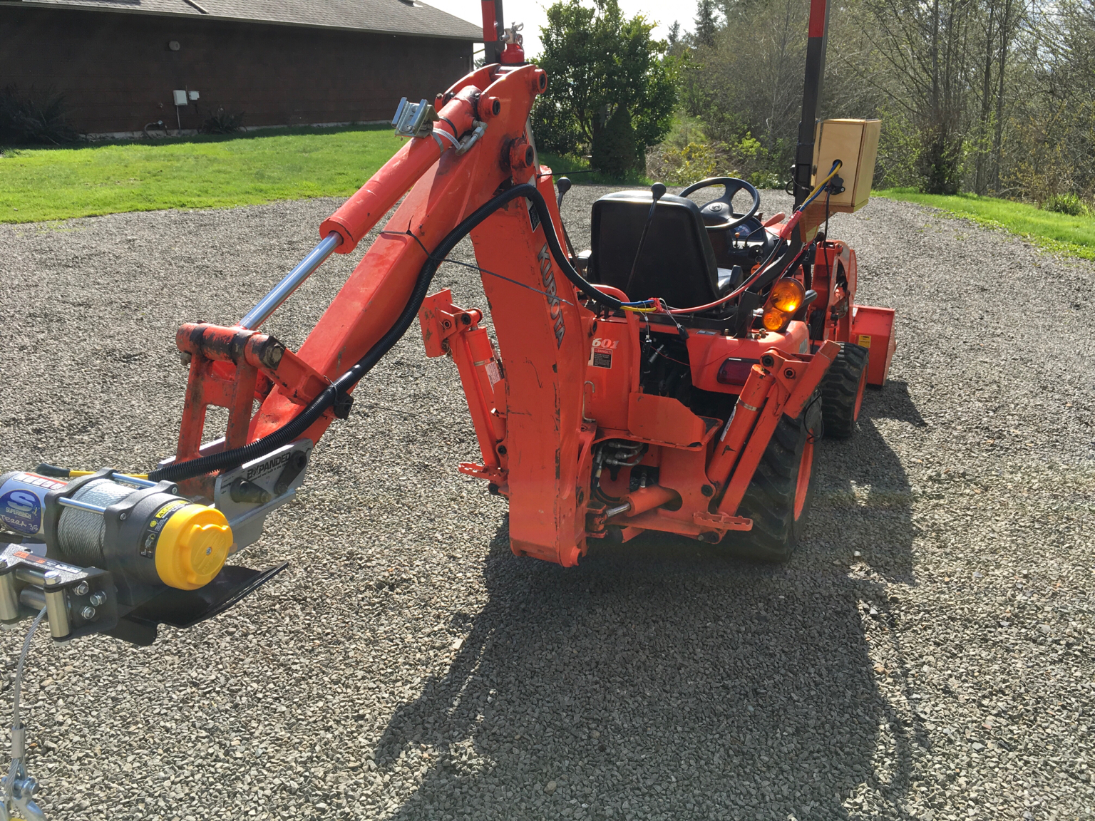

I installed a Superwinch 3500 in place of the backhoe bucket on my BX24. I need to tidy up the wiring but the winch works great. I set it up so everything except the battery wires and circuit breaker in the under the dash area come off the tractor when the winch is not in use. I just use the remote to control the winch. I didn't use the ATV handlebar switch that comes with the winch for obvious reasons.
I built a wooden box for the solenoid and connections which mounts to the ROP. This comes off with 2 bolts. I will use the winch during the time of year I cut firewood. After that the bucket goes back. I used more connectors than I needed but I want the system to break down to small parts for storage.
Our property is very steep and I need to get trees up to the road to process them for firewood. Decades ago I just cut trees into pieces and humped them up to the road. I have been backing the tractor up and pulling logs with hooks on the FEL bucket. This got too exciting when I would raise the bucket up to get a better angle.
Winch $179
Adapter for 2" receiver $75
Bxpanded 2" receiver replacing bucket $129
6 ga wire and miscellaneous connectors and crimper $45
I would rather have a Wallenstein FX35, but these cost $3000+.
I just threw in a picture of our view for the heck of it. That's a cruise ship that was in the Portland shipyard for repairs. It's headed out to sea at Astoria, OR. Sometimes really steep property is worth it.
View attachment 506037View attachment 506038View attachment 506039View attachment 506040View attachment 506041View attachment 506042View attachment 506043
