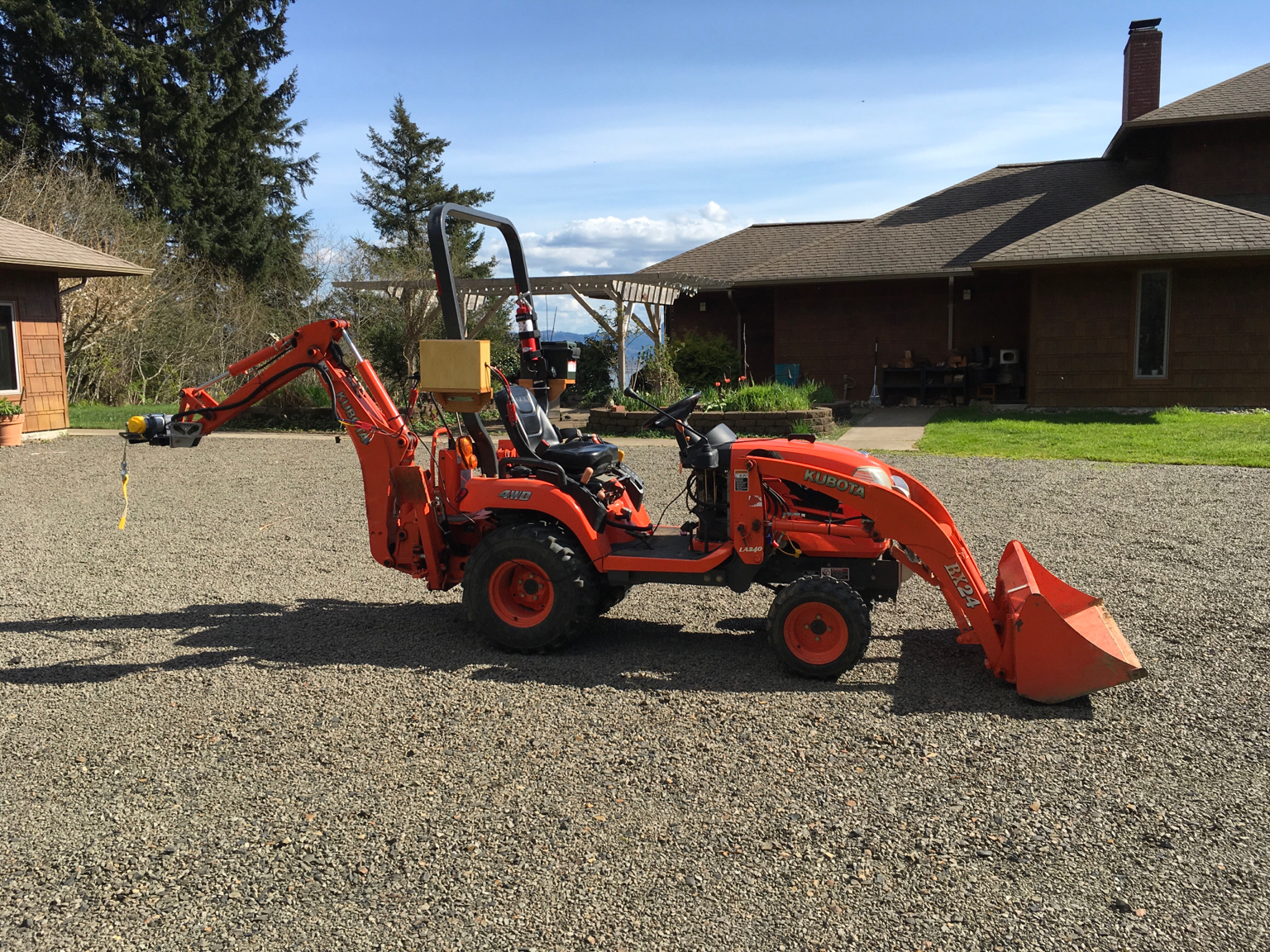

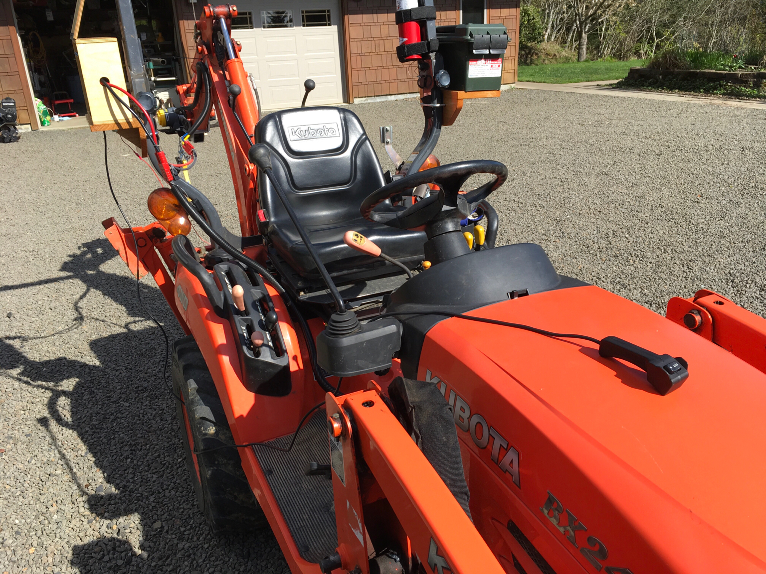

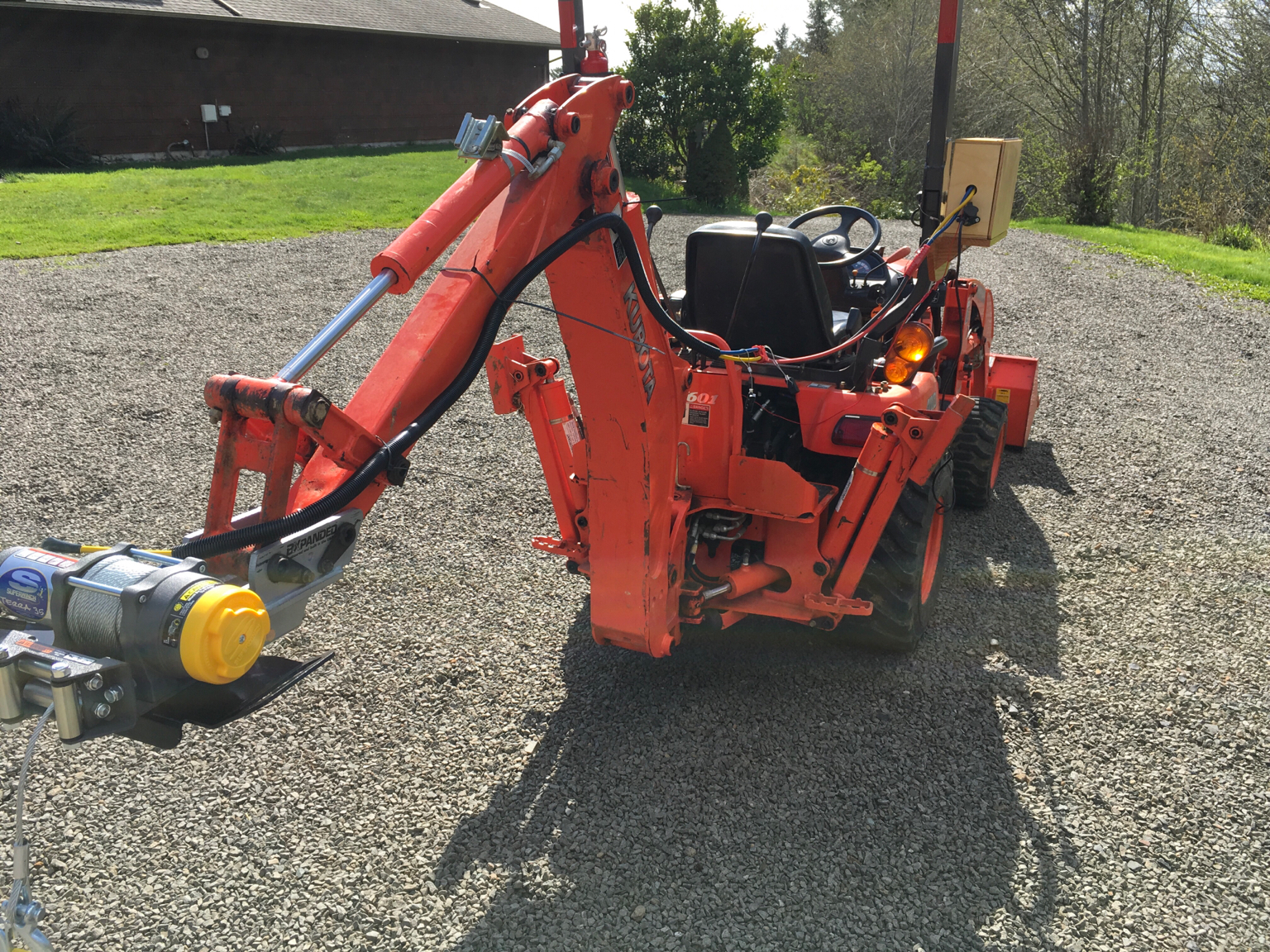

I installed a Superwinch 3500 in place of the backhoe bucket on my BX24. I need to tidy up the wiring but the winch works great. I set it up so everything except the battery wires and circuit breaker in the under the dash area come off the tractor when the winch is not in use. I just use the remote to control the winch. I didn't use the ATV handlebar switch that comes with the winch for obvious reasons.

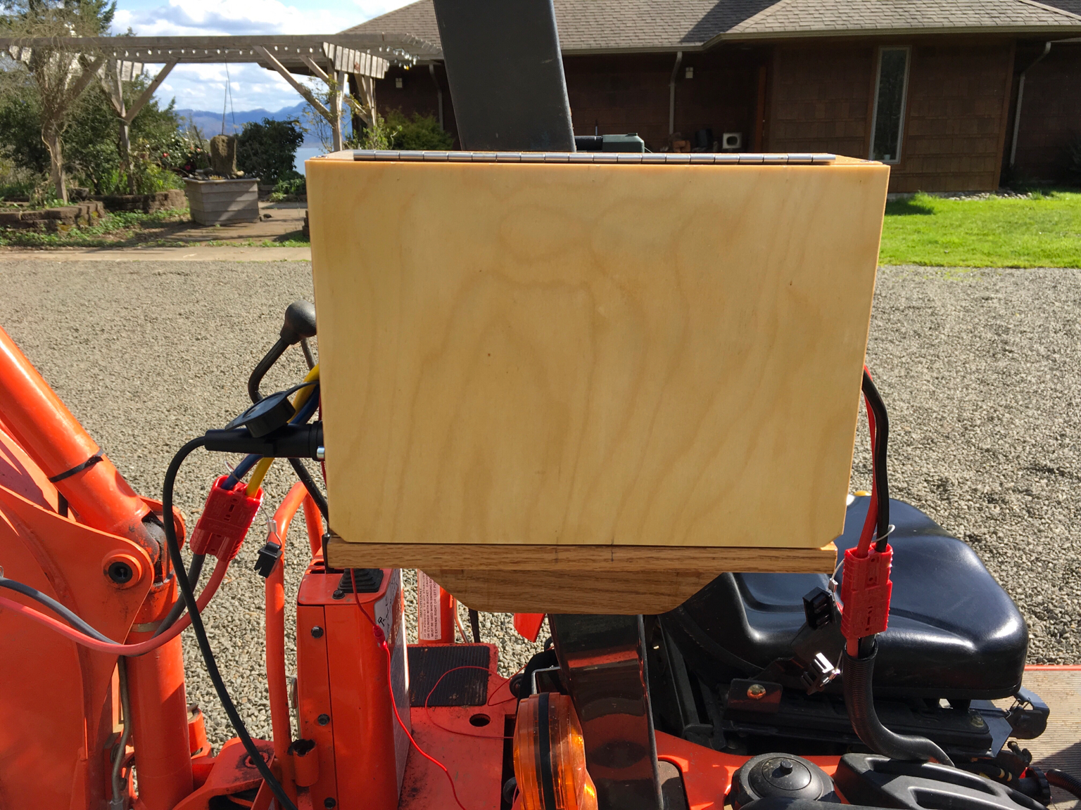

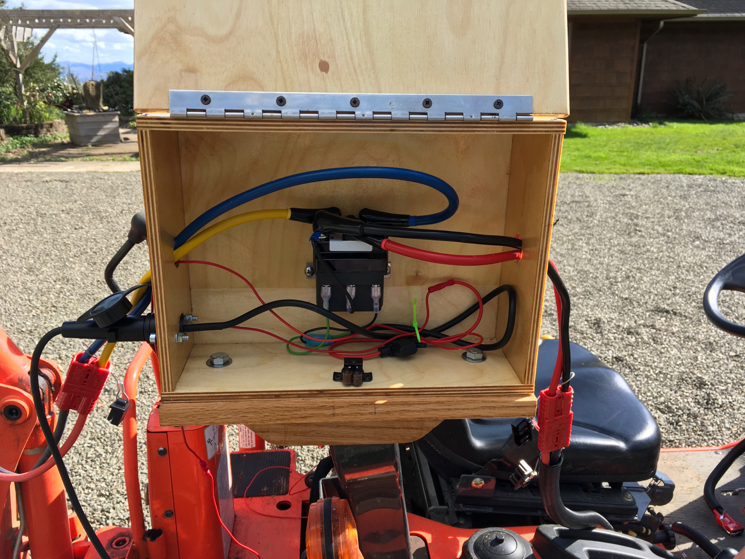

I built a wooden box for the solenoid and connections which mounts to the ROP. This comes off with 2 bolts. I will use the winch during the time of year I cut firewood. After that the bucket goes back. I used more connectors than I needed but I want the system to break down to small parts for storage.
Our property is very steep and I need to get trees up to the road to process them for firewood. Decades ago I just cut trees into pieces and humped them up to the road. I have been backing the tractor up and pulling logs with hooks on the FEL bucket. This got too exciting when I would raise the bucket up to get a better angle.
Winch $179
Adapter for 2" receiver $75
Bxpanded 2" receiver replacing bucket $129
6 ga wire and miscellaneous connectors and crimper $45
I would rather have a Wallenstein FX35, but these cost $3000+.

Just be careful if something gets hung up - that could put some odd forces on the a hoe that small.

Thanks, I planned to keep both locking pins in place and set the tractor aimed right at the load. I cut the trunks into pieces. When I actually try it I will report back. This may be a bad idea.

I can see where the winch can create 5X or more the pull force that the tractor tires can create.
Keep the winch VERY low to the ground and no side pull.
That winch could easily tip over the tractor,,, even with the stabilizers down.

i have a bx24 and i am thinking this is a novel idea - but the angle of pulling forces is just going to rotate the tractor on the rear tires making the front end go up in air until the front tires is on the same plane as the wire pulling it. like everyone is saying - keep the boom down low, and keep weight in the FEL and possibly tie down the front
