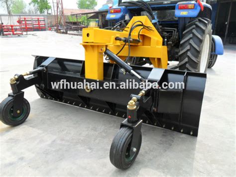

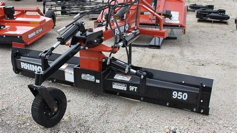

Put a tail wheel on your rear blade.
Bruce
