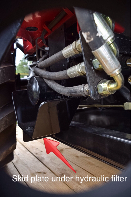

Mine is being dropped off tomorrow morning at the welder/fabricator to have skid plates mounted. Twice was enough, especially when I was overly cautious after the first time.
Shoot us some pics when you get it back if you can. I'd like to see how they do it and it might help someone who is building their own.

I have a Mahindra 4510. I have a skid plate underneath. Helpful but a mess when changing engine oil. The other issue for me is the fuel filter package. It has been damaged three times by saplings hitting the same and causing damage. My neighbor has a smaller Mahindra and his filter is higher and behind the tractor. A better position IMO.

I just dropped it off at fabricator this afternoon. Will be done by Monday of next week. Looks like a complete skid plate with removable tabs to take it on and off easily will be the route he takes attached to the two main frame rails underneath. He is also going to make it extend around the plastic fuel tank. He will also be making some covers for the front tie rods which are in front of the axle. This should take care of any issues I might have with stumps, trees, limbs, ect from knocking any filters or hoses off again. I will post picks when complete.

I intend to fab up a skid plate for my 3550 - there are a couple things that I have bent under there from errant saplings, but nothing that's cost me money yet. I have a piece of 1/8" laying around, I think that will be sufficient for the time being. If I was buying the material I'd go a little heavier.

Skid plate was the first thing I made after one trip in the woods. All I did was bend the brake rod when I backed over what I thought was a dead sapling, one look under the tractor was enough to scare me, hoses, piping, and a filter. Next I made a fuel filter guard, that was just waiting for a branch to hit it.
One look under my tractor and I could see it now, hydraulic filter knocked off, hoses tangled around branches, piping bent and the fuel filter busted, stuck in a mud hole mile down the woods, that would be a bad day.

Well, it took about 5 days and cost a few bucks, but man did they do a great job. It looks like it was installed at the factory. Now I can get into some thick forest and not worry about busting off a hose or filter.
