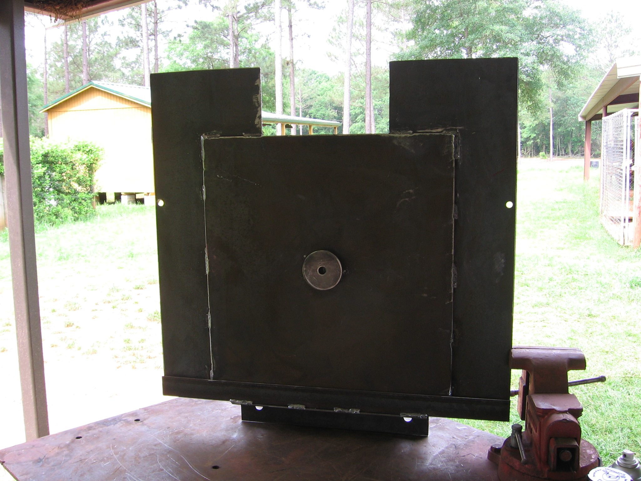

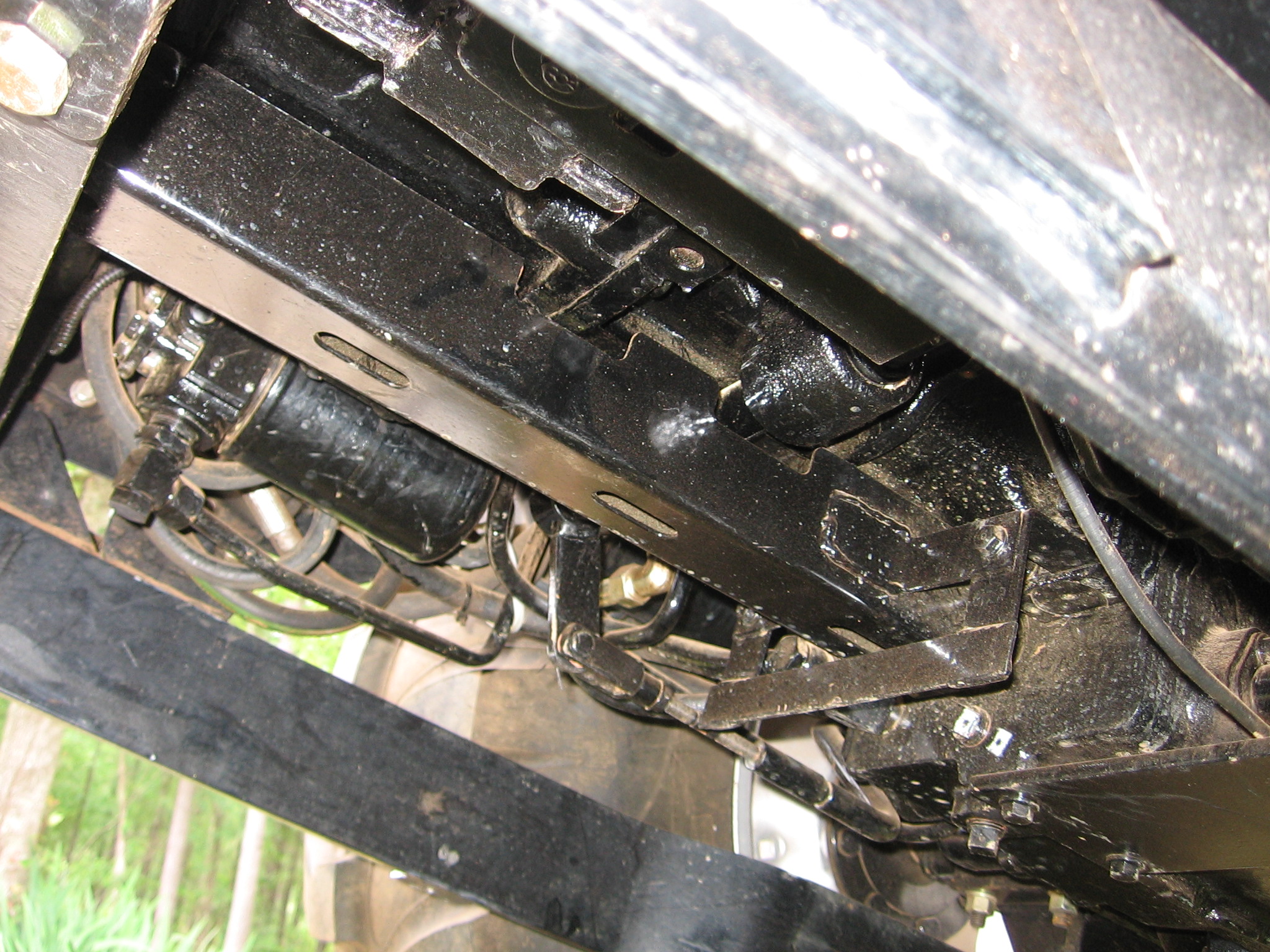

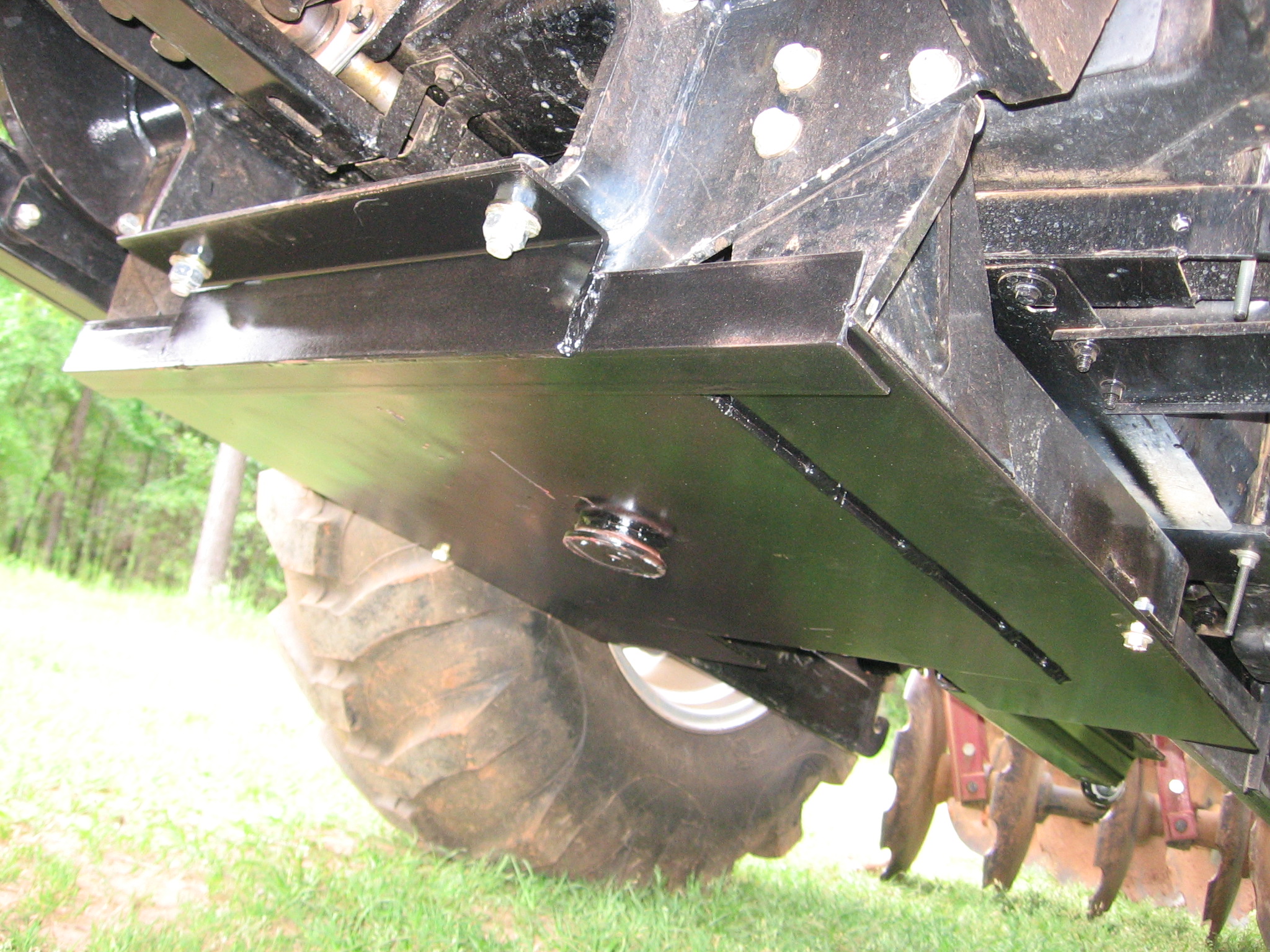

With 85 hrs on my 3540HST and having some close calls with what your talking about I figured it was time to build a skid plate before my luck run out.No 2 pic shows without skid and next with it installed.

When I was shopping tractors I noticed they all had soft underbellys. When I picked up the LS4155HC I built this skid plate for a little up armor. Its 1/4" steel.
The skid plate pretty much covers all the fragile stuff underneath.
Several hours of brush hogging saplings and thorn trees with zero damage.
